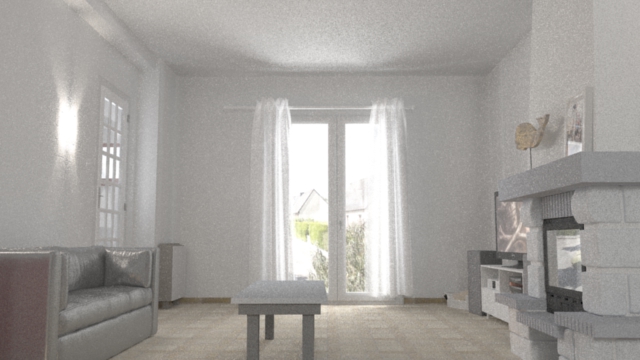

I am working on texture for curtains and for wall lights,
These are not transparent but translucent... (correct me if i am wrong..)
But with kray rendering it takes hours to compute on my scene. Anyone has a other way to do this?

I suspect you use Node Translucency. Not supported in Kray (slow or errors).
If not, simple post here surface.

No i dont use the translucency node, but i upload my srf.

Re: Translucency
Actually I use no Nodes for translucency.
I think I noticed this slow render by Nodes and I started use normal LW system...after that I forgot about it :oops:
I send you test scene with normal setup and Node (just disable Node to check speed render).
So if you want use translucency better is to use standard translucency setting.
curtain_test.7z
(1.06 MiB) Downloaded 1699 times

Thanks Janusz, there is a big difference between the 2 renders.
For my part translucy takes age to compute ( as there is a window glass behind,or maybe my mesh in quads isn't optimised).
Maybe i'll try to have a go on a other way round.

Probably you use Final Gathering - forget!
Use QMC system with these minimum settings:
curtain_test_QMC.7z
(1.06 MiB) Downloaded 1703 times

you are right i wasn't using good render settings.
With your settings, the renders are done with acceptable time, thanks.
I'll post a wip render to get critics and comments.
