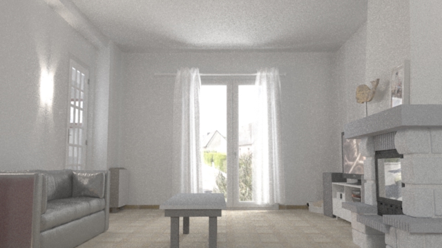

I am working on texture for curtains and for wall lights,
These are not transparent but translucent... (correct me if i am wrong..)
But with kray rendering it takes hours to compute on my scene. Anyone has a other way to do this?
Thanks

Thanks Janusz, there is a big difference between the 2 renders.
For my part translucy takes age to compute ( as there is a window glass behind,or maybe my mesh in quads isn't optimised).
Maybe i'll try to have a go on a other way round.

Use QMC system with these minimum settings:
Re: Translucency
you are right i wasn't using good render settings.
With your settings, the renders are done with acceptable time, thanks.
I'll post a wip render to get critics and comments.
