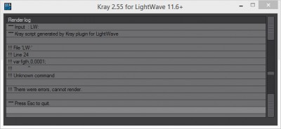

Hi,
I have a problem about kray 2,55 on Lw 11.6.1
Render problem

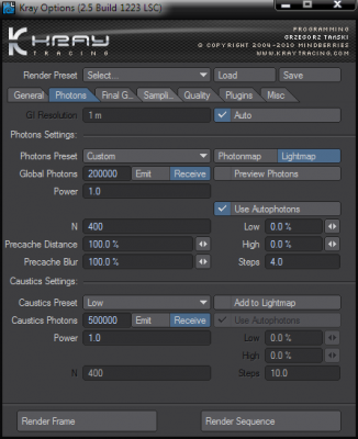

please post Kray.cfg file, maybe you put something wrong in Kray settings.
Re: Render problem
hi Janusz,
this is default setup.
- kray_settings.KGcfg
- (1.05 KiB) Downloaded 260 times
Re: Render problem
I think Precache Distance parameter is ZERO, why engine can not continue. This option can not be with value zero.
Switch to Photon Preset: custom and change it to 100%.
Re: Render problem
4 times fresh install Lw and kray. When I take first render it doesn't work error again.
maybe something wrong on hardware.
Re: Render problem
If error comes still the problem is with configuration files from LW (after uninstall LW config files still are on hard disk)erkerk wrote:4 times fresh install Lw and kray. When I take first render it doesn't work error again.maybe something wrong on hardware.
I think solution is only to restart lw config files by delete them:
http://simplylightwave.com/forum/showthread.php?t=1167
+ you can delete:
C:\Users\your_admin_name\.NewTek\LightWave\LWEXT11-64.CFG
but after you must install all plugins again.
I do not think so is something wrong with hardware.
Re: Render problem
thnx janusz,
yes, I was delete everything. I'll fresh install and try again.
