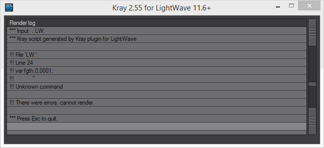

Hi,
I have a problem about kray 2,55 on Lw 11.6.1
							Render problem

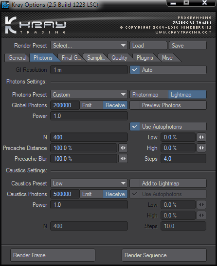

Re: Render problem
I think Precache Distance  parameter is ZERO, why engine can not continue. This option can not be with value zero.
Switch to Photon Preset: custom and change it to 100%.
Re: Render problem
4 times fresh install Lw and kray. When I take first render it doesn't work error again.   maybe something wrong on hardware.
  maybe something wrong on hardware.- Janusz Biela
