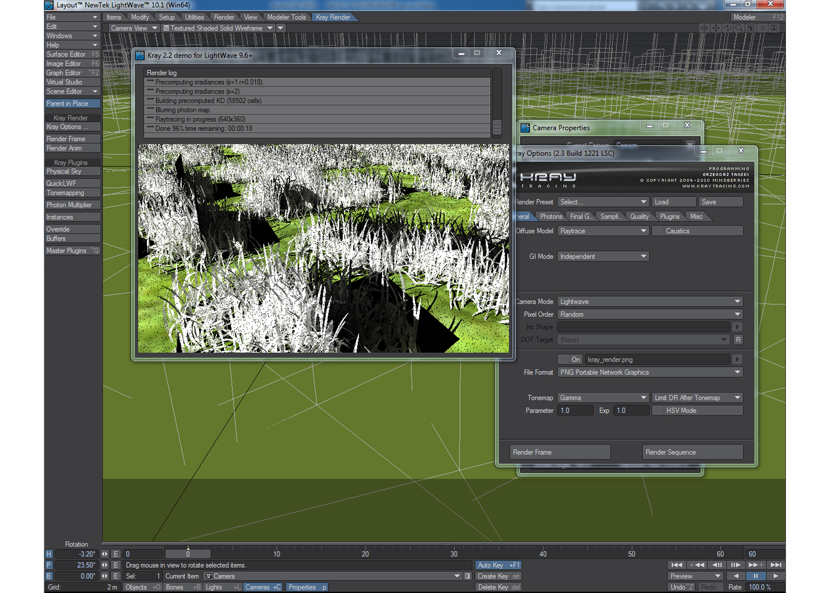

Here is the scene, why my grass is white? i put texture but it render white
15-03.lws
(1012.5 KiB) Downloaded 528 times
Re: Instance help
Alek6 wrote:Here is the scene, why my grass is white? i put texture but it render white
lws does not help becouse is no surfaces.
Please select WORLD COORDINATES in color texture editor also USE COLOR in instace setup.
Re: Instance help
Please post full scene. Unseen by camera affects only object visibilty, the object will still cast shadows and be seen in reflections and refractions.

Re: Instance help
Alek6 wrote:Okay! i just folow instructions of Basic Kray Instancing
Ok, like i suspected you have an object there set to "unseen by camera". So your render looks correct with your settings. As I said previously "unseen by camera" will only make object unseen by camera, but it will still cast shadows and be seen in reflections/refractions.
Alsowhy are you using nulls to place your instances? This is just slow to work with. Please check how this scene hereis setup. You should use points and Kray instances plugin fro your instancing.

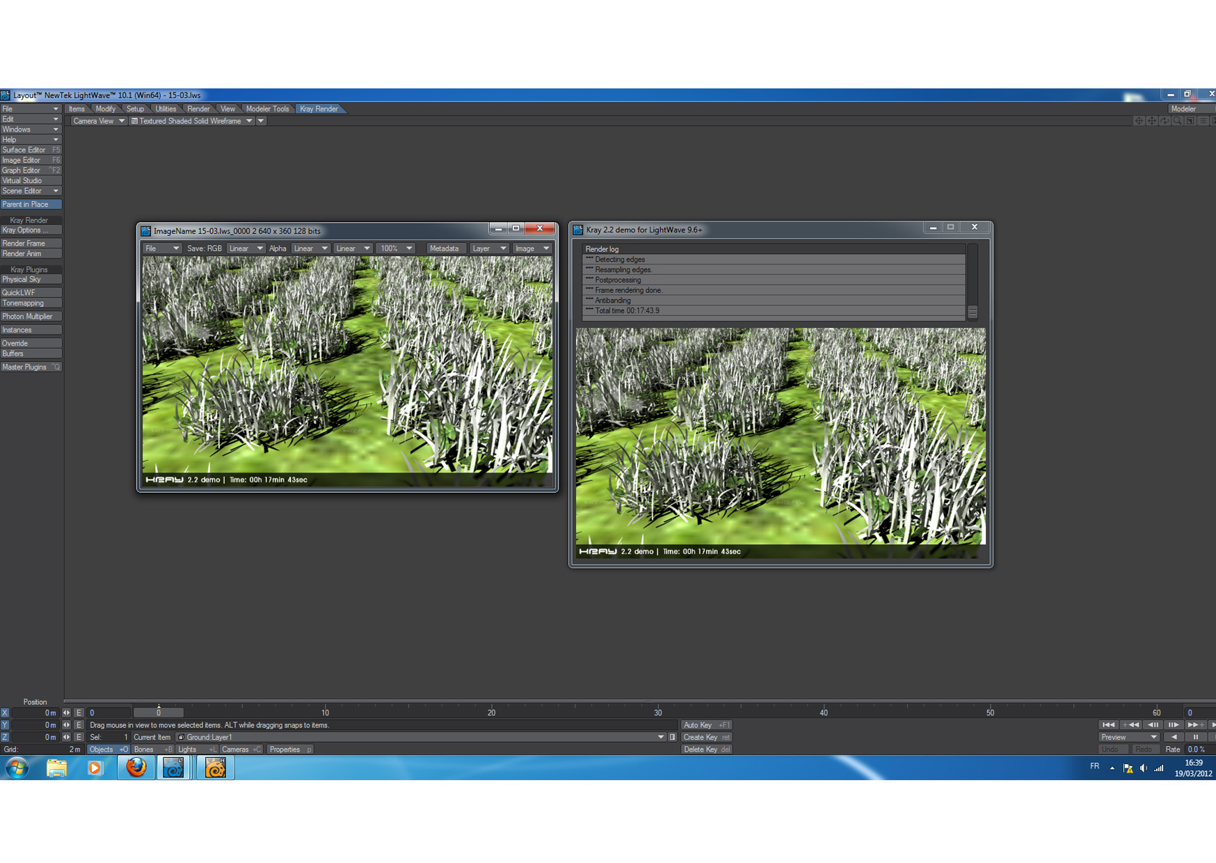

Post by Alek6 »
Ok, thanks. i make it with points, it seems great. But my grass is already white
Grass2.rar
(791.75 KiB) Downloaded 391 times
Re: Instance help
here is Your grass. Follow this idea, please. That`s the most easiest way for create grass in Kray until when we will receive working instance from LW11.

Post by Alek6 »
Thanks Janusz!!! It works very well!
But i don't understand how the grass comes green because in surface editor it's grey/white
