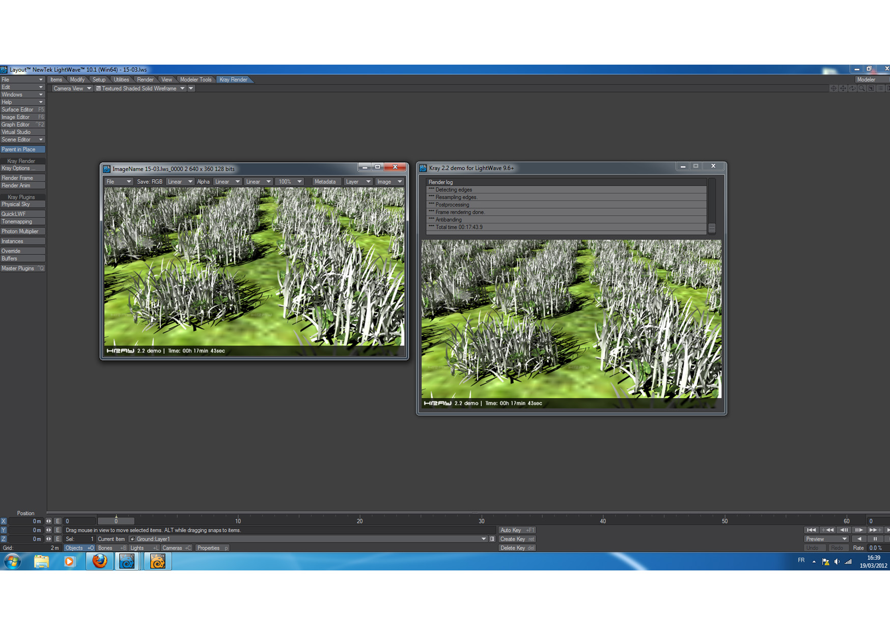

Here is the scene, why my grass is white? i put texture but it render white
- 15-03.lws
- (1012.5 KiB) Downloaded 562 times
Re: Instance help
Alek6 wrote:Here is the scene, why my grass is white? i put texture but it render white
lws does not help becouse is no surfaces.
Please select WORLD COORDINATES in color texture editor also USE COLOR in instace setup.
Re: Instance help
Please post full scene. Unseen by camera affects only object visibilty, the object will still cast shadows and be seen in reflections and refractions.Alek6 wrote:Here is the scene, why my grass is white? i put texture but it render white
Re: Instance help
It's full scene, it's just an instance test.
Re: Instance help
I need also objects.Alek6 wrote:It's full scene, it's just an instance test.
Re: Instance help
Here is the object, take from scene of Kray depo.
- Grass-small.lwo
- (794.51 KiB) Downloaded 479 times
Re: Instance help
I'm sorry Alek but I cannot reproduce your problem with what you posted. You will need to use "pack scene" and sen me all the files (except textures). I'm really not sure what you are doing with all those nulls in the scene.Alek6 wrote:Here is the object, take from scene of Kray depo.
Re: Instance help
Okay! i just folow instructions of Basic Kray Instancing
- Grass.rar
- (309.44 KiB) Downloaded 447 times
Re: Instance help
Ok, like i suspected you have an object there set to "unseen by camera". So your render looks correct with your settings. As I said previously "unseen by camera" will only make object unseen by camera, but it will still cast shadows and be seen in reflections/refractions.Alek6 wrote:Okay! i just folow instructions of Basic Kray Instancing
Alsowhy are you using nulls to place your instances? This is just slow to work with. Please check how this scene hereis setup. You should use points and Kray instances plugin fro your instancing.
Re: Instance help
Ok, thanks. i make it with points, it seems great. But my grass is already white
- Grass2.rar
- (791.75 KiB) Downloaded 426 times
Re: Instance help
here is Your grass. Follow this idea, please. That`s the most easiest way for create grass in Kray until when we will receive working instance from LW11.
- Grass2.rar
- (5.7 MiB) Downloaded 517 times
Re: Instance help
Thanks Janusz!!! It works very well!
But i don't understand how the grass comes green because in surface editor it's grey/white
