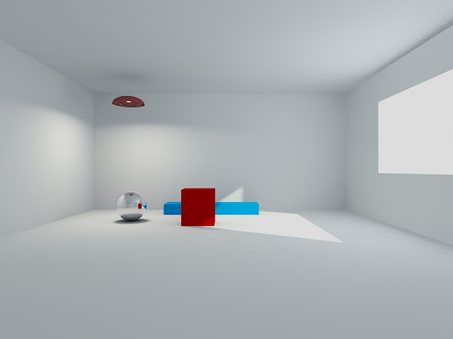

What about when you're trying to portray light from an over head lamp (see example)? Would you use a spot light then, like one would usually do setting up the lighting, or is Kray different?
Larry_g1s wrote:What about when you're trying to portray light from an over head lamp (see example)? Would you use a spot light then, like one would usually do setting up the lighting, or is Kray different?
For small lamps maybe try use spot light.
Try this scene (skyportal in window)
test.rar
(9.97 KiB) Downloaded 440 times

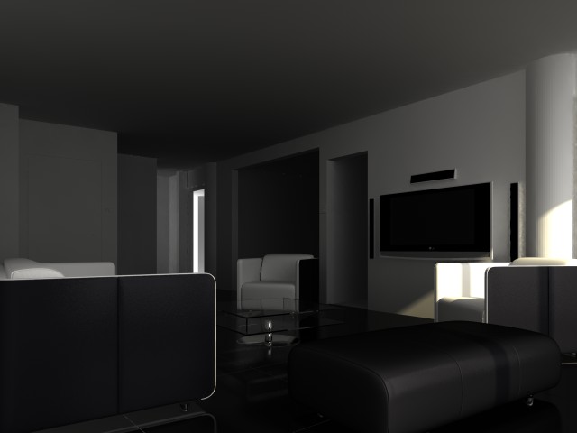

After reading the Wiki, I found some answer but I still need help.
I did a copy of your "setup", the only difference is I have a gamma value of 1.
I did a skypportal
As you can see, my picture is dark - very dark.
How can I setup my scene to get a light like this picture (do I have to fake light ? )
note: when I use gamma (high value) , I loose all the diffuse.

my picture:
I no see light from skyportals....
Maybe You make wrong setup (no fill light) just sun light.....
Please check skyportals in windows:
1/ All skyportals panel in hole windows must have direction for OUTSIDE room.
2/ must have : first shader kraysurface opt. invisible, second shader LIGHTPORTAL for Gi.
Maybe lumi sphere have few luminescence?

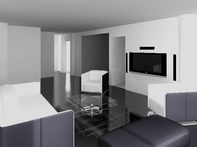

Post by mk »
I am starting to get better lightning.
I use a stronger illu for environnement sphere.
I don't use "cache irradiance" now, that give me better "pure white" surface.
I think I need to change the surface of the floor (black is not the best choise to reflect the GI inside the room.)
Cache irradiance make the render a bit "dirty" due to the blur process.
thanks for your help
Try exponential 2.0 , 10 bounce light . When render is too dark - please add 1.5 or 2 Multiplier in Kray.
And ofcoarse sunsky turbity 6-7 on lumi sphere.

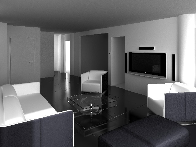

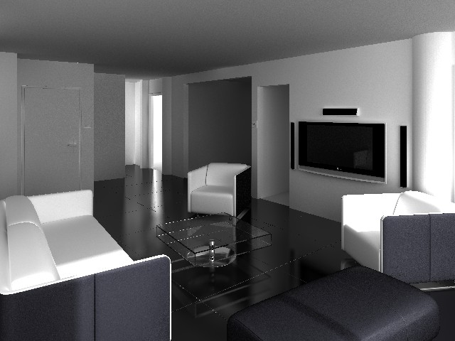

Post by mk »
very interesting ( Exponential 2.0 + multiplier 2.0) are very good for dark scene.
here is what I got only by changing those 2 parameters
about bounce light : are you talking about "recurse 10;" command ?
sorry, I dont understand "sunsky turbity 6-7". What do you want me to do ?
