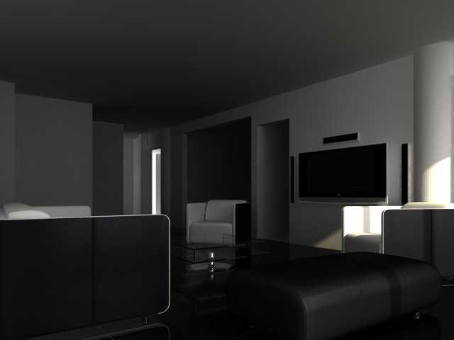

I did a copy of your "setup", the only difference is I have a gamma value of 1.
I did a skypportal
As you can see, my picture is dark - very dark.
How can I setup my scene to get a light like this picture (do I have to fake light ? )
note: when I use gamma (high value) , I loose all the diffuse.

my picture:
I did a skypportal

I no see light from skyportals....
Maybe You make wrong setup (no fill light) just sun light.....
Please check skyportals in windows:
1/ All skyportals panel in hole windows must have direction for OUTSIDE room.
2/ must have : first shader kraysurface opt. invisible, second shader LIGHTPORTAL for Gi.
Maybe lumi sphere have few luminescence?
Check again this scene: http://www.kraytracing.com/forum/download.php?id=1848mk wrote:Can I send you my scene to "debug" it ?
I don't see what's wrong.

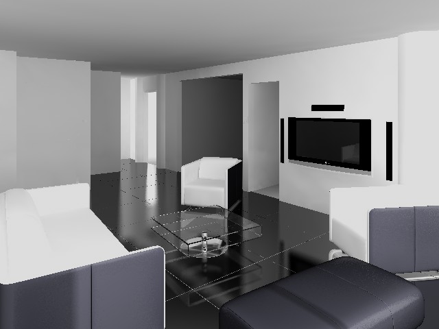

I got more light , by using higher value for the sphere around my scene (selfillum from 300% to 1000%)
I got more light in the room, but I see no effect from the skyportal.
what use skyportals and lumi sphere.
I am starting to get better lightning.
I use a stronger illu for environnement sphere.
I don't use "cache irradiance" now, that give me better "pure white" surface.
I think I need to change the surface of the floor (black is not the best choise to reflect the GI inside the room.)
Cache irradiance make the render a bit "dirty" due to the blur process.
thanks for your help
very interesting ( Exponential 2.0 + multiplier 2.0) are very good for dark scene.
here is what I got only by changing those 2 parameters
