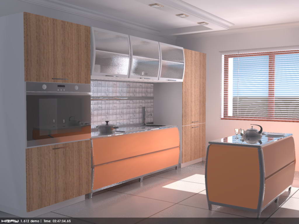

this the first work which is not very shameful to show:) the commentaries of every kind and the criticism are greeted.

Thanx for your contribution! I suggest you turn up blurred reflectionsamples much more to get rid of that dotty effect.

with the pleasure it would lay out entire scene for the testing, but there the names of objects the Russians:)

Also as try this as antialiasing on a limited region for a start:
adaptive Grid aa 1x
change upsample to 1 (standard is 0) and this is important.
no undersampling. (otherwise you cant choose upsampling)
If you still get broken lines or geometry missing then change AA "Thickness" size from 1 to 2 or 3 pixels.
Tolerance 0.1 (like in lw) or smaller like 0.06
I have newly started to use this mode and this AA mode gives me same or better AA than Lightwaves standard adaptive Low, but is very fast.
