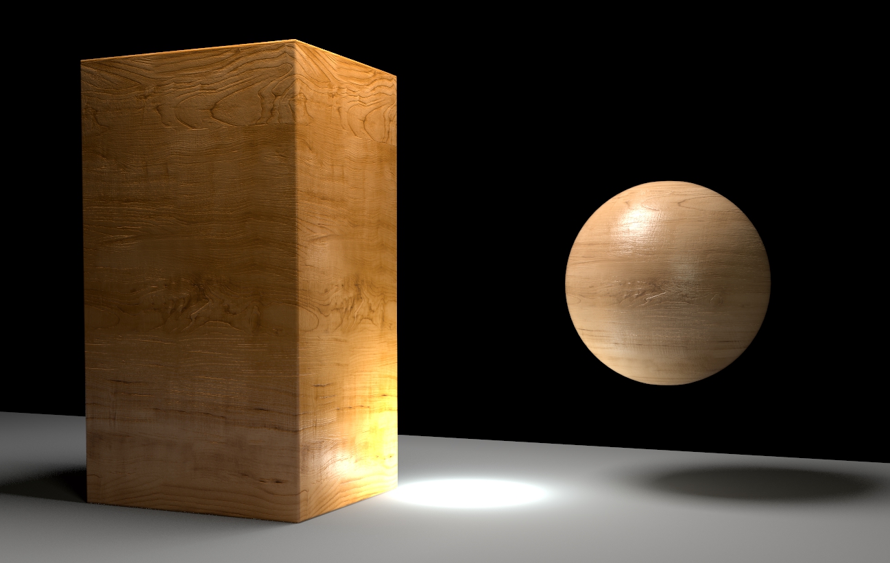

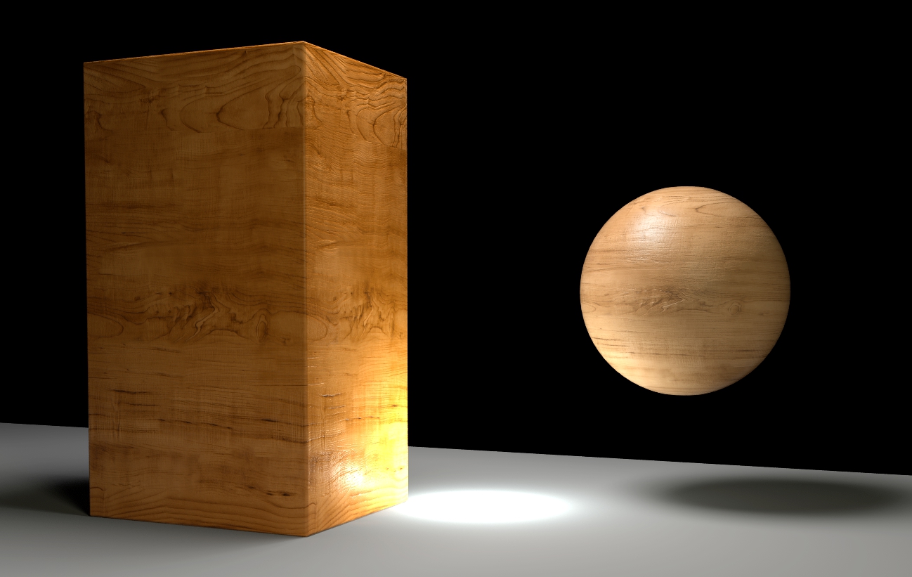

A small rendertest:
Lightwave native: (6minutes render, AA at 30passes)
Kray: (12minutes render, medium quality)
Except for the size of the lights, they look the same. I need to investigate why kray render is longer... maybe because of some shading models.
Heres the scene and everything to check for yourselves. I used an area light and a spherical light:
shading.rar
(389.36 KiB) Downloaded 11807 times
Grtz

Fabian-Eshloraque wrote:A small rendertest:
Hi Fabian,
I'm looking at your scene, I have some observations.
I don't know if this settings are fair for comparison between lw and kray, the scene has to be optimized: in lw engine for example I can easily cut rendertimes by 80% and more, even using montecarlo and not final gather, preserving 100% quality. So probably is the same for kray, but I'm not the expert in kray world.
About the shaders, I see a strange behaviour when change from standard to oren-nayar: oren-nayar is a diffuse model, so it shouldn't change the specular lobe like it does.
When I have time I'll look at the shader, but reversing the other's work is always a bit complicated.
One more question, just out of curiosity, is there a reason you choose rec709 cs over srgb?
edit: I've noticed also the lights are incorrect, they'd be inv. distance sqr.

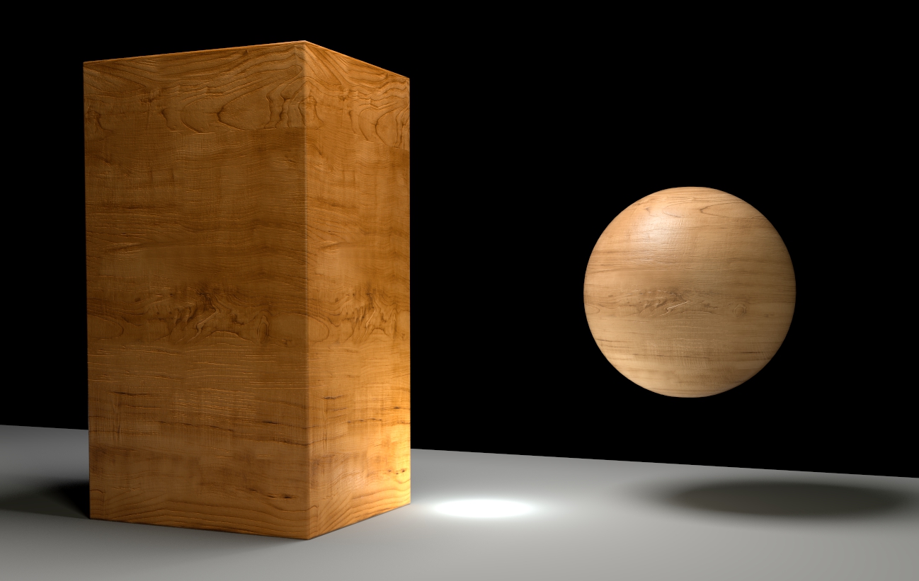

Ok I've done a really fast test here using my shaders and just some optimization of the scene. It's a bit conservative on some settings, but I just wanted to cut the rendertime.
I don't know why you get bright pixels and banding, as you can see the scene comes out pretty clean (remember, I'm talking lw native) with a very low aa,
It takes 51 seconds on my 4 years old 4.3ghz 6c/12t workstation, my other render machine can probably do it in less than 15 secs.
To my eyes t's much similar to your kray render than the lw one. It has a better AA than kray, but it loses some small details (but differences can came also from the engine, the shaders settings etc). It also catches the other side/front light, as you can see in the wood sphere, which is more correct in my opinion. Anyway I need time to test more, I'll try later. Maybe Janusz can do some optimization for kray, but I'm thinking that probably we need a much complex scene to see the difference, and if the shaders are correct.
For srgb vs rec709 I was asking because I prefer the washed out look of the srgb because it gives me more control over tone mapping, but I do 90% stills.
edit: typos and grammar
