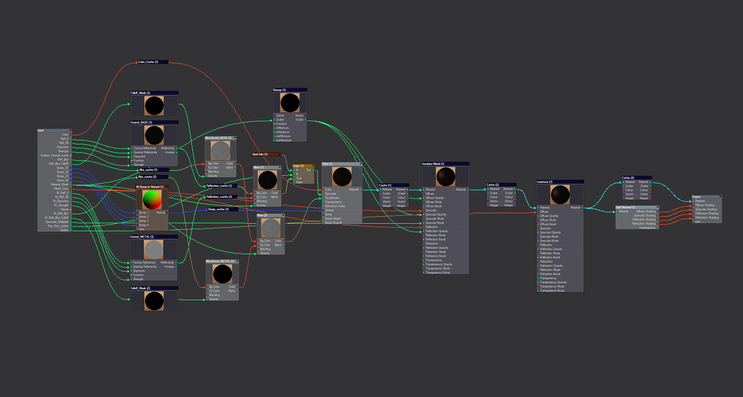

Hi Kray Guys,
Like I promised here's our default shader. Its been tested in animation with lightwave and kray. But it could still have noise issue's - let me know if you find a problem with it. This shader is only for non-transparant, non-opaque, non-organic materials. Those shaders are driven by transparecy and translucency and are difficult to make a standard shader for. Most of the work on this shader was done by Janusz. His shaders are more advanced, maybe he will post stuff soon.
Here are the nodes:
Starter_production_Vs003.nodes
(68.38 KiB) Downloaded 2194 times
Here is the shader:
Starter_production_Vs003.srf
(66.69 KiB) Downloaded 2191 times

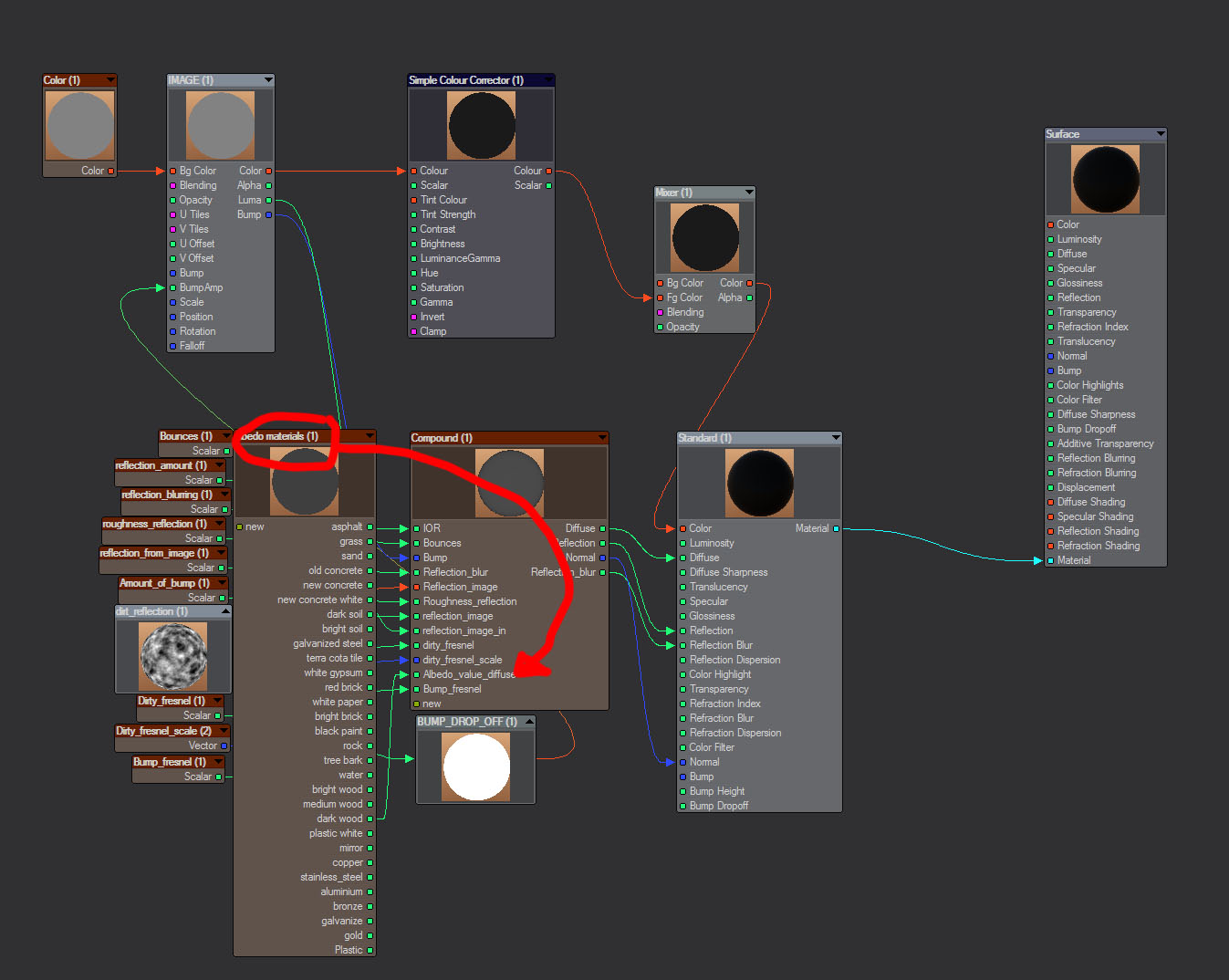

Small overview:
So to tweak: (value 1.0 = 100% thus 0.1 = 10%)
1. Choose the texture in image node. You can mix more images with the mixer node allready in place. Texture will generate normal map.
2. Bounces: default 2
3. reflection amount: or IOR (1.01 is lowest, 30 is chrome, you find values on the interweb)
4. Reflection blur: use 0.08 for 8% - 0.16 for 16% etc
5. roughness reflection: will add texture on the reflection (now I added dirt reflection procedural node)
6. Reflection from image, from Janusz - inverted image
7. dirty fresnel: adds dirt to the fresnel of reflection, makes fresnel a bit more realistic
8. dirty fresnel fresnel scale: the scale of the used procedural (1 = 1meter)
9. bump fresnel: this pipes the normals maps into the fresnel.
10. why a material? Because you can then mix with other material setups (if you have snow and rock material on the same surface object) or/and make LM shaders like those from renderman: (LM means Layered Materials)
11. Just plug the correct albedo value back into the compound:
You dont need to setup all parameters of this material, normally choose image, reflection and albedo will do 70% of the work. When using this shader you can do about 80% of the shading work within a small amount of time and it renders fast! The only downside is that you need to re-open the node editor every time. So have fun, hope you can use it!
Best,
Fabian

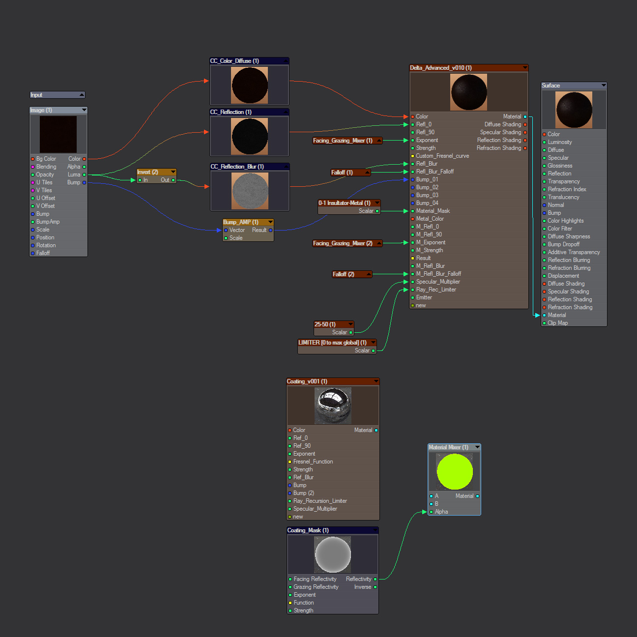

Hi guys, sorry for the delay, I was a bit busy.
Here in attach one of my standard node with a base coating. There are some missing input like bump falloff or bump mask but this are really simple to do, you can choose your best technique and add it to the node.
As you can see it seems complicated but really it's not, what I did it's just copy here and there and create something usefull for me.
I also watched many vray and other software tutorials, and I tried to translate some of the techniques to lw.
This as an attempt to create a sort layered material, which in lw is not really always desirable because as Janusz and others already said, it comes with some problems.
In this case, since this nodes are designed for the standard lw engine, the only problem I find is an increased render time when materials are mixed with masks with low contrast (I mean many greys, so the reflection is really layered and not masked out).
Otherwise the single node is really really fast and rock solid, I've never experienced a crash in vpr or F9/10 rendering, with or without extra buffers and stuff. Maybe there is some redundancy in cache but I find it ok.
I'd be really glad if someone will find a way to improve or fix this nodes if something is wrong in the behaviour of the network. I'll probably share with the lw community because they probably find more benefit there, but you never know.

I can see your problem, i.e. I find that Delta, which I use for like 90% of my materials, very convenient, because it has already oren-nayar and auto diffuse and you can use it for very very fast setup. I don't know if my node can help for kray, but you can try.
This is why even though kray is far superior than lw engine, I still use lw in my everyday works because I find it needs less workarounds to do what I need properly. Maybe it's me, maybe it's just because I need to redo my materials or just I'm so used to vpr for setting up everything, but my workflow is consolidated like this. Will see what happens with lw Next or K3, if they will ever come out this year.
Anyway, I'll look into the carpaint shader and the lastest setup from Janusz, I have so much to learn from him and others here and nt forum, but the problem is since I don't spend much time on forums lately I'm missing some important stuff for sure.
