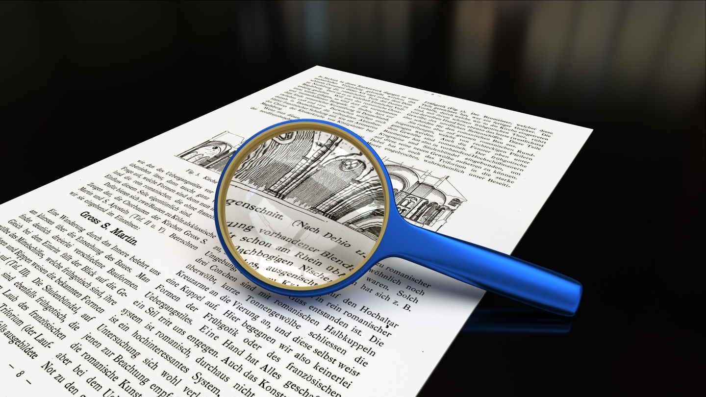

Re: magnifying glass material
Post by azman_821009 »
Here is the sample of glass effect..how can i do that?
I do not see any problem with that. :) Just glass as lens (according to physic)
If You have problem with this I can make basic scene.

Janusz Biela wrote:I do not see any problem with that. :) Just glass as lens (according to physic)
yeah..i have problem with how can i do that glass as lens material on object..really need help..
thanks.. :(
i think this is easy situation of glass effect . u just increase index reflection put it mybe 1.3 for warter try it if not put 2. good . and if u went check double sided activate .
I doubt You need whole spectrum of effects for this what You want (caustic, colour spectrum refraction). So,then use just basic model of lens, according to physic. Refraction index for glass is around 1.5 but this doesn`t means you need keep it exactly. I remind, the lens effect is depends also from convexity of glass. This can be easy control by Y direction in Layout. The effect You can see immediately under LW VPR. :)
lens.rar
(7.96 KiB) Downloaded 426 times

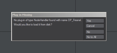

anyway i can't find where to download the DP Fresnel.
azman_821009 wrote:anyway i can't find where to download the DP Fresnel.
Keep updates from here:
http://dpont.pagesperso-orange.fr/plugi ... des_2.html
:wink:
I use complex Fresnel Node.
