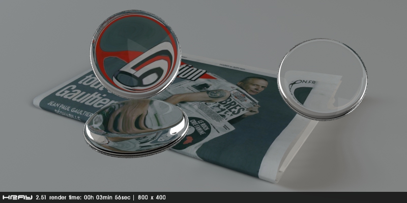

Here is the sample of glass effect..how can i do that?

Re: magnifying glass material
I do not see any problem with that.   Just glass as lens (according to physic)
If You have problem with this I can make basic scene.
  Just glass as lens (according to physic)If You have problem with this I can make basic scene.
i think this is easy situation of glass effect . u just increase index reflection put it mybe 1.3 for warter try it if not put 2. good . and if u went check double sided activate .
I doubt You need whole spectrum of effects for this what You want (caustic, colour spectrum refraction). So,then use just basic model of lens, according to physic. Refraction index for glass is around 1.5 but this doesn`t means you need keep it exactly. I remind, the lens effect is depends also from convexity of glass. This can be easy control by Y direction in Layout. The effect You can see immediately under LW VPR.
