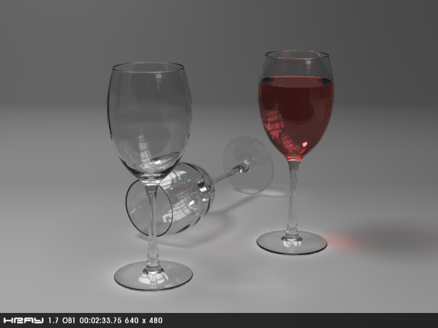

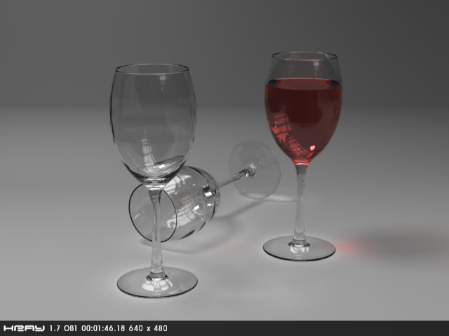

Post by silverlw »
Here is my example. i had to rebuild the scene somewhat and downscaled the environment. Large floorplanes is no god together with photonmapping since many photons will be spread across it and wasted. I have tried to optimize the scene for speed and to get similar caustics like in that Modo scene. If you can provide me with the Modoscene i would be happy.

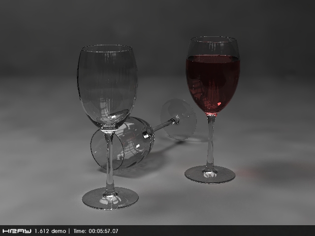

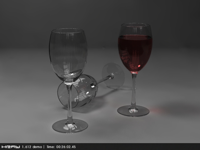

Post by ana028 »
Here is two test with the demo version of kray 1.612, in the first test I used 200 rays and 1 level of full screen AA and in the second test I used 800 rays and 3 level of AA.
