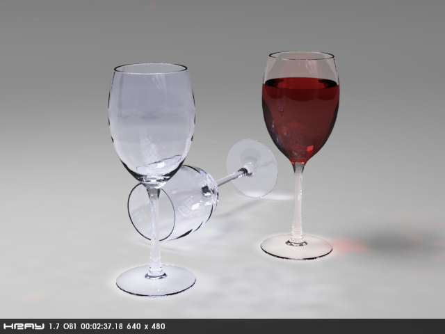

this is my glass
it walked me about this near good quality the time of renderingu it would be short
and I will admit that I placed long Kray they would reach this
my English it is not good
sorry :lol:
I greet

Hmm... Did you use photonmapping for this since they tend to be faster with transparent things? Tell us some more of your settings and on what cpu.
It's rather splotchy and it should be able to tweak it much much better.
