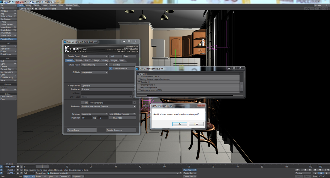

Hello, I have the same error. Here are my debug files on two different scenes.
In LW9.6.1, no problem
kraylog.txt
first scene
(2.68 KiB) Downloaded 442 times
kraylogescalier.txt
(606 Bytes) Downloaded 387 times
Thank you.
Re: not working Kray 2.4+LW10.1?
Looks like crash occurs during object imort. Coul you please send me the "reunion" and "Escalier" object?

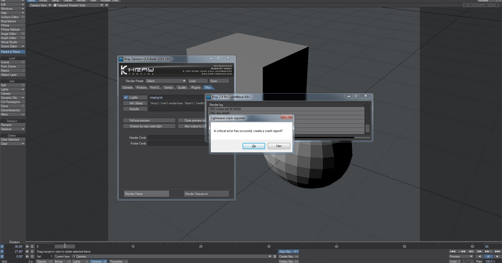

here is my another scene
kraylog.txt
(513 Bytes) Downloaded 298 times
boll.lws
(11.95 KiB) Downloaded 317 times
boll.lwo
(8.63 KiB) Downloaded 296 times
Chumarin Ruslan wrote:here is my another scene
You can send me objects to jure (at) kraytracing.com
Last scene you send has missing object www.lwo so i cannot confirm the crash.
