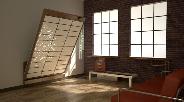

except
Posts: 89
Joined: Tue Sep 05, 2006 7:07 pm
Post by except »
posted this a month ago or so.
this scene has random white specks on most surfaces in each frame.
Posts: 453
Post by silverlw »
Except: Could you be so kind and upload the scene/data here or email me the scene so i can take a look at it what's causes it? Crapmess@bredband.net
I could count to 3-4 small dot's in the image and im curious what they are.
except
Posts: 89
Post by except »
Yeah, or one thousand :)
This is something else though, I think.
I'll email you the scene. Can't post it as it's proprietary.
Posts: 453
Post by silverlw »
Check your mail exception. Part of what i wrote so others will benefit of it:
It's your arealight reflecting in the surface.
Turn of "Area light visibility" Under quality tab and the noise should be gone. I think this is kind of a bug or more precise it's a tweak of Krays adaptive bluring that we need to change a bit to get a better result. Also switch Kray to Luminosity modell=indirect to gain a little cleaner look.

Edit: There is also a problem with the bed it'self. It's the morphtargets or it's UV map causing the bed to flicker alot.

Silverlw wrote: Edit: There is also a problem with the bed it'self. It's the morphtargets or it's UV map causing the bed to flicker alot.
Is there a fix for this coming up soon? And perhaps the dissolve envelopes?
That's a pretty big roadblock for me currently.
Posts: 453
Post by silverlw »
Do you really have to ask that? :D Ofcourse we will fix it but i cant get you a date since Grzegorz have to finish sdk for virtualrender first. Thanx for letting me peek at your scene and it showed a severe bug we wasn't aware of so this shows how dependant we are of everyones help. For now i would say Morphtargets are a no go so i would advice you to animate it with normal keyframing/scale/size/rotate to get it to work.
