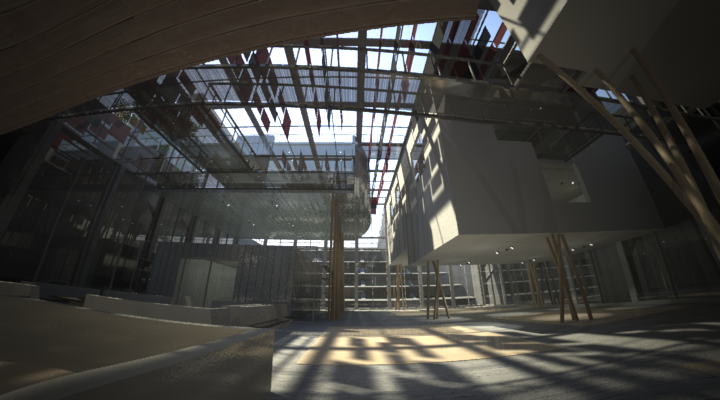

Attached image is precomputed filtered... 5 minute render time with FSAA, DOF and Motion blur. Pretty good I say :)
I cancelled the Photon mapping render after 8 minutes and it not being halfway done...

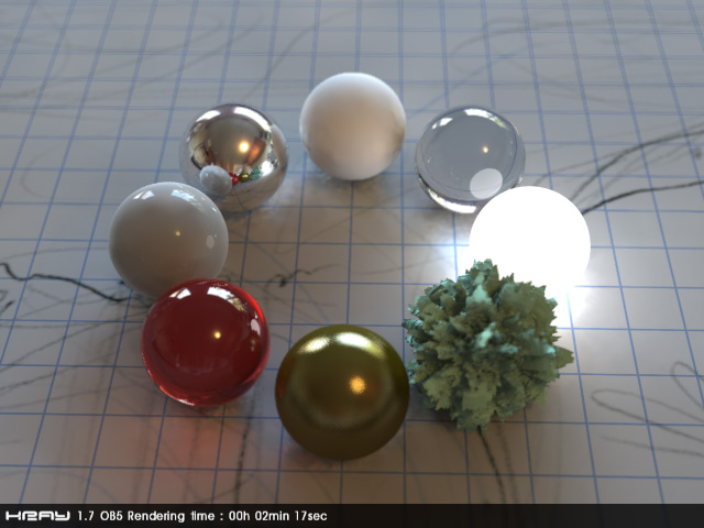

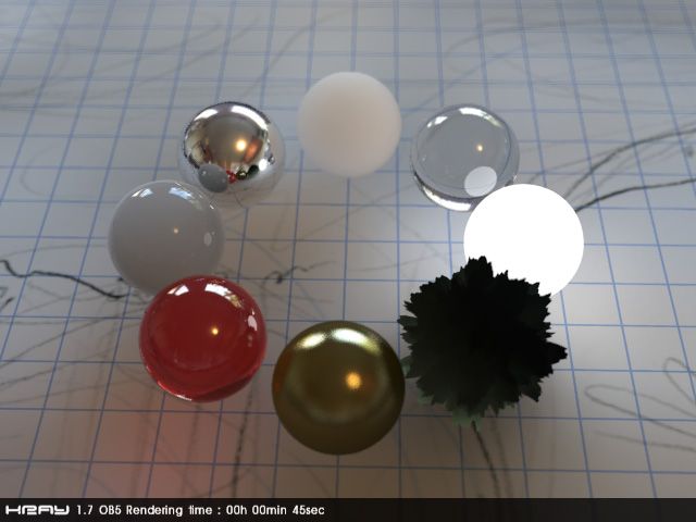

precompute does not use any FG, so basically you don't have ANY contact shadow. It looks similar to LW's own GI FG interpolated with too high MES. In your beautiful scene the attention is drawn away from correct GI, so you can get away with it, but in more brightly lit rooms the difference is too much noticable. For exteriors it is a nice way to have some occlusion, but we cannot call it true GI.
added 2 pictures to clarify, see also the weird thing going on in the displaced sphere, that surprised me. I used this HDR lit scene because the less direct light the more clear the difference in lighting (this is always the case in GI)
precompute filtered
precompute filtered
photonmapping
photonmapping
