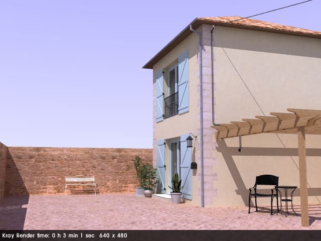

I have attached a WIP render. The chair and table need a lot more work. The scale is a too large, the chair needs a lattice back and seat, and I need to change the materials, but gradually I'm getting happier with my results. C&C appreciated.
Exterior_template_sky_00h-03m-01s m21100.png (314.86 KiB) Viewed 7857 times
