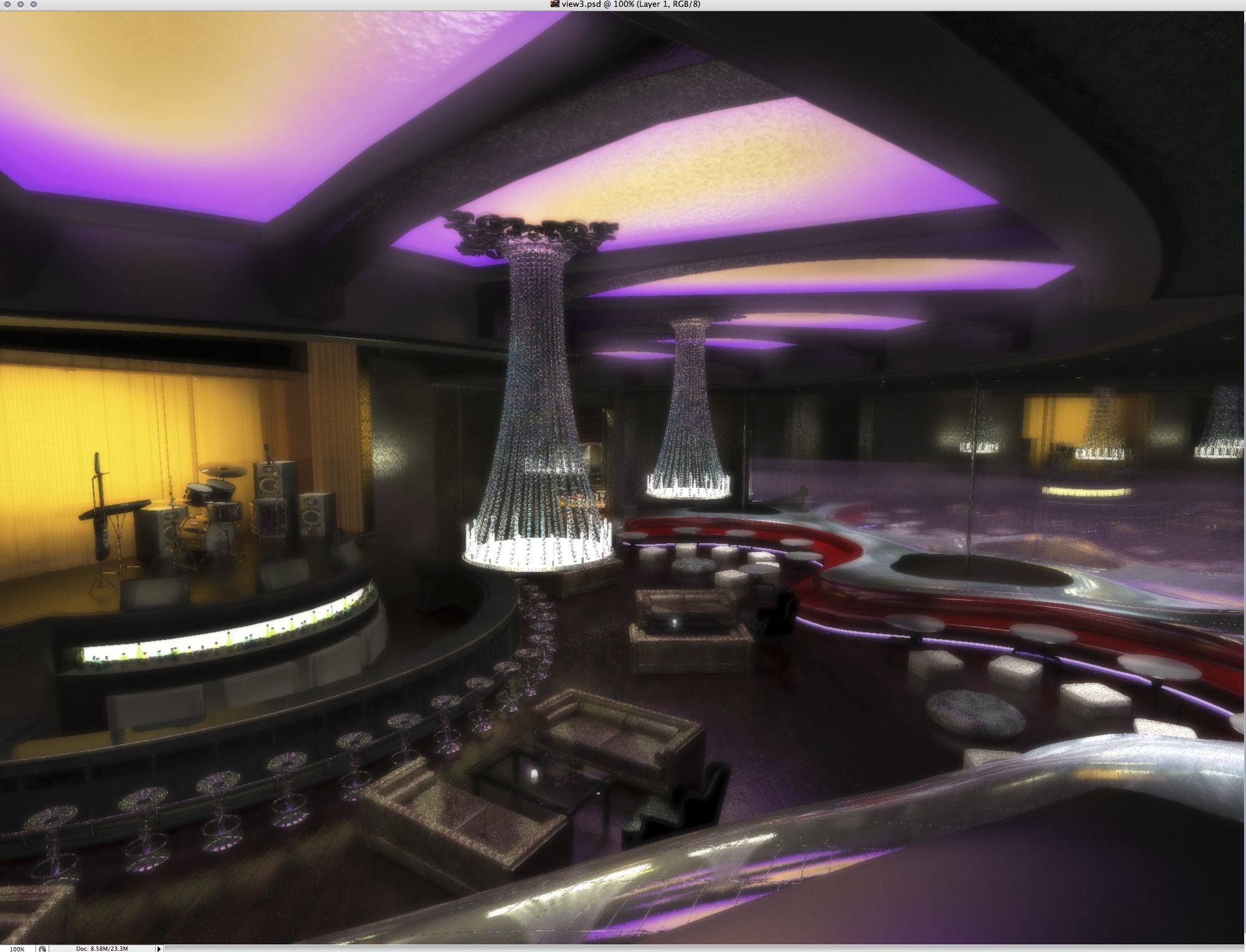

this render here took approx 8hrs to render at 2000 x 1500 resolution only 1 AA grid pass (to save time), I am not happy with the quality yet, but working on it.
I will post the Kray settings once one of the cpus is free.
I think I can remove the refraction calculation for all glass elements, and reduce the raytrace bounces from 24 to 8 maybe and still look about the same.
Any other ideas in the meantime?

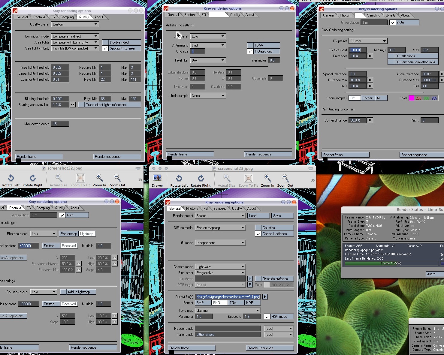

Here are the settings.. I am using Kray instances for pretty much evertyhing that can be repeated btw.
I appreciate the time to look into this !!
Matt -

I think that using higher photon and FG setting will give faster AA rendertime. FSAA might be even faster but you have to try it. And lower the bounces.
Try this:
Photons
- around 600k photons
N 3000 - 4000
FG
min. 200-400 max. 2500
prerender: 50% - 100%
lower spatial tollerance (0.1 - 0.2)
B/D 100%
Blur max. 2
AA
Grid 3 is probably needed but maybe try the QuasiRandom AA-filter
and try some higher settings for the other stuff too.
Quality
your Octree depth is very low. If Kray complains about a low octree when rendering (right at the beginning) you should raise this to 40 -100. Just watch your mem consumption since a larger octree will need more ram.
It looks like all the surfaces have very stron reflection settings. maybe tone them done too and use lower ref-blurrying (reflection blurring strength has been changed in kray to match LWs blurring).

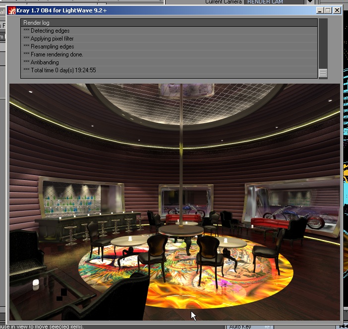

OK another example, 19hrs to render this..
I hope its just operator error.. I will keep diagnosing and fine tuning the settings
this is 2000 x 1500 on a quad, I believe this should render in at least 1/5 the time?
Matt-

19 h is too heavy. What takes the longest time? AA I guess?
You can also try following this tutorial:
http://www.kraytracing.com/forum/viewtopic.php?t=411
and adjust photons and FG as it is done there (with override material to see the GI quality).
Florian
You definitely need to increase octree if memory allows you. The higher you put it the faster the rendering will be.

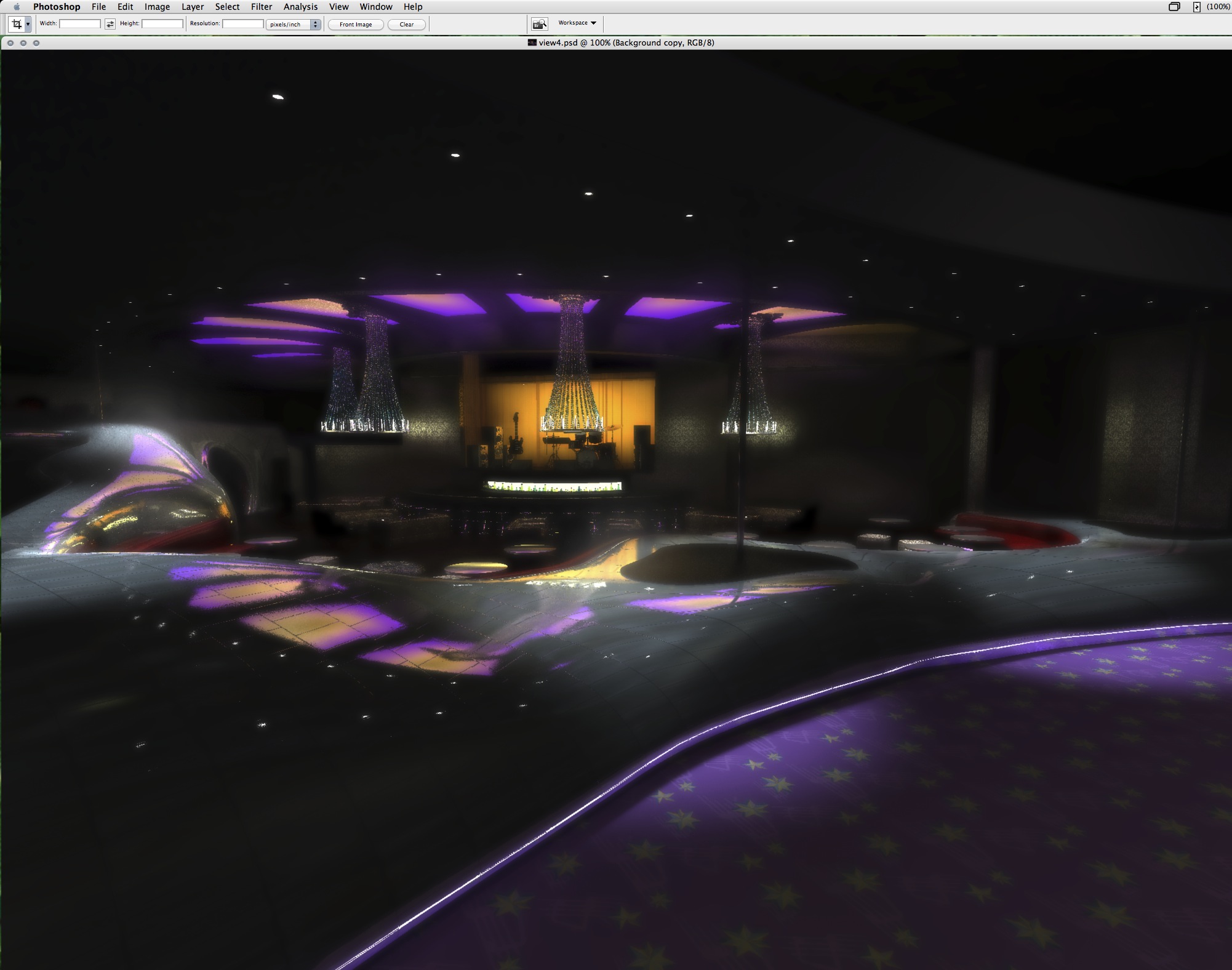

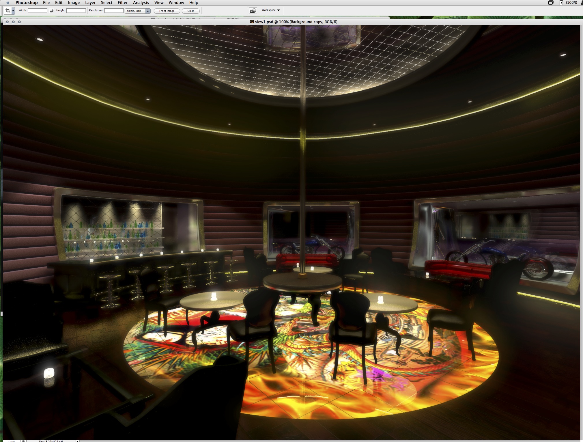

Will keep playing with the settings, here are the renders below, had to use a lot of PS blur to soften everything and hide the grid 1 antialiasing
Matt -
