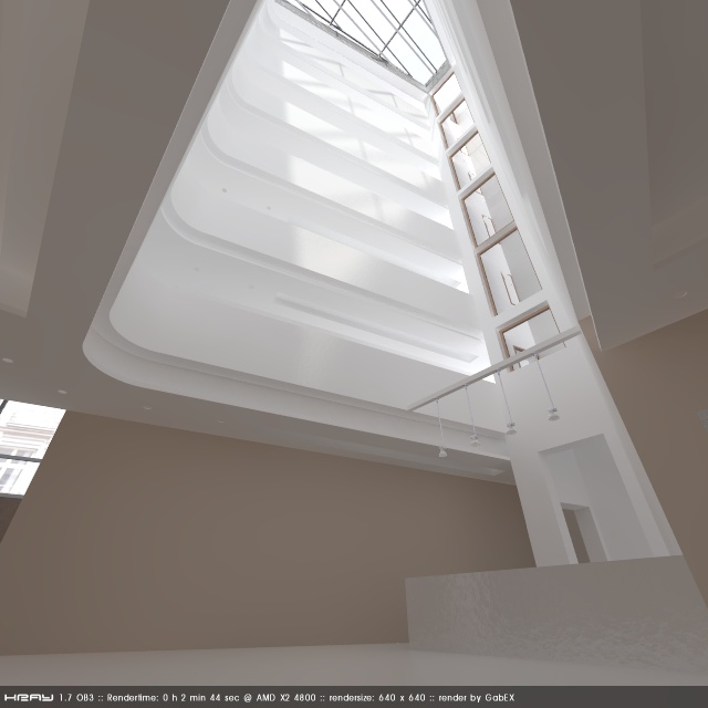

Hi!
When I change only the colors of the upper floor's backgrounk walls from white to orange, I get this. :(
Is it possible to see white surfaces in white color, instead the fully orange pic?
Basic setup, 1 150% spot, 1km inv2 distance, Skylight 2, 0, 0.2, 4
medium preset, hdri's saved as jpg
Any advices are welcome!
With white background walls
01 - white.jpg (64.27 KiB) Viewed 7947 times

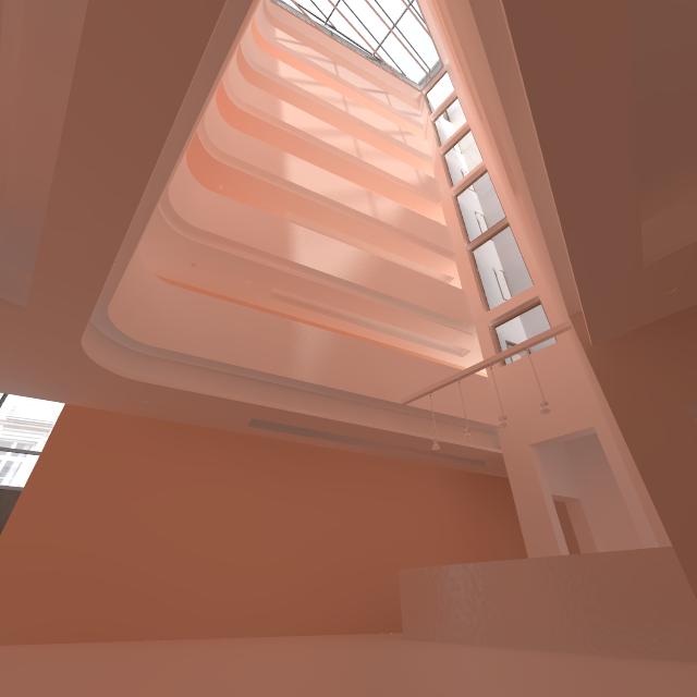

With orange background walls
02 - orange.jpg (23.44 KiB) Viewed 7946 times

If white light bounces off an orange surface, the light gets tinted orange. That's just how it works.

I undersand that the ligt color changes, but from this viewpoint almost evry surfaces's color is white. Ther's only one visible orange wall on the first floor.
In the real world, go into a fully orange walled room and you pull out your white paper from your pocket. For the eyes, it will be WHITE. On this picture I would like to see clearly recognitable WHITE ceilings, ground and ground level walls.
Is there any way in kray to
- discard color information for light bounce?
- use a constant color for bounces?
- controll the amount of light tinting?

what is diffuse value of tinted wall ?
vgabex
Posts: 98
Location: Hungary
Post by vgabex »
tiktane358 wrote:what is diffuse value of tinted wall ?
100%
You should never use 100% diffuse surfaces - this effectively means all lights gets bounced.
Even for pure white wall use below 100% - 95% or similar...

When I REALLY want a more white surface I decrease diffuse value and I increase luminosity value (50-50 for eg) and render in indirect mode .....

Luminosity?! If you want "whiter" surfaces, you just need more light. So either make the lights brighter, or tweak the exposure a bit.

Or do it in post.
