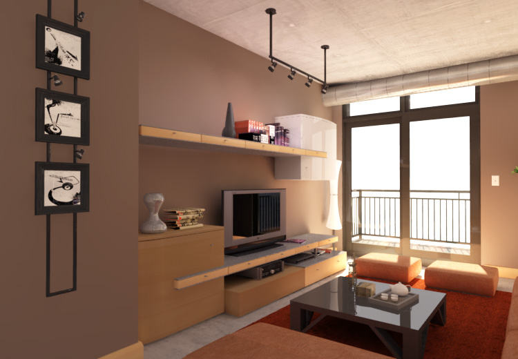

vpii
Posts: 164
Post by vpii »
It has not been easy for me getting use to Kray. Asked a few members here for help with no reply. Thanks Haven 1000 for your help. Here is a frame of what I finally came up with. Just had to do something right or wrong to move forward.
