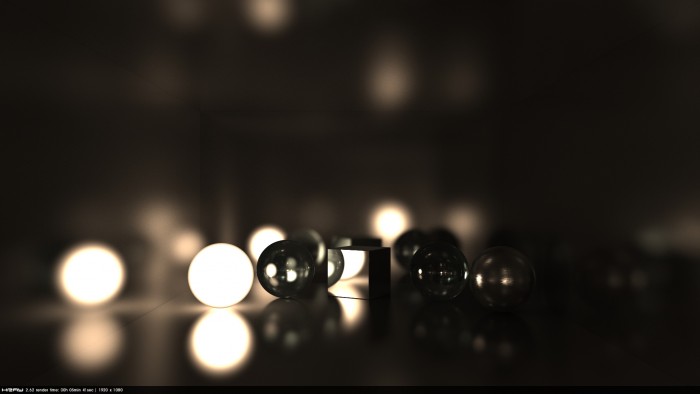

Small scene "benchmark" from Matti for stressing CPU.
I used full 40 bounce lights, QMC. You can also render this by Kray.exe.

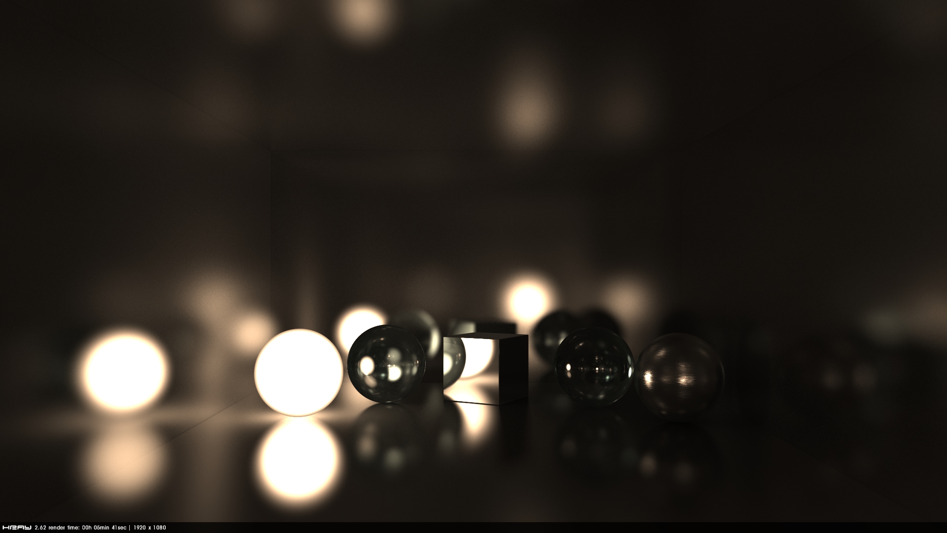

I found in more or less complex scenes that rendering time is very inconstant. The same frame is rendered in 7 minutes, after 12, the third time in 9, next in 11, then again 7 minutes.
But on such simple scenes, the rendering time is very stable.

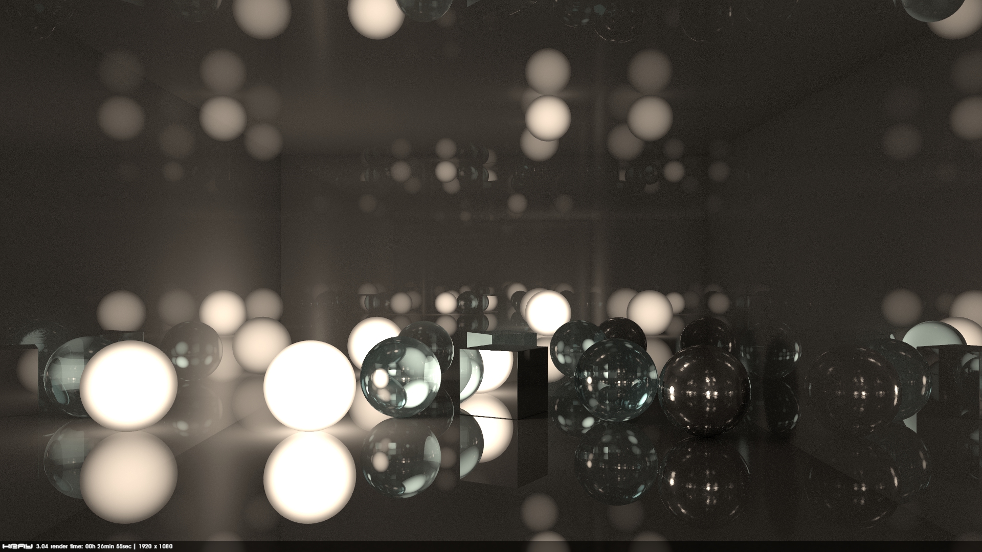

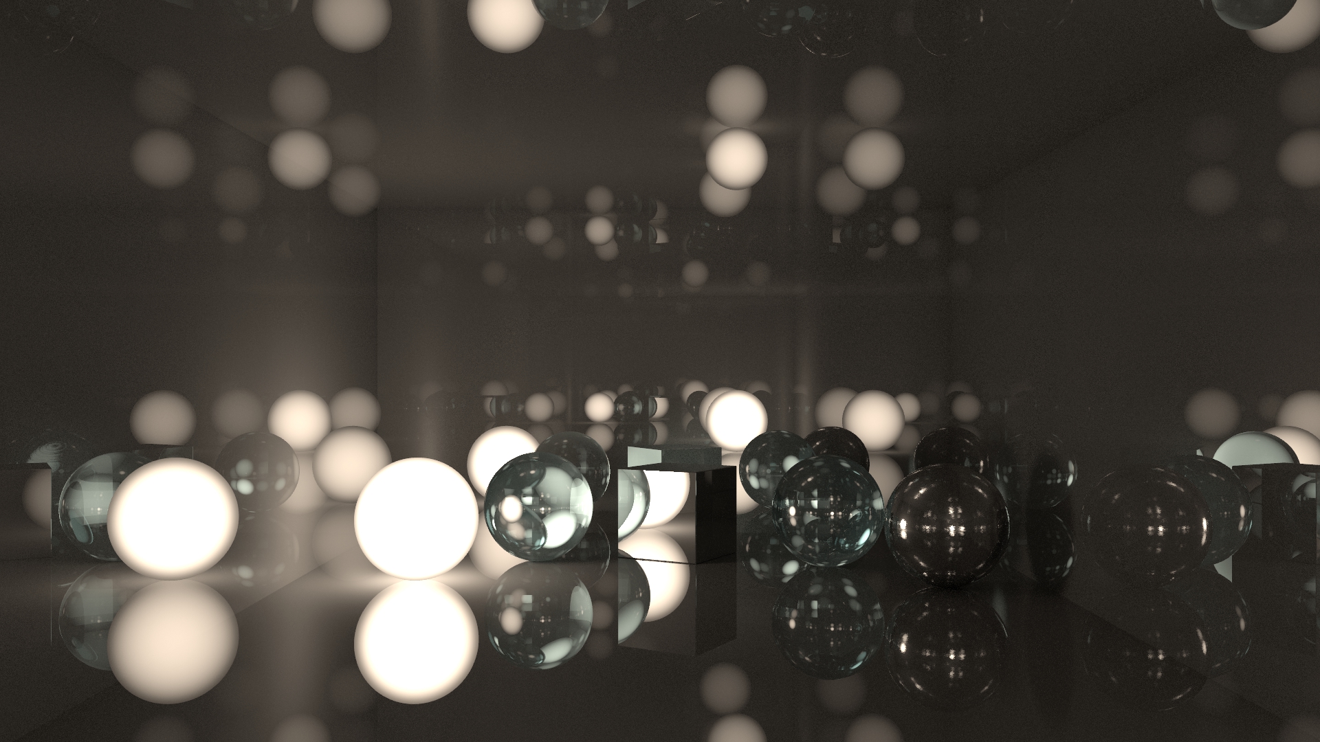

Actually I did not finish make this scene. The real purpose of this scene is to get deep recurse effect which....can kill all renders engines.
I will back soon to this with scene for K3 and LW19. Is very simple but this is killer scene but to see that it must be prepared for real 40 recurse.
Soon will post update.

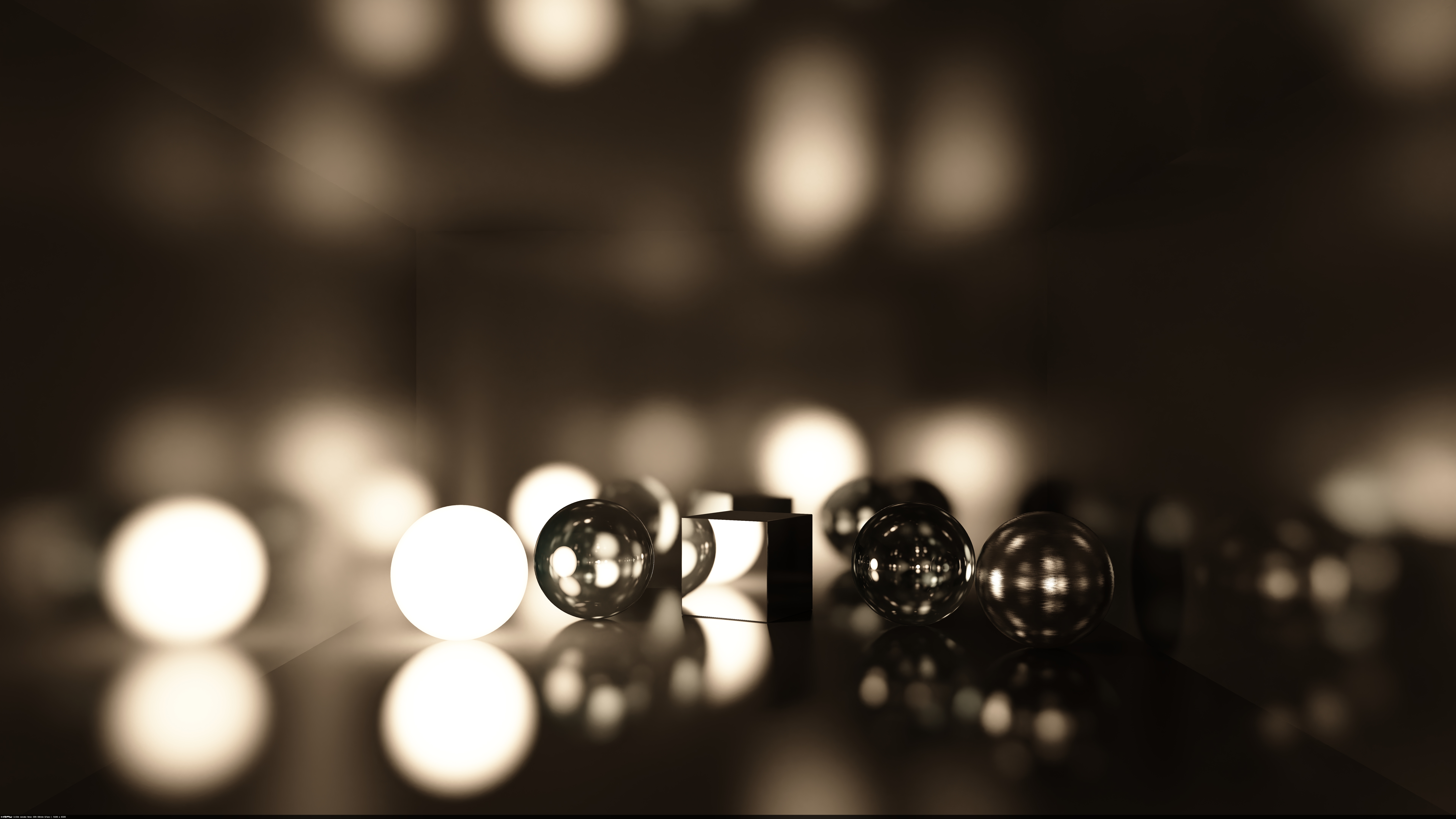

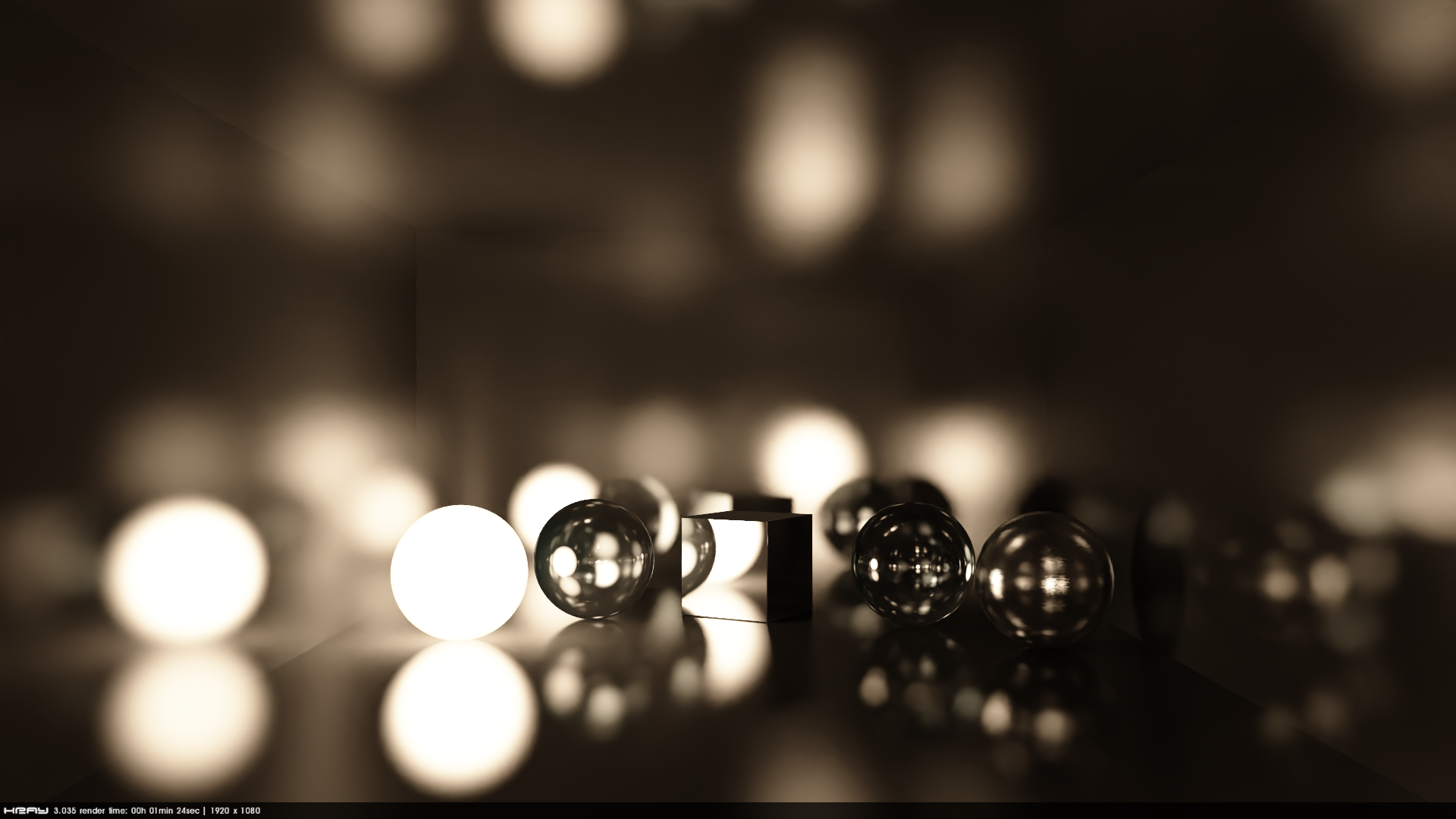

Nice scene, but what i got in 2019.3 using kray 3.04 on Windows7 was slightly different. I changed nothing.
Re: Deep recurse tester
Save this scene as it is and post here. I will check it.abe42 wrote:Nice scene, but what i got in 2019.3 using kray 3.04 on Windows7 was slightly different. I changed nothing.![]()
Hi. I used the file above
(Benchmark_Matti_LW19.7z) uncompressed it, opened it and rendered it without any modification.
I did that on windows7 and on mac osx high sierra with identical result. On both systems: Lightwave 2019.0.3.
