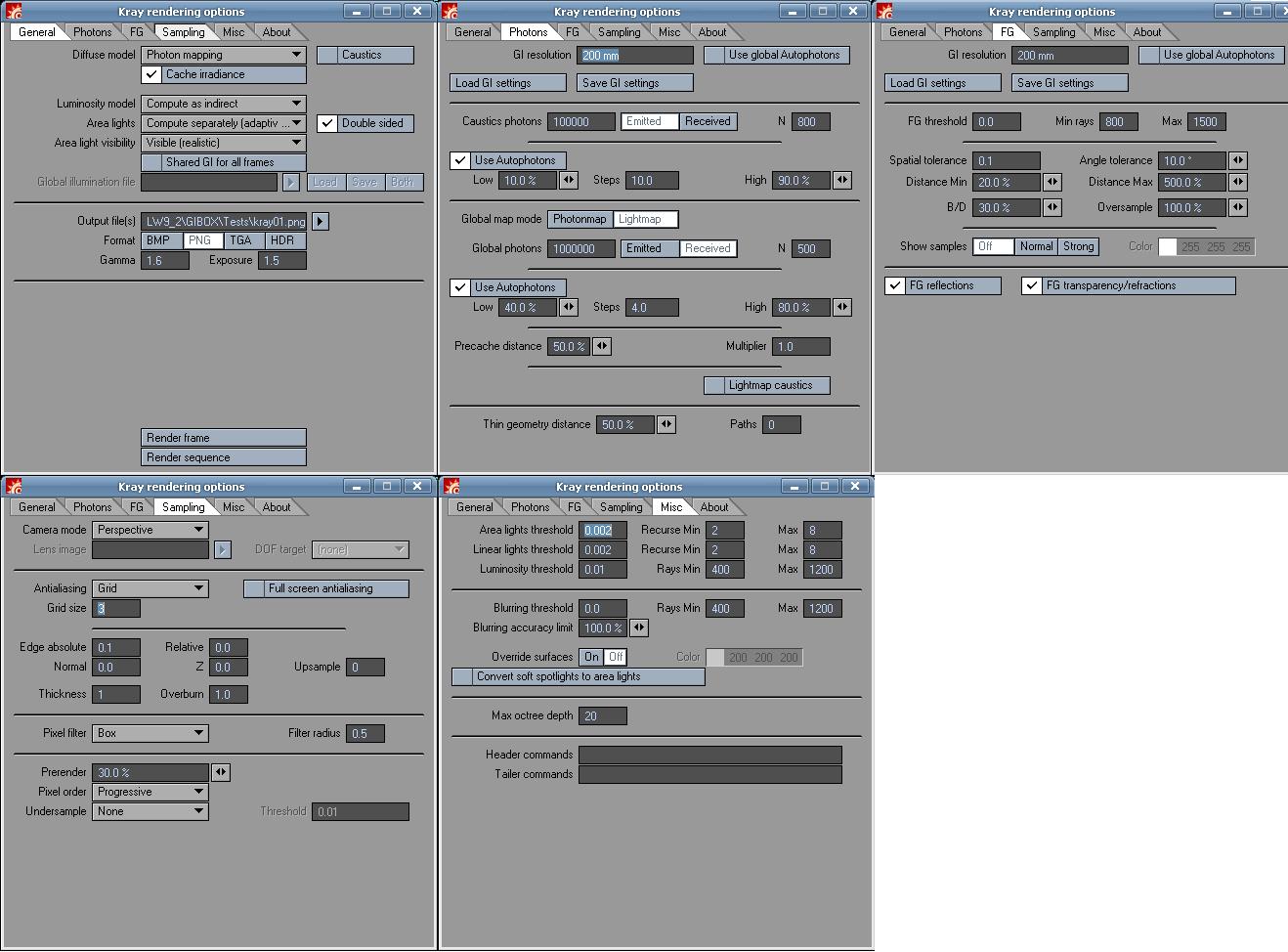

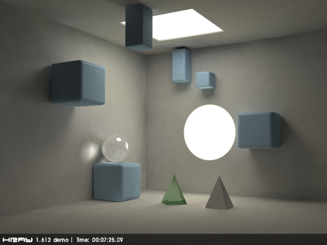

Hi all, I make this test to see what kray can do with a scene without light. The scene has only a white background. The render time is 27min. But I make some tests and I hasn't got a clean result. Here is the setup and the result. How can I optimize my setup to test a clean result and perhaps a better render time ?

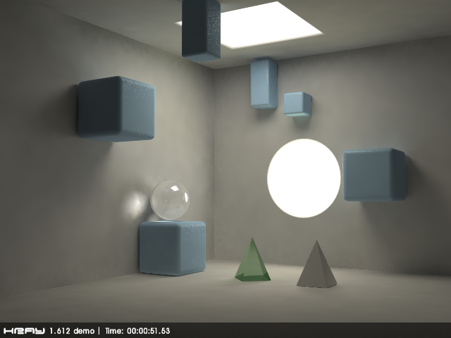

this is the scene that Intuition posted in the Newtek forum. around 2 min on my dualcore AMD 4800+, animation on http://www.newtek.com/forums/showpost.p ... tcount=123 My entry for that was this as you know. I didn't use 1.612 for a year except for that "versioncompare" image I made of that room in the kray gallery.

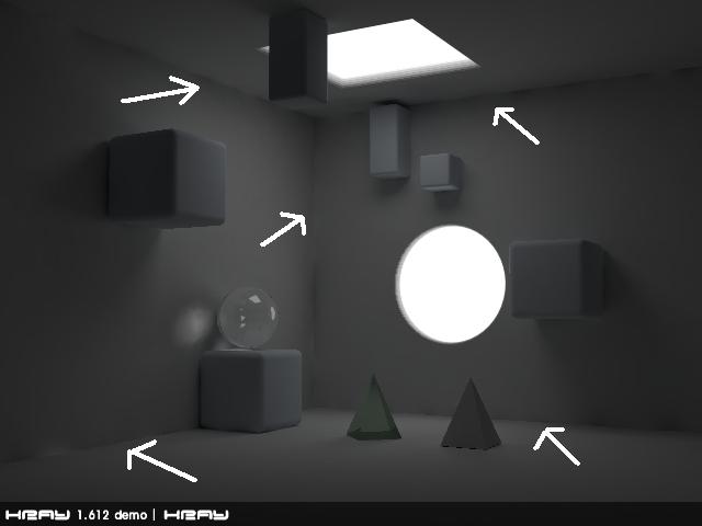

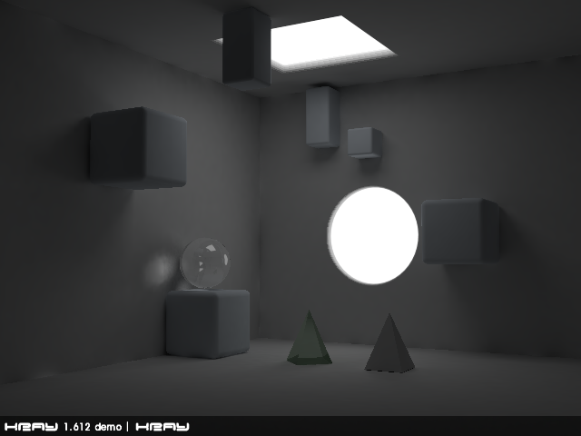

kray is the best of all in this sort of scene. What do you point to with those white arrows? Your picture is very very dark here anyway, turn up the backdrop color or multiplier in photons tab or exposure in gamma first.

Yes 27 min with amd am2 4200+ dual core, but with the settings of the picture and about 500000 cells. With other settings with 60000 or 80000 cells I get the similar quality and the render time if two or three mins. I'll make more test with multiplier.

Hi all, this afternoon I have been playing a while with the demo and the old gibox scene, I think that I can get a better result, but I think that this render time ins't worse because the kray demo don't use my dual core. I think that if the demo version used the dual core I can get with the demo a similar render time of the Erwin test.
Here is the result. :wink:

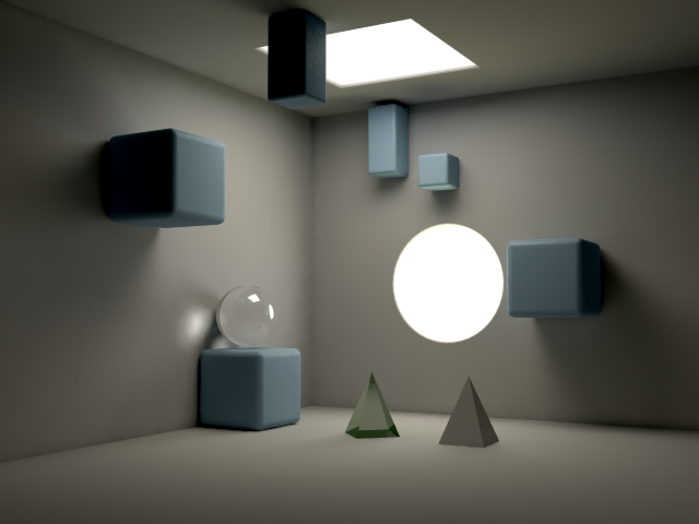

Here is another test with cache gi and a short clip. Great great for the demo version.
The clip is a little darker, always the clips are darker when I used xvid codec, i don't know why the colors aren't the same in png images and xvid clips.
