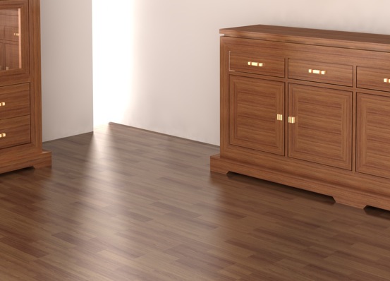

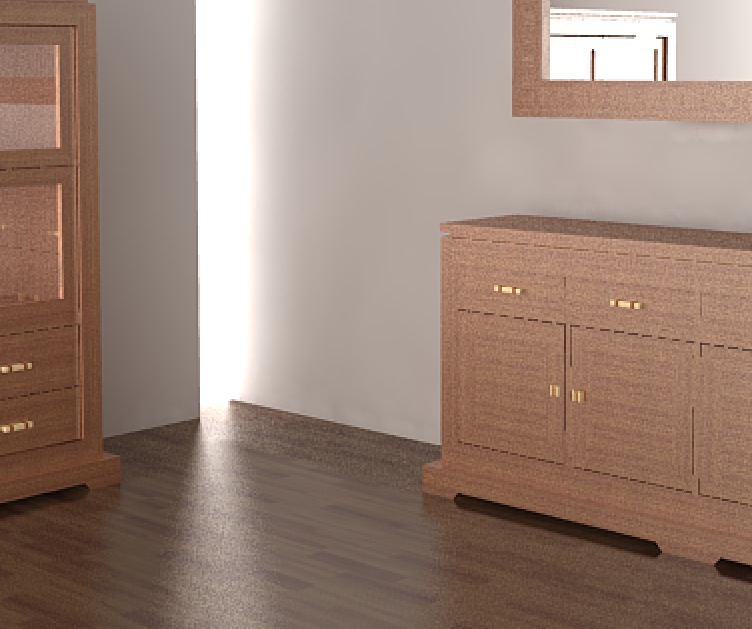

Hello, some advice to solve the problem for that grainy effect?. I've tried manny things but without success,.. it must be a simple thing to tweak..
Imagen 3.jpg (89.91 KiB) Viewed 7957 times

JUli51 wrote: Hello, some advice to solve the problem for that grainy effect?. I've tried manny things but without success,.. it must be a simple thing to tweak..
increase the number of rays in min and max right of blurring threshold, f.e. 100 1000

thanks,.. I set blurring threshold max to 1000. it works but render time has increased a lot,.... may "filter radius" can help?

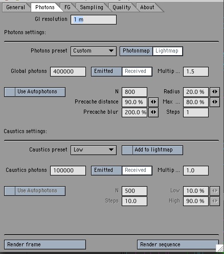

Yes, but I read your post a bit late so i have changed some settings allready, in any case: size 2079 x 2953 ppi
Imagen 2.jpg (54.9 KiB) Viewed 7877 times

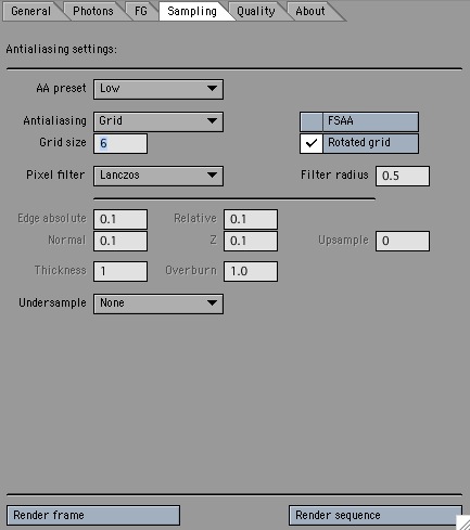

image 3
Imagen 3.jpg (52.92 KiB) Viewed 7871 times

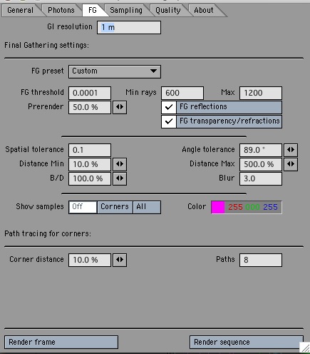

image 4
Imagen 4.jpg (37.78 KiB) Viewed 7885 times

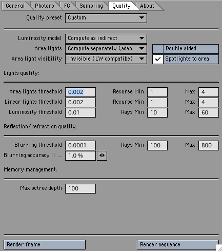

image 5
Imagen 5.jpg (55.51 KiB) Viewed 7872 times

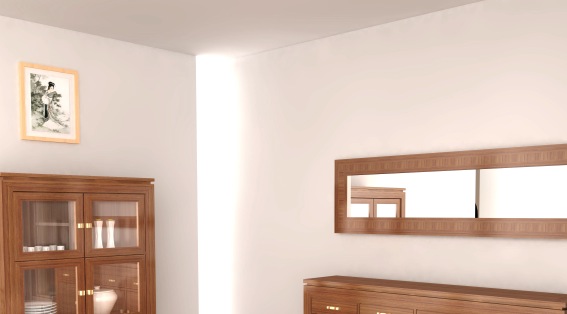

and this is the final result....
Imagen 2.jpg (43.22 KiB) Viewed 7894 times

You should turn down paths 8 to 1.
Also grid 6 AA is a bit high... Try 3 or 4 for start.

by juli51_forum » Sun Apr 29, 2007 12:50 pm
pahts so hig were to avoid artifacts in corners , I havent' show you the hole scene, does it increase render times?

Increasing number of paths will only increase render times. It won't help much. Rather Incerase Paths distance and/or FG max rays.
