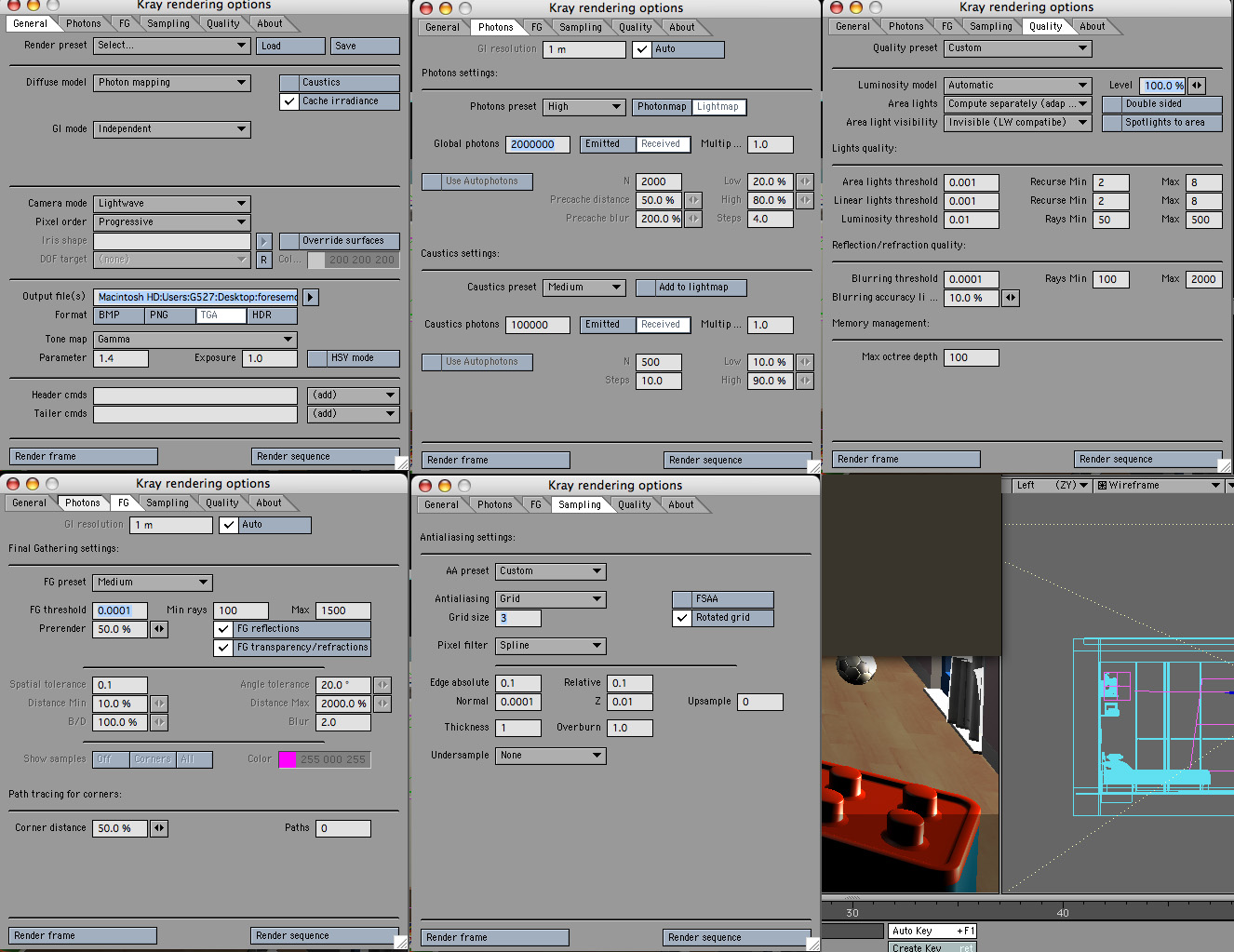

Can you show your settings?

You can try this:
Photons:
Reduce Global photons number to 500.000, adjust N accordingly.
FG:
Increase prerender to 100%
Decrease B/D to 0%
Add more blur if you get splotches...
Misc:
Set luminosity mode to indirect.
Set blurring rays max lower - 500 should be enough
Sampling:
Grid size 2 (for hirez you don't need much AA)
Use box, cone or lancosz filter since those are the fastest.
Try Edge absolute 0.5, relative 0.5
Normal and z 0.1

Thanks Jure,
your advices have been really precious.
The time of rendering he is now of 4 hours :P :P :P :P :P :P
I must only attenuate the grain effect.
