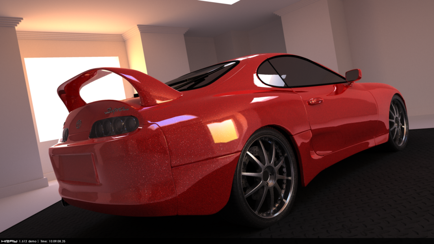

Hey guys, after about a year of fiddling I finally figured out how to use kray. So I rendered this out. =)
Its a model I made a few years ago, I could never render with blurred ref because it took too long, now I can with kray!
I worked on the paint last night and got a good metallic look to it, what do you think?
I've got a few things to sort out on the model and scene, it should be a nice final though.
BTW I'm still using 1.612 at home. I have 1.7 at work only. bring on the deom please!
Looks good so far! You can bring 1.7 home too since it's not tied to dongle. Would be interesting to see speed comparision between the two.
