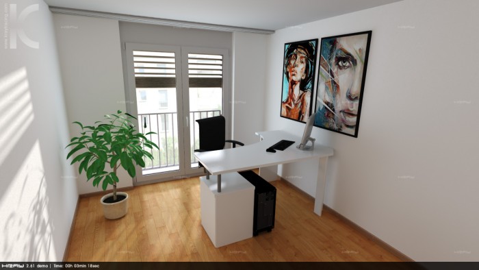

I have been playing around with the Demo Version 2.61 of Kray.
At first, it seemed like I would get it nailed but now I'm totally lost.
My goal was to do a test animation but if flickers like mad and
also changes color etc. I'm getting a red tint on the walls and
I have no clue why... Lightwave crashes after rendering 10 frames,
and I can't find out why. I don't even know if my object is modelled
correctly for Kray... maybe I need a different modelling technique?
Can someone tell me what I'm doing wrong, please?

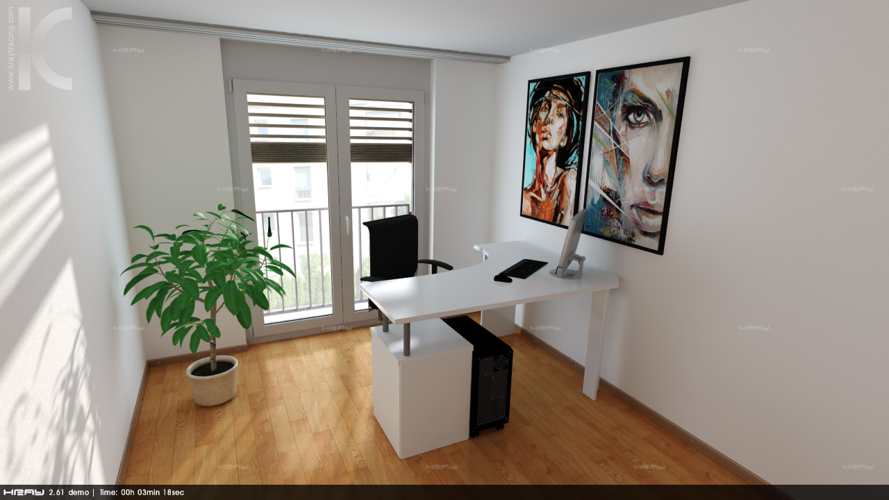

Re: Lost in Demo-Version 2.61 - HELP
Hi

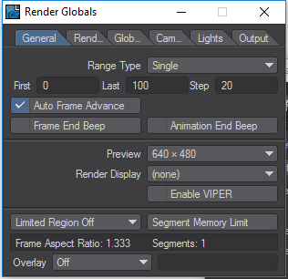

Procedures:
Bake GI with STEP every 20 frame (you do not need more frames, is enough every 20-40 frames)
After Bake GI you switch render to normal mode with ONLY one pass and Step frame 1
Render:
Scene ready for Bake (include ready animation in slow motion - 100 frames test done in total 4 min)
Scene has my best universal settings for interiors
TheOffice.7z
(3.89 MiB) Downloaded 1747 times

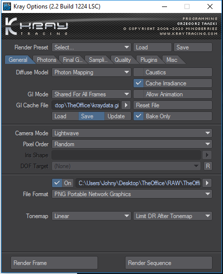

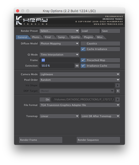

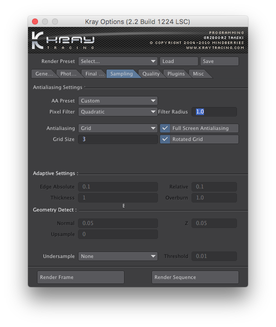

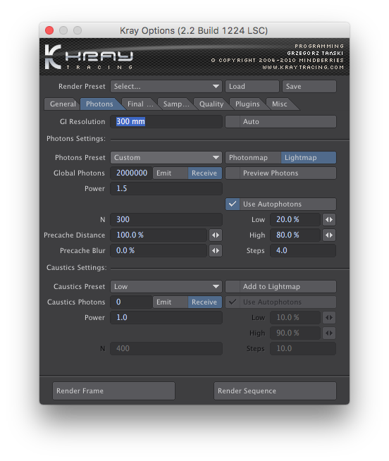

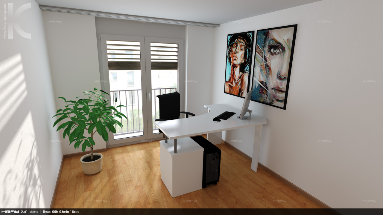

Hi there Janusz

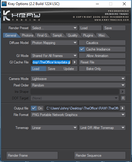

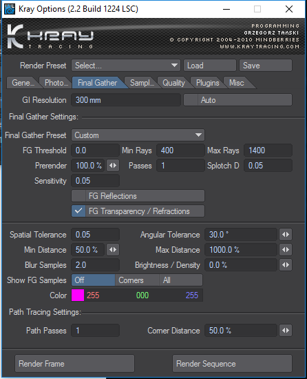

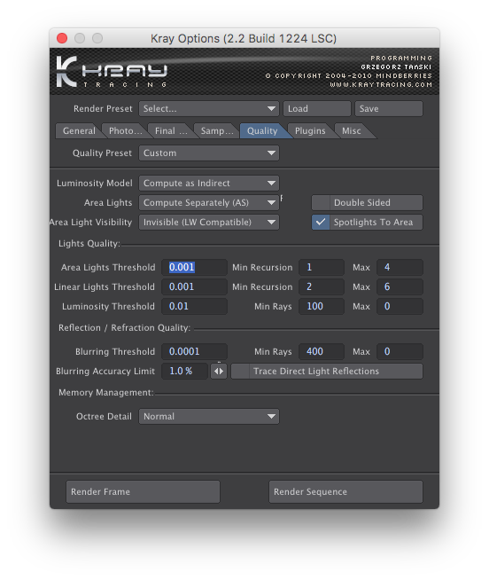

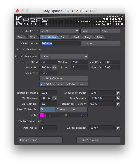

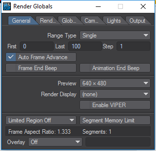

I've been playing around some more... here is what I came up with... see attached JPEG
And I also posted my settings...
I'm still not 100% sure whit the baking stuff. So, I leave all the settings in the Kray Tabs the same,
FinalGather with 2 passes, bake out the Scene with frame steps 20, change to frame step 1 and
FinalGather to 1...?
But this is REALLY FUN and the images look cool :D
Cheers,
Steven R.
LightwaveSteven wrote:Thank you so much for the response.
Your Scene look great!!! :shock:
You wrote:
After Bake GI you switch render to normal mode with ONLY one pass and Step frame 1 Render
with "ONLY one Pass" you mean the Final Gather?
But to achieve the Baking, you use the same settings on every Tab, except Final Gather with 2 passes?
Cheers,
Steven R.
Yes
- When you BAKE GI you need full quality render.
- Bake GI doesn`t need reflection and Anti-Aliasing - why you see white render during bake.
- Bake GI needs only a few frames (every 20-40 frame) because camera make very little movement and new region appearing during moving are just a few percent of whole scene. If you put in Bake mode frame step ONE you will waste time (Kray will not find so many new GI samples) and you will start search sample which already founded. Of course when camera move very very fast you need smaller step. For interior is enough 20-40. For this scene I think step 40 is ok.
- When you finish BAKE you must switch Kray to LOAD option with ONLY ONE PASS (you do not need calculate samples again because they already founded)
- You can render this scene on other computers:
* computer 01 - frames 0-100
* computer 02 - frames 101-200
* etc
Just copy GI file or load GI file over netwotk.
BAKE is ready - so nothing change in scene. Only is calculated AA and reflection/blur.
- You can stop render and continue later (final rendering after bake)
- GI file can be huge (2-4 Gigabytes) depends from complexity of scene.
LightwaveSteven wrote:Thank you SO much, Janusz! :D
You are a HUGE help
What I forgot to mention:
in MY scene, the camera will not be moving, just the window blinds come down slowly
for 20 Seconds, and then they turn to close and the room becomes almost dark.
Would that make any difference in the set up?
Cheers,
Steven R.
This is the worst scenario for Photon Mapping (generally in renderings).
You have two choices:
- use Path Tracing (it will take years to render)
- use Time Interpolation in Photon Mapping
Time Interpolation create blending between frames to reduce flickering. Because we MUST shoot for each frame separate photon solution.
Every frame has different Photon Map - it means: flickering.
We must shoot for each frame separate Photon Map because you have moving objects in scene (blinds going down so every second is darker and darker, every frame has different Photon Map according to situation from blinds position.
You must render each frame like single frame - so there is no possibilities to speed up. You can not stop rendering. You can not share over network. You must render it on single computer.
Here scene with Time Interpolation. Scene is setup for final quality (I render without AA and 2 passes):
TheOffice_Time_Interpolation.7z
(4.15 MiB) Downloaded 1796 times
