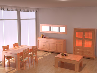

Here another example wich may help
Imagen 1.jpg (60.35 KiB) Viewed 10063 times
Could you post a scene Juli? This looks strange...

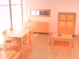

don't care about the strong luminosity in the scene, i move the camera and dont' heve time to make a new render,.. just look at the strong red lights under the tables and inside the big furniture, seems like a strong reflection from wood texture, ican't say.......
last render.jpg (55.12 KiB) Viewed 10094 times
I have never experienced anything like it. What version are you using?

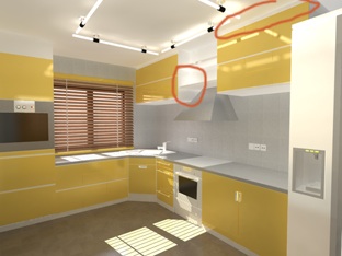

I'm using 1.7 I have another example of it in the corners of this kitchen, the just make the inverse of what they should, instead get more darker, they get more luminous...
kray_render00000.tif
kray_render00000.tif (243.15 KiB) Viewed 10092 times
Perhaps it's a surfacing issue. Try reseting surfaces to default smooth grey or using override surfaces in kray panel and see if problem is still there.

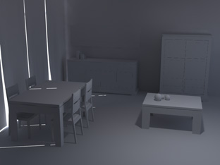

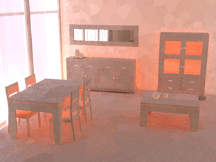

ok,.. fine,.. I have overrided surfaces and got this image,... but rendering again with the surfaces, the problem still there....I will try to manage the surfaces in the LW surface editor, let see what happents.. :roll:
phile_forum
Posts: 177
Location: UK
Post by phile_forum »
Do the diffuse & reflection channels on that surface add up to more than 100%?

JUli51 wrote:no,.. dufuse channel: 72%
reflection channel 62%
... which adds up to 134% reflected light if the diffuse colour is white.
