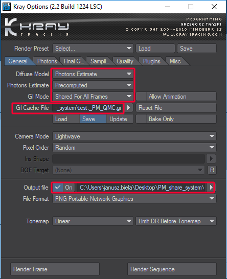

Procedures:
1. Open scene and select path for GI (this is wrong name for that because this is not Global Illumination) and path for images + this setting.
2. Press render button and wait when Kray will save first image - this is very important - because after saving first image Kray also save Photon Map file.
3. Stop rendering. You can delete precompute image also.

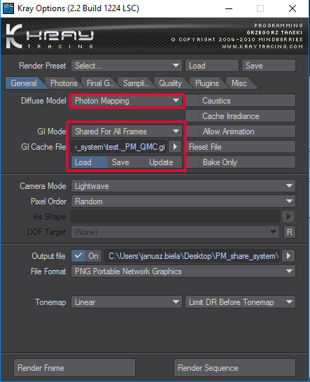

4. Switch Kray settings to standard render with option LOAD:

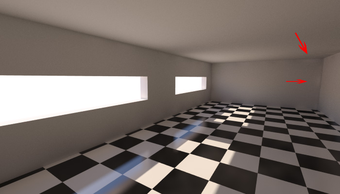

Inside I put also RAW files to see effect of sharing Photon Map.
We can see splotches (in this example is good when we see them) and they are "static". Frames are without flickering - it`s proof that Photon Map is no changing during animation. Splotches comes from one side wall and Physky light (there are not LEM panels in windows).

This is proof that Photon Map solution is static and working well (this is light leak from outside - one side poly):
You can see this in example scene package (RAW folder) that splotches do not move or flicker - it means Photons cells are not change during animation.
