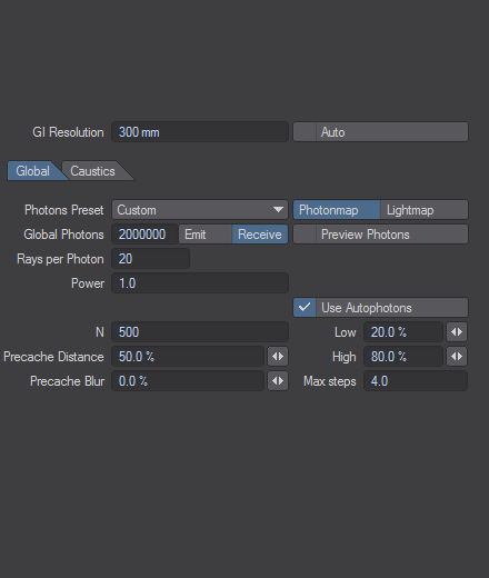

If you want more passes (FSAA Grid4 = 16 passes) simply change it in AA Preset
If you want more/less noise (QMC system) in Final Gather Preset change min Rays:
- 100 very fast render with big noise
- 1000 and more better quality

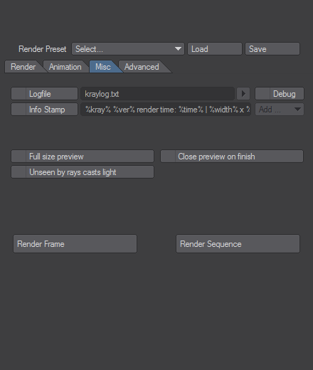

Just disable Full size preview:
For VPR you must shoot always photons before. Is just better to use PPM for now - up to moment when PPM will be connected to VPR.
Remember, first time when you start VPR in scene you see ray tracing render without photon map. In case of use VPR you must use Photonmap:
System shoot photons from light sources so they are everywhere and is not dangerous situation when you rotate camera and you see dark behind.
Is one small problem with Photonmap: you must shoot enormous amount of photons. At least 10.000.000 multiply by 10 or 20. You must be sure that all photons penetrated all corners in scene. It takes 20-120 sec but after that you use VPR like in FPP game waiting for refresh.
