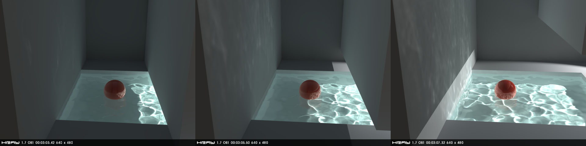

I don't see a lot of water in this forum.
So I post some tests to show a little water effects...
- water.jpg (89.39 KiB) Viewed 12350 times

This is a 100 frames movie.
Render is 640x480 but scaled down to 50%.
I let Kray line at 100% so you can see render time.
There is just one source : a spot light.
Water is nodal displacement.
I was to lazy to model a rubber ring duck...
I render with Time interpolation GI mode...
Is it ok ? Jure, can you explain a little what can be tuned ?

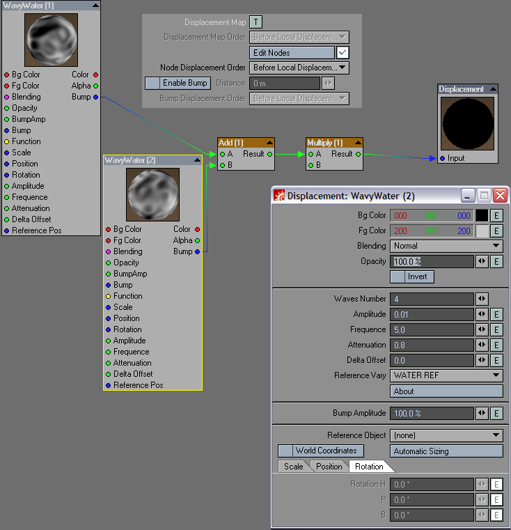

Sorry for the late answer..
I show you displacement node (very basic one)
Wave (1) turn to the left and Wave (2) turn to the right.
Add is for mixing the two and multiply to control the whole displacement value.
But for a big pool, it's better to make procedural to move, otherwise you'll be able to see rotation center, and there is to big speed delta between center to outside.
You can try a lot a combinaisons. Wave is a soft one...
