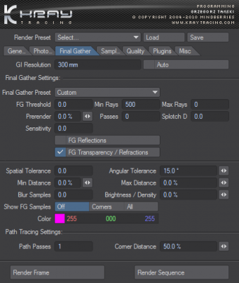

Simple "brute" answer: render at double resolution, de-noise a bit in Photoshop and then change the image size to half the original size (which will reduce noise by 50%, but with a longer rendertime of course).
Re: how do i get rid of the noise
This is minimum for QMC:
But for high quality you must add more rays: 1000/0
Setting 2000/0 is extreme.
1000/0 means twice longer render then 500/0.
But there is trick: then higher resolution the less rays you must use. for 5000 pix sometimes 300/0 is enough (still noisy but better to clean).
For fast preview 100/0 is enough.

Thanks for all your suggestion. the funny thing was, i thought when i used the uncached option (since it is set to higher quality) i wont get noise....but it came out more noise than "high" setting option.
will give a go on all your suggestion.
