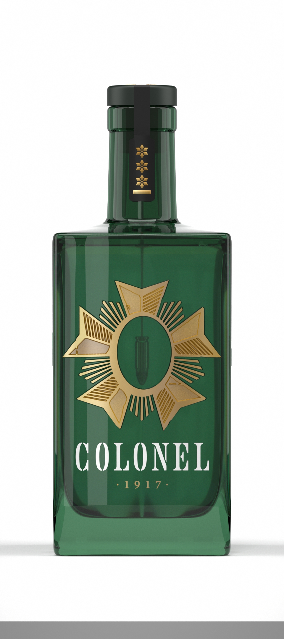

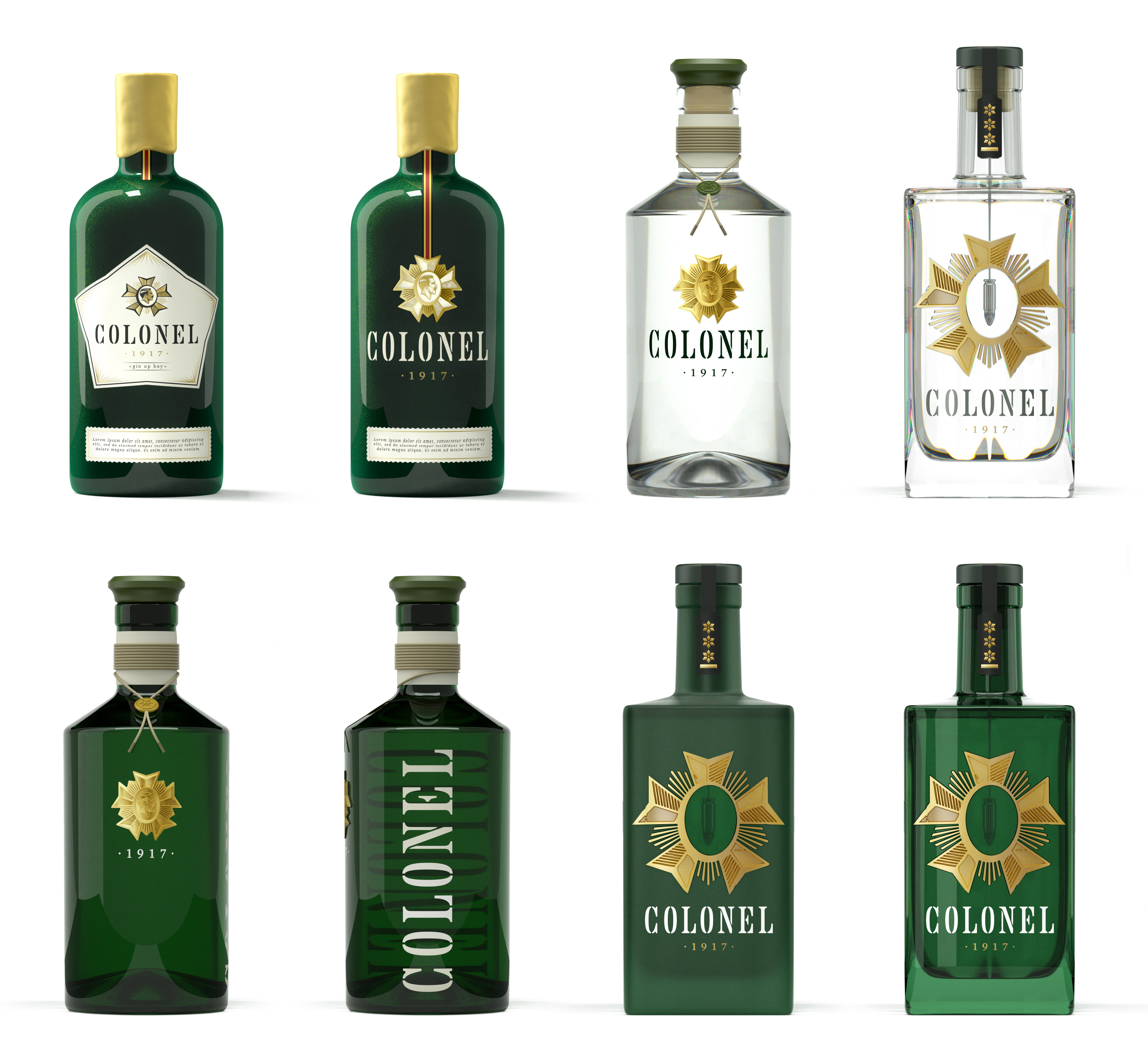

Hi! I'm not sure where to post this on the forum, or even if this is allowed, because it is about another render engine. If this is against the rules please let me know and I'll remove the post.
I just wanted to post some render I did with Octane this week. I hope I will be doing all of this work with Kray 3 soon. At the moment the glass shader and lack of subpixel displacement make this process a lot slower in LW + Kray. The speed of setup for these renders is amazing, and I say that as someone who's only using Octane for a day or 3.
It really is almost:
1) Create Bottle Model and ground plane.
2) Apply Glass shader. Apply "print" shader - these just work practically "out of the box"
3) Make mapping to say which part is glass and which part is printed.
4) Make and apply displacement mapping.
5) Render.
On the bad side: noise. Still, the speed of process makes up for a lot. (edit: the renders are the original renders, not rescaled, so you can judge for yourself about the noise).
(edit 2: these renders are almost straight out of Octane. The first two have dissolve noise added in Photoshop to get a metallic carpaint sparkle, all others just have some contrast adjustment done in Photoshop).
5) Render.

I forgot one more "bad side". Almost everything (except for some procedural noise shaders) needs a UV map in place. For this type of model that's not really a problem of course, since a simple cylindrical projection takes care of almost everything.

I tweaked your render settings for you....
totally noiseless image with only 75% of the samples you used and using the faster kernel...should render in half the time
Coherent ratio...GI clamp and caustic blur are the keys here
