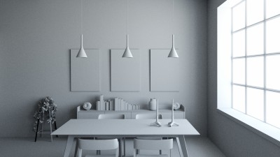

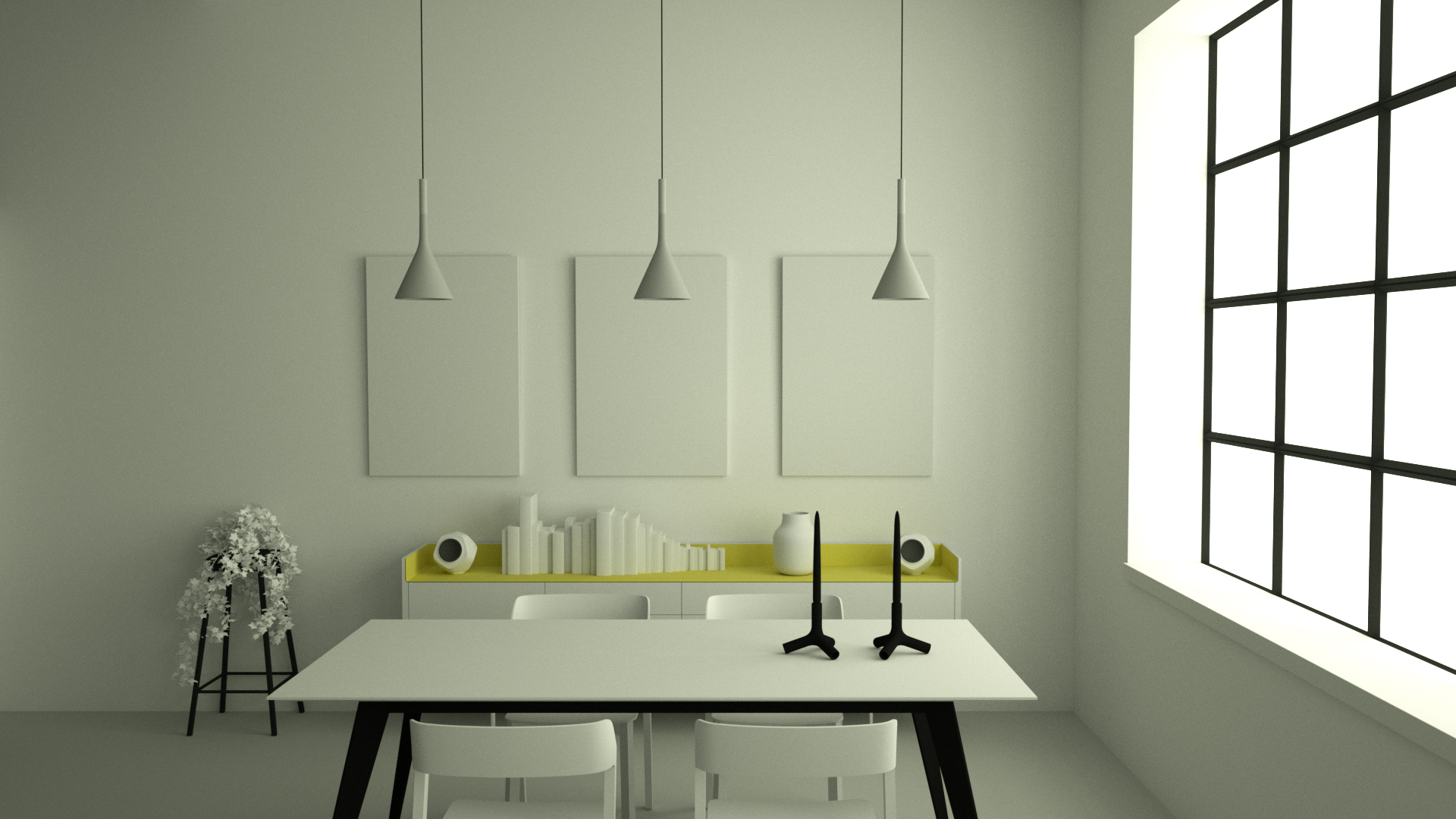

Since it's so quiet here I thought I would just post a very rough test of an old scene with Octane. No surface set.
For those that are curious: it's brute force rendering, so even though it's rendered on the GPU there are no miraculous speed gains. This took about 40 minutes on a GTX 760 (with 1152 CUDA cores), and it's still pretty noisy. More contrast in the materials will make it even noisier.
The material shading and surfacing though is amazing - some neat tricks in the workflow that make setting up physically accurate stuff supereasy.

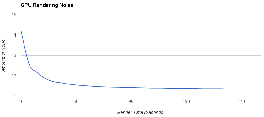

The noise level in Path Tracing NEVER goes to be clean. Is just level which user accept.
Noise level in Path Tracing is exponential: next level of noise is longer then previous. Why renders in Octane, Arnold, Maxwell appear very fast in the beginning (big noise of course in first minutes) but later is getting slow with each step and to achieve quite clean render you have to wait many hours.

Also, good point on the exponential nature of path tracing noise. Marginal gains for longer render times... My scene only has the windows for lights in Octane - in Kray there are 20 lights in there, but Kray is a lot faster

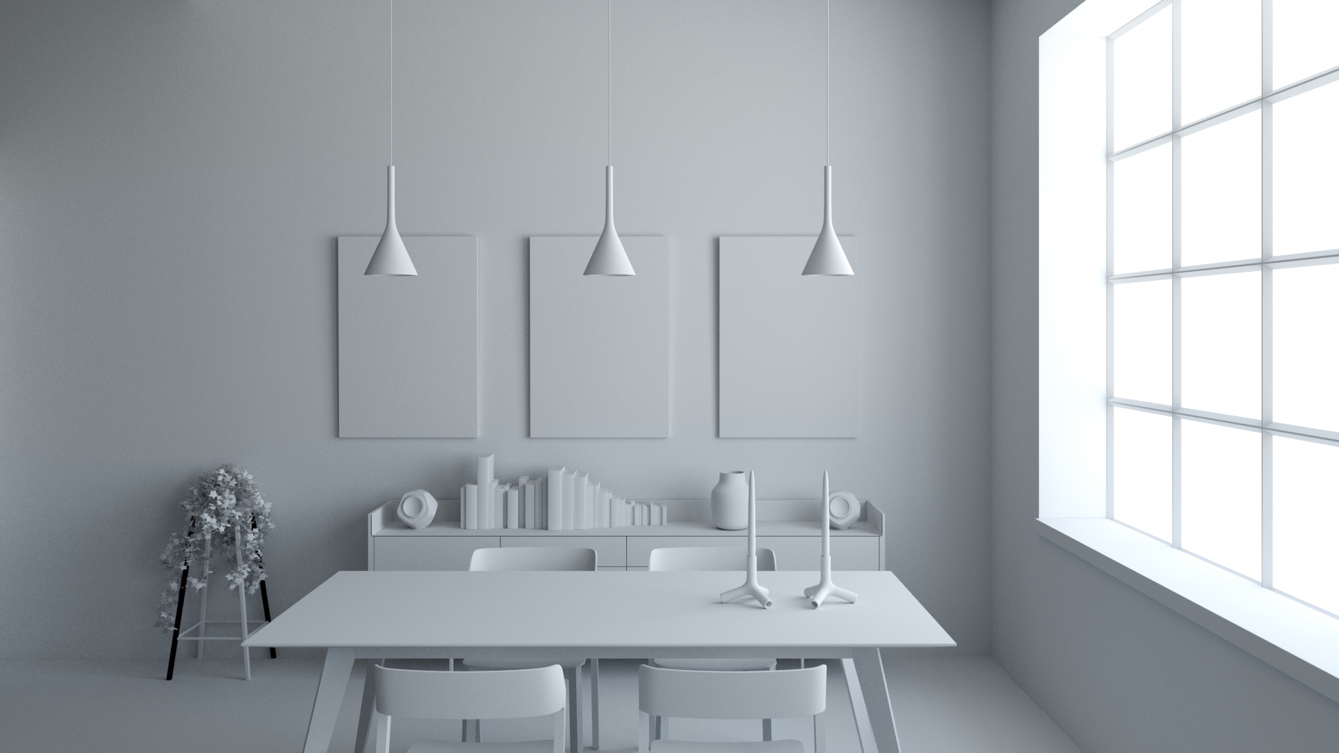

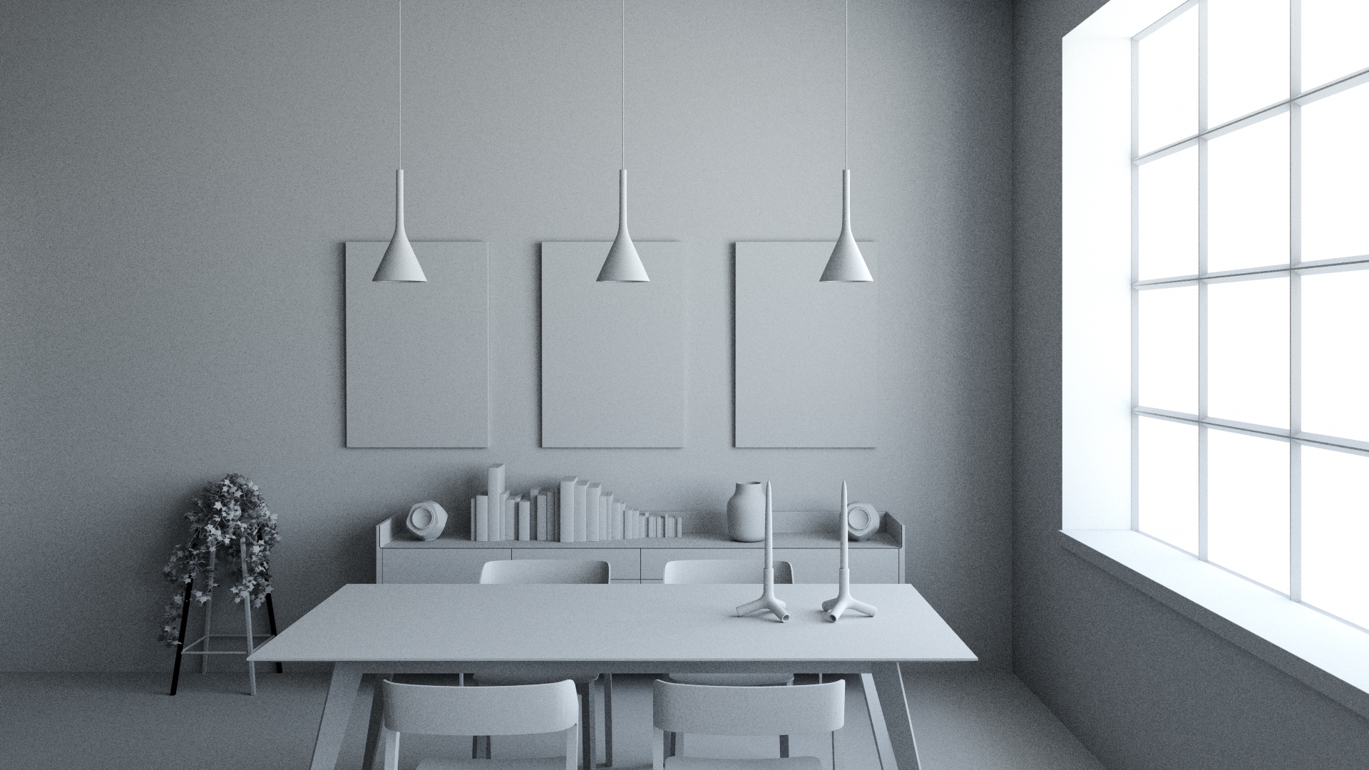

Here my test in PT (i7 CPU, 70 min):
Is longer because pure Path Tracing (no MTL). Also I do not know how to compare i7 to GPU...so maybe is fast.
QMC test 40 min: You can notice, there is very small differences (impossible to see by amateurs).
to make same noise render time will be 20 min so around 7 times faster then PT.
Differences in brightens comes from photon mapping system (this is normal) but has nothing to do with sampling.

I'm curious about the difference in brightness, due to the photon mapping system. I'm shocked to see the difference in contrast, with the same tonemapping, just by choosing a different render method! Why is this normal, as you say?
By the way, did you do both render with Kray 2? The PT render has so much more contrast and life in it!

Both with K2. Differences in Photon Mapping (in brightens) comes form render engine and system of transporting photons . We must understand Photon mapping is interpolated process and all information is taken from averaged data. Each render engine (V-ray, Modo, etc) has different system of transport and calculations. Of course Global Illumination in all render engines (for example Maxwell, Octane, Corona, Arnold, V-ray, etc) are based on this:thomas wrote:Hi Janusz,
