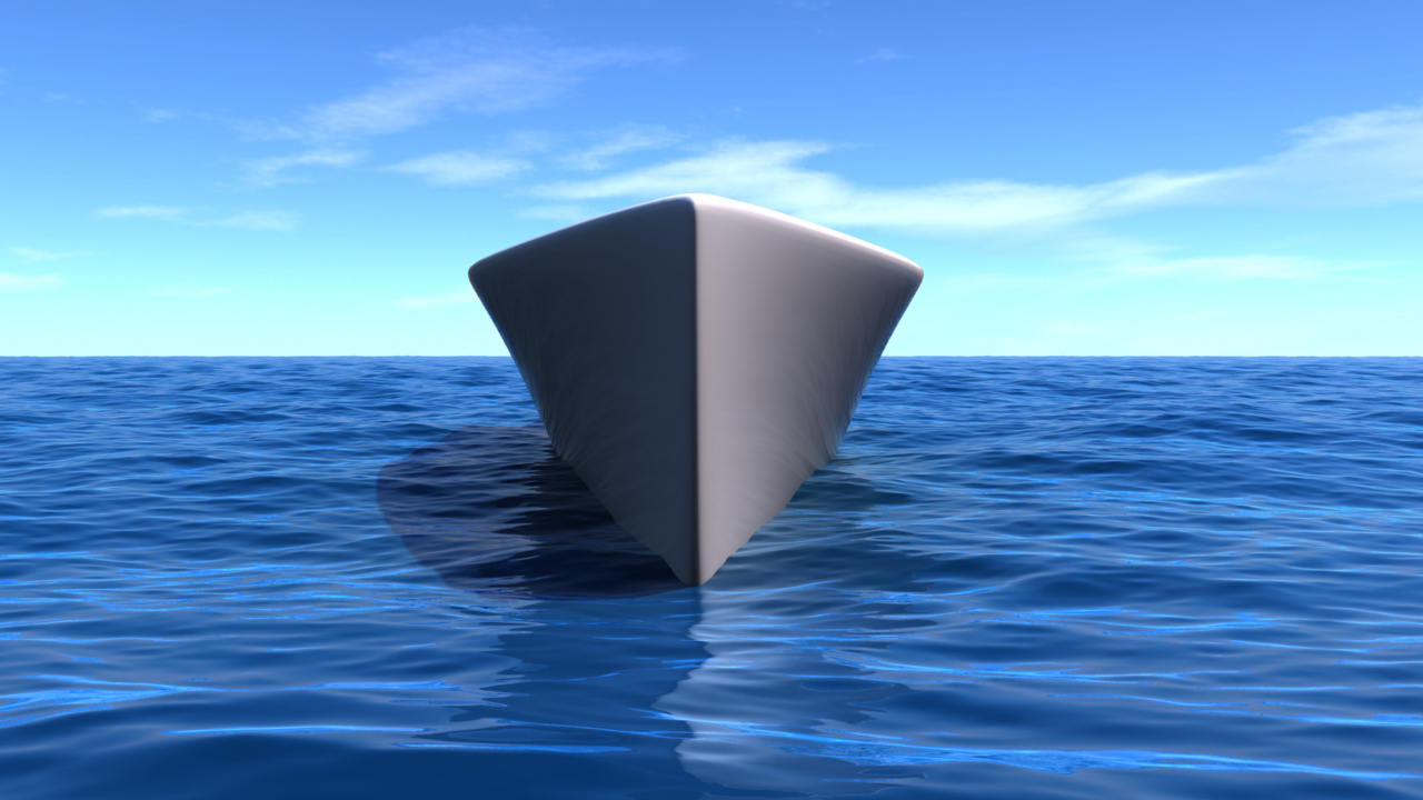

So this is where we are so far, seems to crash randomly 100 frames in or so.
I have attached the scene so far, all comments and ideas very welcome.

If you can not make the fog in comp you have another option. You can set the transparency of the water object with a distance from camera. Is what the lightwave does internally when using fog.
To make water realistic you need to work a lot on the bumps, best to do it procedural. Just remember that water is mainly reflection, a bit transparency and lighting from a skydome. The water splashing from the boat should be done with particels. We use realflow and sometimes houdini for that.
