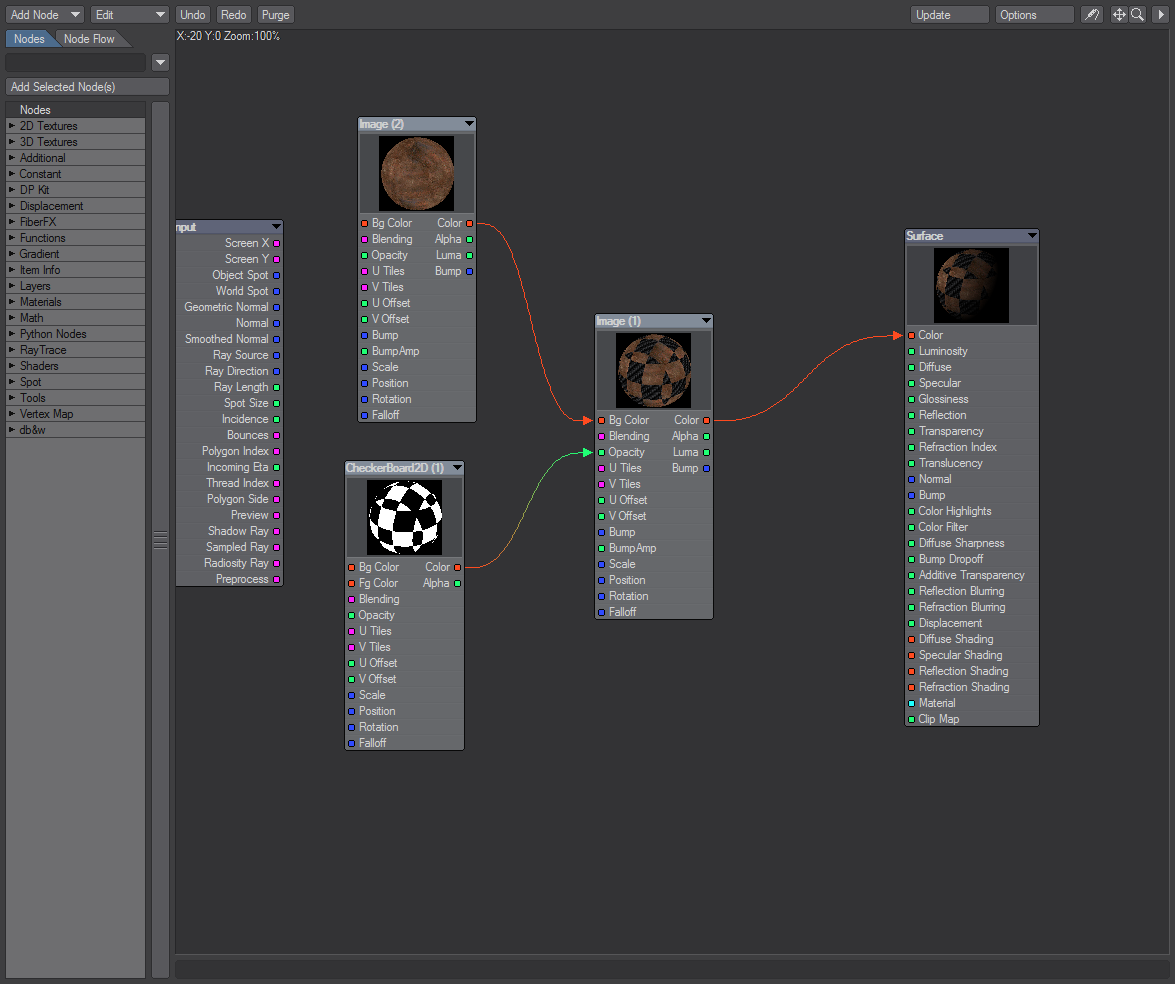

Try this:
Scene:
alpha_nodes.zip
(7.07 MiB) Downloaded 359 times

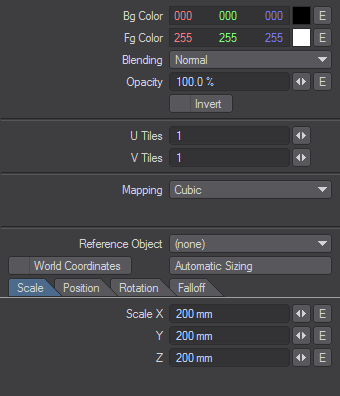

In this Node (CheckerBoard2D) by opacity you control strength of alpha:

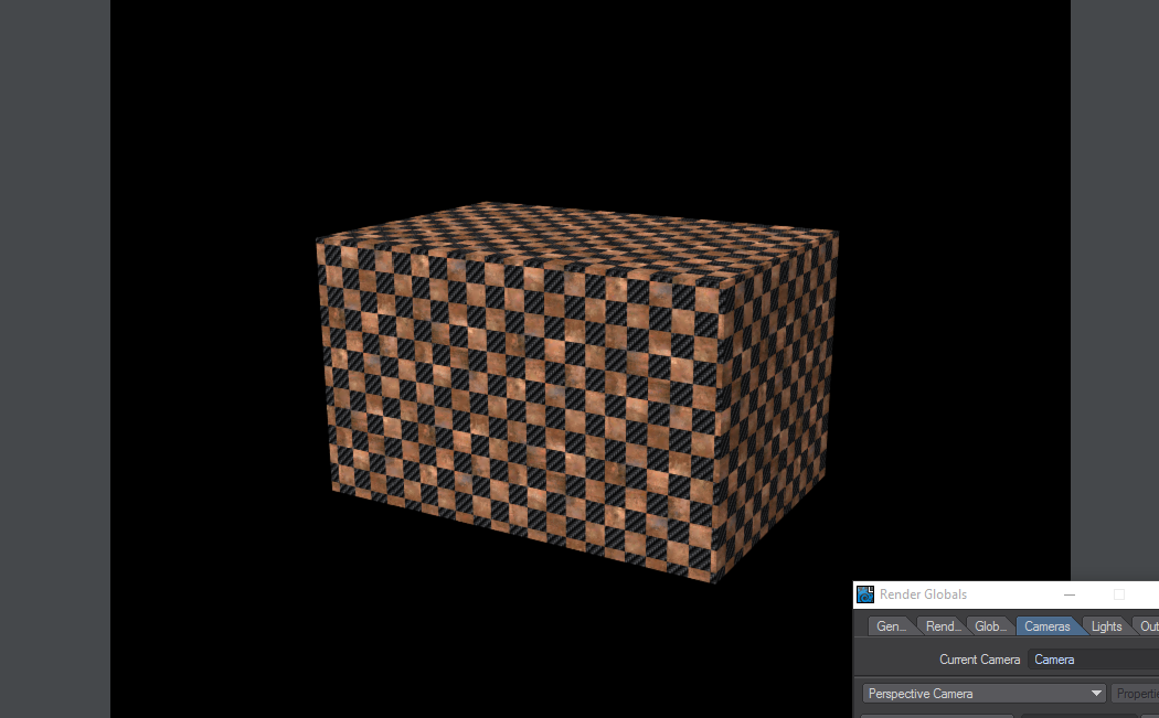

Also you can mix two textures in Image (1) with different blending styles (screen, multiply, additive, etc).
Fire LW VPR and play with options.

Hi Janusz,
Thanks for the tip! It helps me to learn, but in my case, I have two "color layers", and the color constant does not have an opacity input.
I can create a GRID procedural and set the line width to 100% to create a solid color, and then I have an opacity input, but it seems like there should be a simpler way to create a solid color over another color, with an alpha channel.
