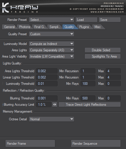

thomas wrote:4) Shading samples: what does this do, and does it affect the Kray rendering engine?
It does not affect Kray engine because Kray has his own and this is overridden function. Kray has his own settings: min/max Rays. For example:
Area Light with threshold 0.001 + min/max rays 1/4 (standard good quality setting)
thomas wrote:5) Light samples: same question as number 4.
Thanks!
Thomas
It does not affect Kray engine because Kray has his own and this is overridden function. I think this is threshold.
Here, standard good quality for Kray according what you ask:
Generally from LW works only these options (they are important of course):
