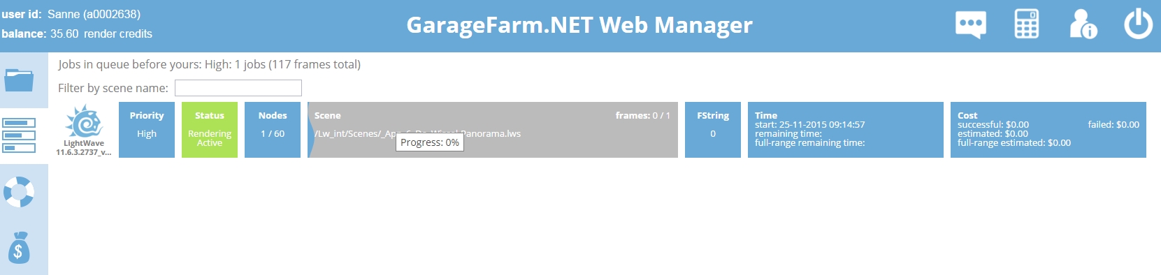

Re: Renderfarm
Hello,
Thanks for your input.
But sill......................something is not going right.
I think i set my render on Priority and still i am waiting and waiting and i do not see any progress.
Is that normal?
Printscreen of Webmanager included.
Is that normal?
Re: Renderfarm
I think is ok. Before your start is 117 frames. It can takes a while to starts your project but not so so much long as with Low o Medium. Also your project will be faster render because High Priority has the biggest amount CPU assigned for this level (it can be that you will get ready all frames after very short time)
