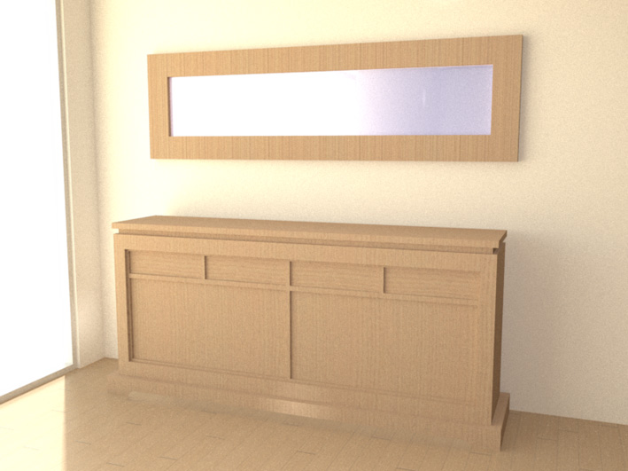

still need some help to achieve quality, many attemps, but don't get with the right settings, can somebody tell me some settings....?

by juli51_forum » Wed Jan 03, 2007 5:17 pm
ok I have smoothet the shadows and the higlights, but still have to many grain in the render

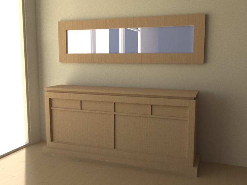

by juli51_forum » Wed Jan 03, 2007 6:25 pm

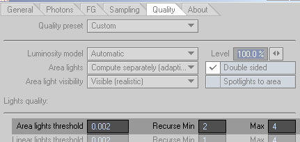

ok, I set min rays from 250 to 100 and max from 300 to 1000.. and I got less grain so i will try now with max rays 2000... lets see what happent...

by juli51_forum » Wed Jan 03, 2007 6:45 pm
I have area lights threshold 0.002 Recurse min 2 Max 4 but luminosity model not in automatic but in compute as indirect
Posts: 2142 Joined: Thu Jun 02, 2005 6:53 pm
Post
by jure » Wed Jan 03, 2007 6:51 pm
Try min4 max 6 then.... maybe it will help.
Luminosity model doesn't matter since you're not using lumi polys.

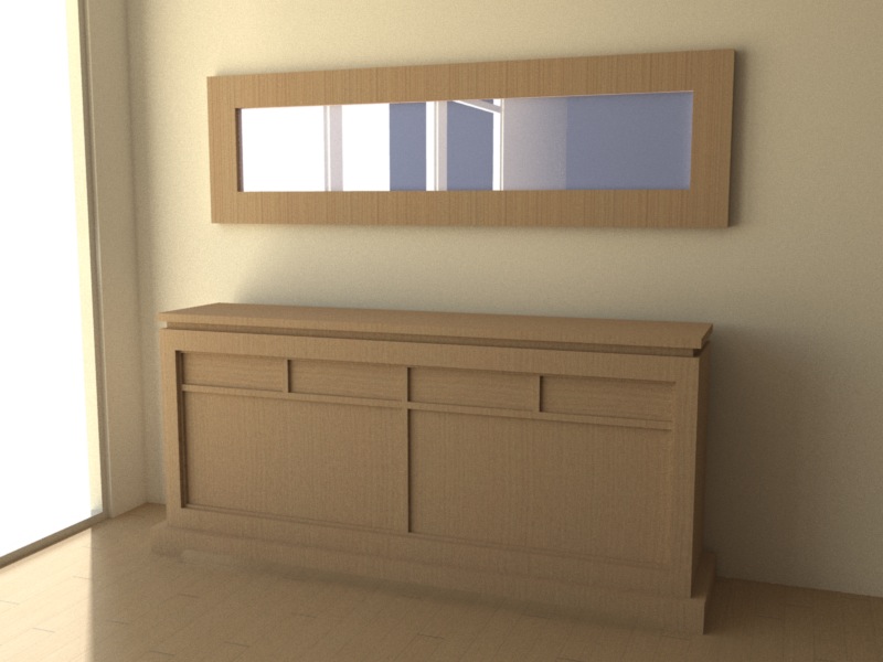

by jure » Sun Jan 07, 2007 10:56 pm
Okay the problem was that you didn't check "cache irradiance" in General tab.
This means kray won't use speedups for calculating GI but it will use brute force method similar to LW...
