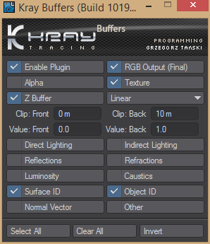

I want to ask if you can somehow quickly render only one of the buffers (Surface ID, Object ID, alpha-channel, etc.)? Maybe if I was of him for the final render forgot to activate.

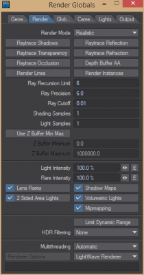

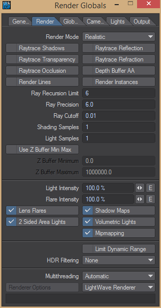

As you know buffers are based on geometry and to render them you must render whole scene again with Anti aliasing. There is no another way to do it. But always is trick how to do fast:
1. In LW Render properties turn OFF raytracing flags:
if you want Alpha then you must leave Raytrace Transparency.
2. In Scene Editor turn OFF all Physical Lights
3. In Kray General Tab switch render system to Raytracing.
4. You need Ant Aliasing for buffers (no changes)
During render whole scene will be black. You need only geometry with Ant Aliasing without lights. Very important is not to have any PHYSICAL lights in scene because these lights are also calculated in Raytracing mode (render shadows).
By this settings above you can get very fast these buffers:
If you want more buffers then you must do additional settings but I think this will be enough for you.
