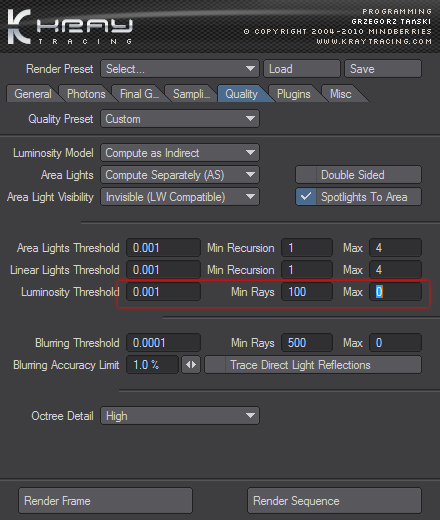

So, for IES quality noise you must go to Quality Tab:
For 4000 pix resolution it should be at least FG 500/0 (this what you had) but as you know QMC mode (UnCache) is based on Photon map quality. In other word: shooting photons is interpolated (photon mapping) but calculating GI samples is no interpolated (similar to Maxwell, Octanes, etc). This noise is of course normal, never clean enough (is only level acceptable for user). Why I told you too shoot a lot photons to get the best map.

I think FG 1000/0 should be minimum for this resolution + FSAA G4 Box 1.0.
But If you have time you can use common trick from Octane, Maxwell renders:
- render image with double resolution (8000 pix)
- render with low QMC quality (300/0 or check also 500/0)
- render with low Anti Aliasing FSAA G2 Box 1.0
- render with low reflection blur (Quality Tab Blur Threshold, min Rays/max 100/100)
You should get fast and noisy render. After that you know what to do...PS de noise, PS rescale 50% resolution down, PS sharpening...
This I did in my last render test:
http://www.kraytracing.com/joomla/forum ... &mode=view
Of course somebody can tell: whole procedure takes long but in the end you will get HQ render...which is important for Panorama.
