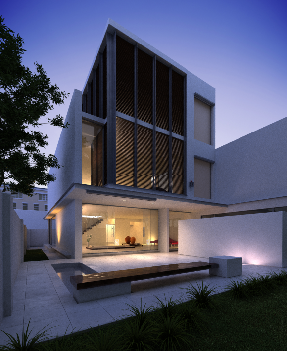

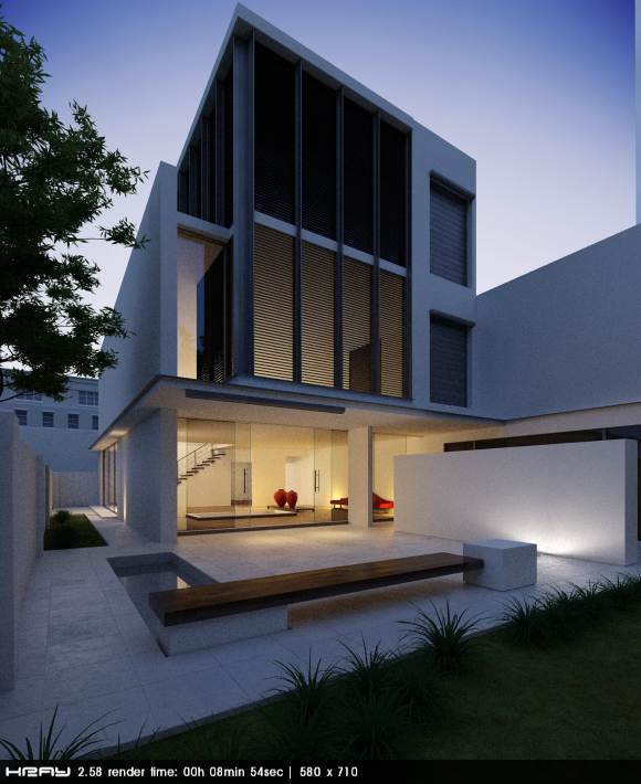

Exterior Node test
Exterior Node test
Here my fast test in QMC mode in Kray.
V-ray 6 min:
graflukas
Posts: 32
Location: Poland
Re: Exterior Node test
Post by graflukas »
Yes pretty and outstanding in this forum as always.
I like this architecture and camera shot - like album photo.
Evening renders forgive many mistakes, (correct lightening is a hard work),
but still impressive, because exteriors are very difficult.
Settings crazy as always, but render time so unbelievablely short :D
Especially you got semi in/out render.
Its an exterior or interior setup :?:
Anyway interior was so clear, detailed and amazing. I'm stiil impressed :shock:
i think with kray the most easy think its exterior render very very easy . and interior simple easy :D . kray very easy cause modern render engine :D

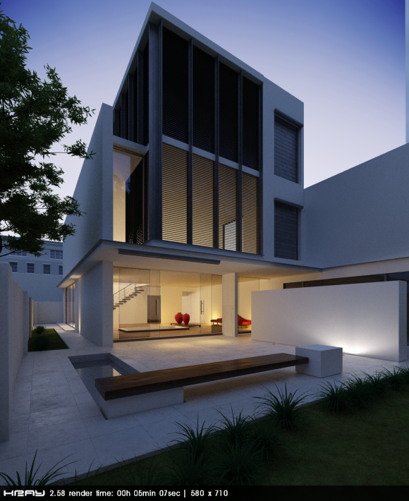

Actually this is just basic test of ArchExterior scene. I wanted just find way to bright up scene with LW lights and to know in which direction go with K3.
Scene in V-ray is render in QMC mode , same in Kray. Time is similar, maybe in Kray is has cleaner render because higher settings.
Actually is very easy setup exterior nights (I did not suspect that!) because it is similar to...Interiors settings. Problem is for full day how do bright up scene with Physky or HDRi - in this moment both are not good in Kray. Physky has old engine, HDRi is only simulated as normal HDRi map.
For HDRi will be in K3 special engine which detect source of strong lights and create for that special photons which gives Physical Light behaviour (similar to Area Light) so in render we will get stronger shadows. This new HDRi system slowly appear in other software also.

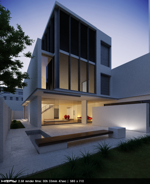

Here low settings:
Here PM mode:
Path Tracing:
...so we see now: QMC is quite faster then normal FG mode in some situations.

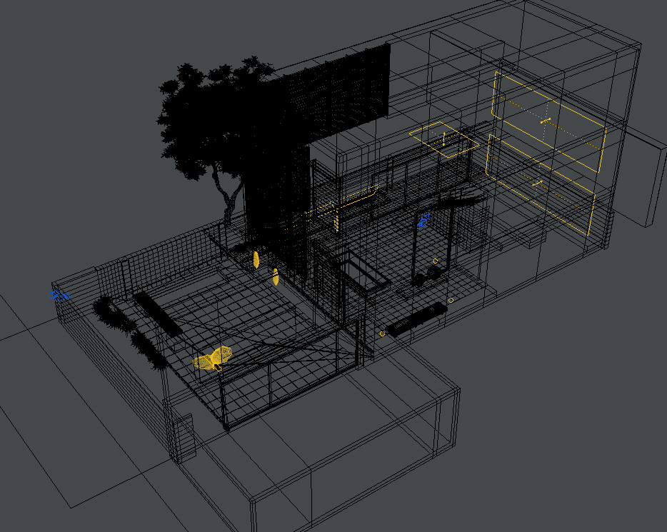

Here lights (almost the same position and system like in V-ray):
Optimized version (recurse limits on windows glass: 2 recurse)+soft LWF (gamma 1.2):

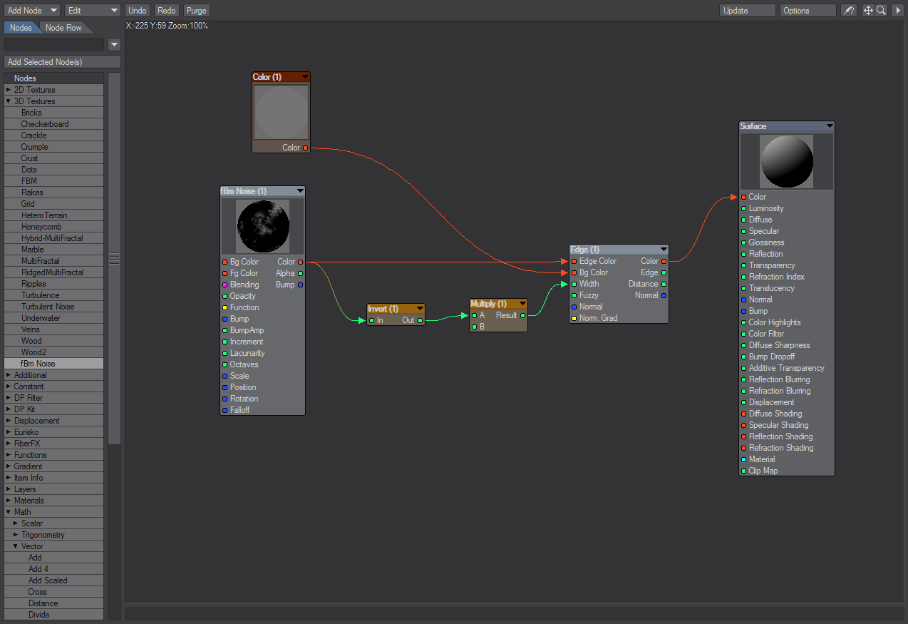

graflukas wrote:Yep, but I was talking about SSS in vegatation, dirty materials and all this organic,
corroded elements and erosion.
For leafs nobody use SSS.Normally is just Double Translucency system or in V-ray case Special shader which gives something between translucency and real SSS in reasonable time render.
Dirt material is really nice and in LW you can simulate this by ee_grit Node which I use non stop for everything (of course in special combination). This is no OCC node! So is very fast - almost no differences in render. Here example on the walls and windows frames:
This is not that perfect as V-ray dirt shader with many options but I think with some invention in Nodes you can achieve similar results.
Here link:
http://undo.fi/gritnode/

btw
Thanks for the dirt shader subject!
here is working under Kray, Edge Node:
I think by this Node we can do exactly same affect like V-ray Dirt Shader :idea:

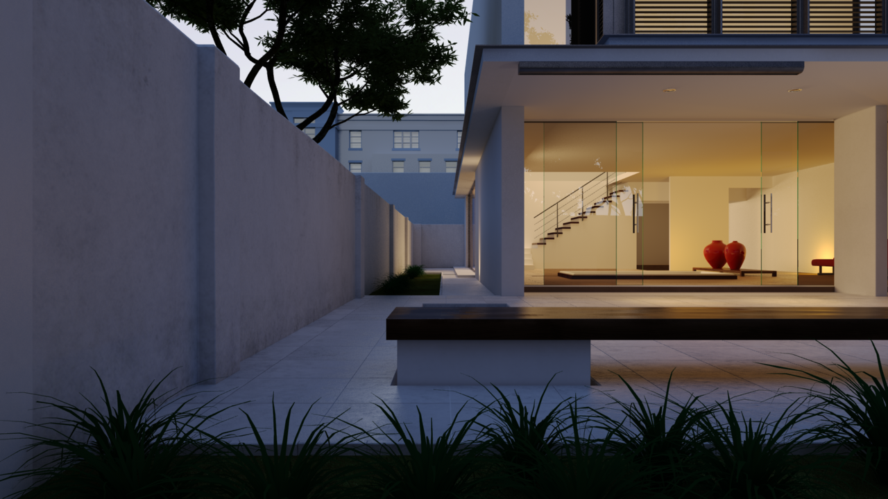

Here my animation test. Final Gathering with Bake GI every 30th frame, 5 min/frame
RAW frame
ext09.mp4
(2.39 MiB) Downloaded 476 times

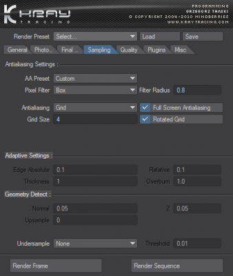

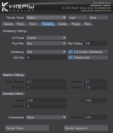

Nice, what are your AA settings please?
khan973 wrote:Nice, what are your AA settings please?
I noticed Grid 4 give almost the same effect like Grid 3. But the reason to use the G4 is that I want to prevent a bit, the ugly Moire effect in some situations (it`s really help)
It is a bit blurry filter but I noticed also in V-ray they put really high blur to smooth edges (why you notice very good AA in renders but whole image has blurry feeling)
Of course detection in V-ray is a bit better and also engine is faster...but well, I render this scene over two times faster then V-ray in QMC with very similar effect. I the end is no so bad in Kray :wink:
Bake GI is done by 30 frames step (total 5 frames full backed)...so it took around 15 min total with almost 500 MB GI file. The speed frame render can be of course increase by lower GI setting because my setting is for still image. For animation frames can be lower because is no so important contact shadow effect.
I will try render another cam from this scene.
