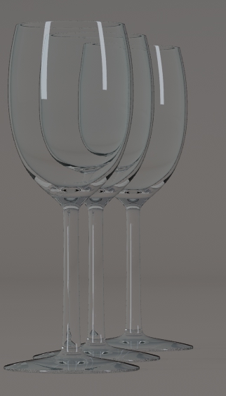

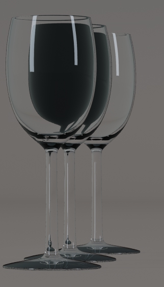

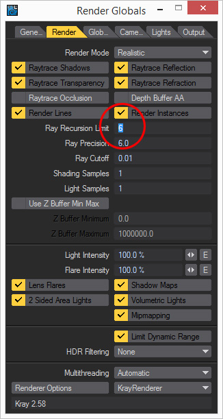

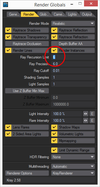

So, I was struggling against some light leaks and I wasn't able to find the problem: geometry, lights and materials were perfect... but eventually I found an unexpected solution!
I don't know if this is documented or not, I don't remember read anything about that, but here's what I found out:

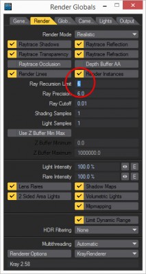

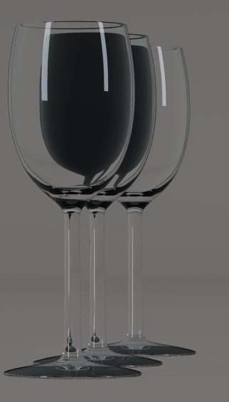

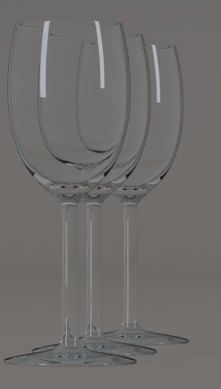

If you, like me, use both LW render engine and Kray, be sure to not use Ray Recursion Limit (under render globals) above 6. In LW you need 10 or 12 because dielectrics and transparency works better, but in Kray this can cause severe light leaks.

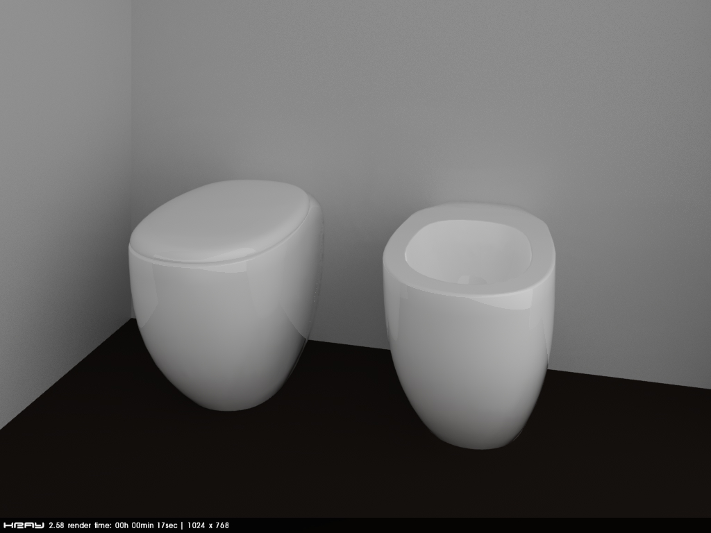

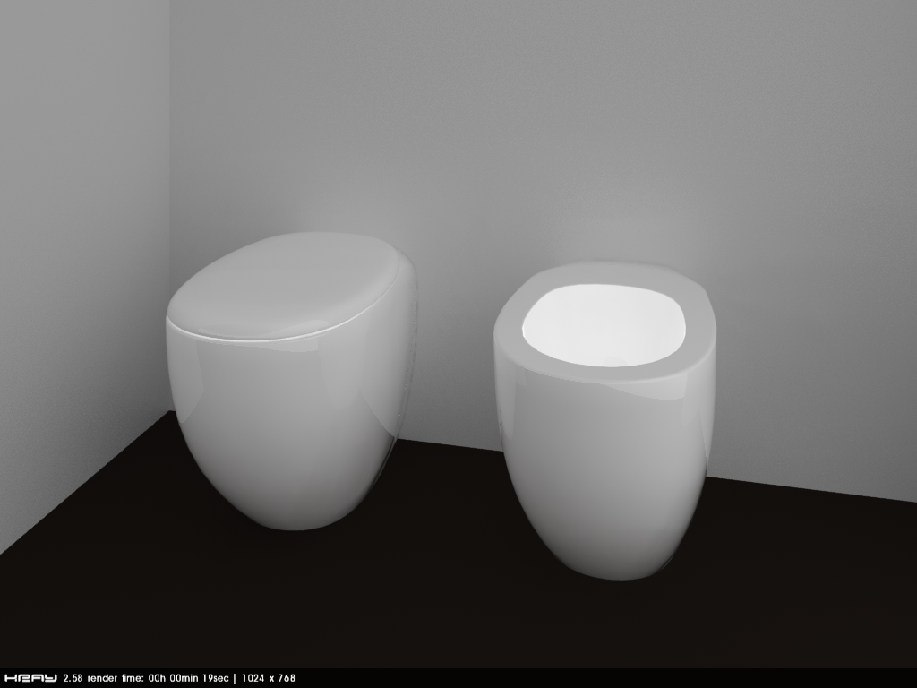

I don't know why this parameter can affects Kray, but as you can see from the images, the one with 16 Ray Recursion Limit looks like as there is a lamp inside the geometry :shock:
So, if you have some light leaks and you are using an old LW scene, better check this setting out!
The incriminated setting
Ray Recursion Limit 6
Ray Recursion Limit 16

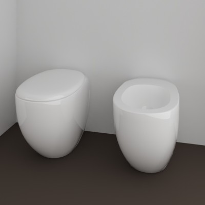

Ok Janusz, here's the scene, it's super basic, just a white backdrop and a light (disabled). Setting in Kray are basic too, but besides the Ray Recursion Limits >6 I can't find nothing wrong. It really strange, but you are the expert 8)

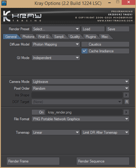

So here information:

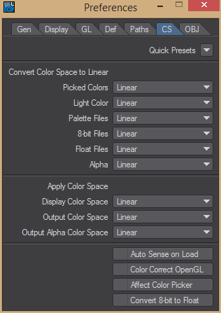

- you mixed tone mapping (forbidden :wink: ) When use blending in Kray, all tone maps from Lightwave and Kray MUST be LINEAR:
- do not use exposure in tone map, here the best (standard Reinhard blending):
- do not use (if possible) 3th part Nodes. In ceramic surface is Lightwave standard Fresnel Node - I added there. Some of 3th part Nodes has bugs or compatibility issues so better is avoid them. I use only LW Nodes: no problems at all, no problems in network rendering,just smooth and fast :)
- in Kray you have command
Code: Select all
recurse 14
so now is doesn`t matter what is in Lightwave. Do not worry about recurse problems. This error came from wrong setup of tone mapping - in scene you have correct one.
I do not know about LW native render why there are some problems.

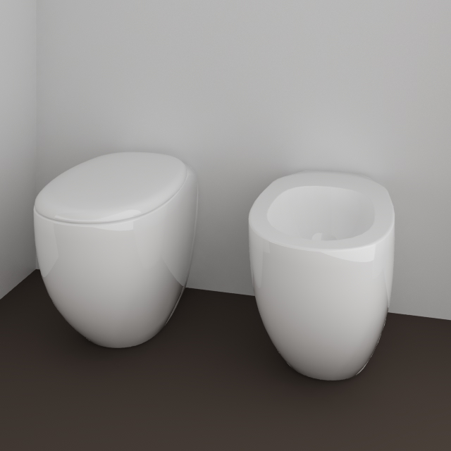

Here correct render:

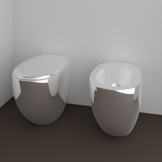

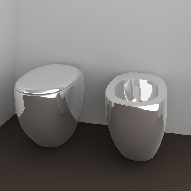

In ceramic Node you have recurse limit up to 2.0. it means reflection calculate is twice: "mirror inside mirror" and if you will setup 1.0 still will be good effect because surface has low level reflection and this second reflection is very weak. You can use pure metal to see differences:
Personally I use recurse 3.0 always. But for glass you can use a bit more, 5-6 or more. Of course more recurse - more longer time render. This recurse Node control can increase speed render drastically. For example bathroom scene with many tiles on the wall in normal situation will render quite long but with recurse 1 (is enough for low reflection surfaces) - very fast.

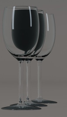

Re: LW Ray Recursion Limit and how does affect Kray

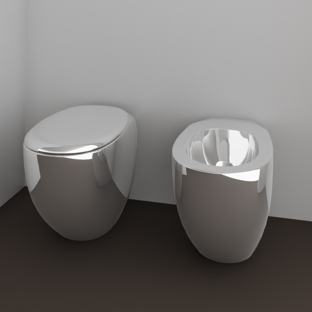

btw one more test:
glass which have only recurse 2.0 (sic!) in Node, but in Kray or LW you have recurse 6.0:
and correct setting where general recurse is 14 in command line (this what I suggest) but Node stil have recurse 2.0:
So recurse from Nodes are calculate separately only for reflection but transparency is general matter. Why Nodes are powerful :wink:

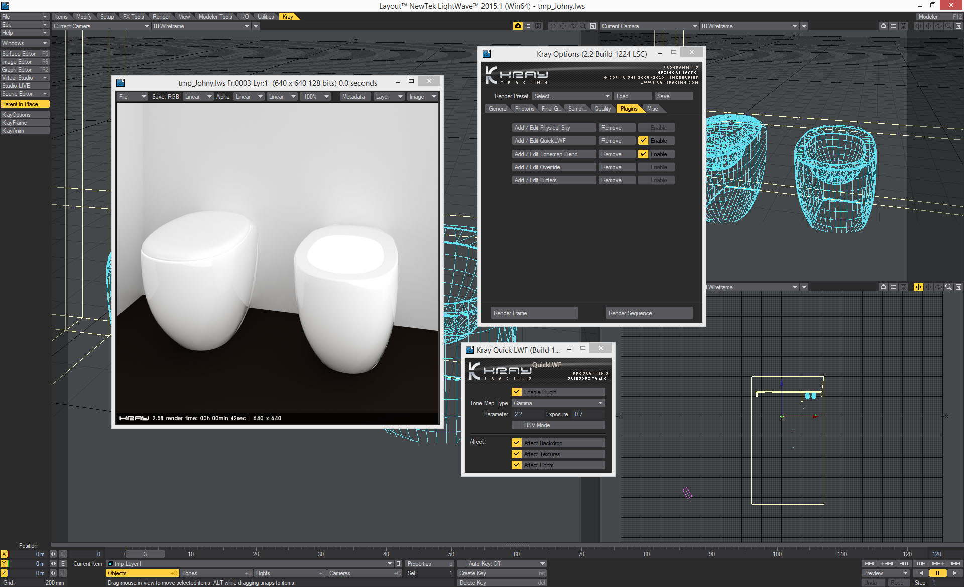

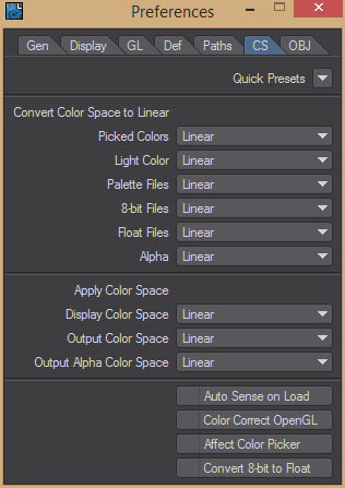

Ok, I checked everything on my scene and I didn't seen the Tonemap->Gamma under General, probably because I never change that settings, I know that should be linear. I think that I forgot to reset to linear, probably a distraction.
Anyway I checked your scene and I think I found the problem, the light leaks appears - even with your settings - when I enable the QLWF plugin and I use 0.7: is that a setting that I should not use?
Here a picture:
EDIT: btw, good tips about materials, as always!
Do not change exposure in tone mapping. It should be 1.0. Also do not use LWF, is just difficult to deal with this.
S0nny
Posts: 75
Post by S0nny »
Ok, QLWF disabled, it was it. Sometimes it helps me to keep color accurate, but I think I can find another tonemap or cc in post.
