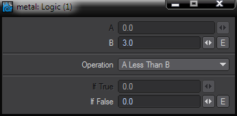

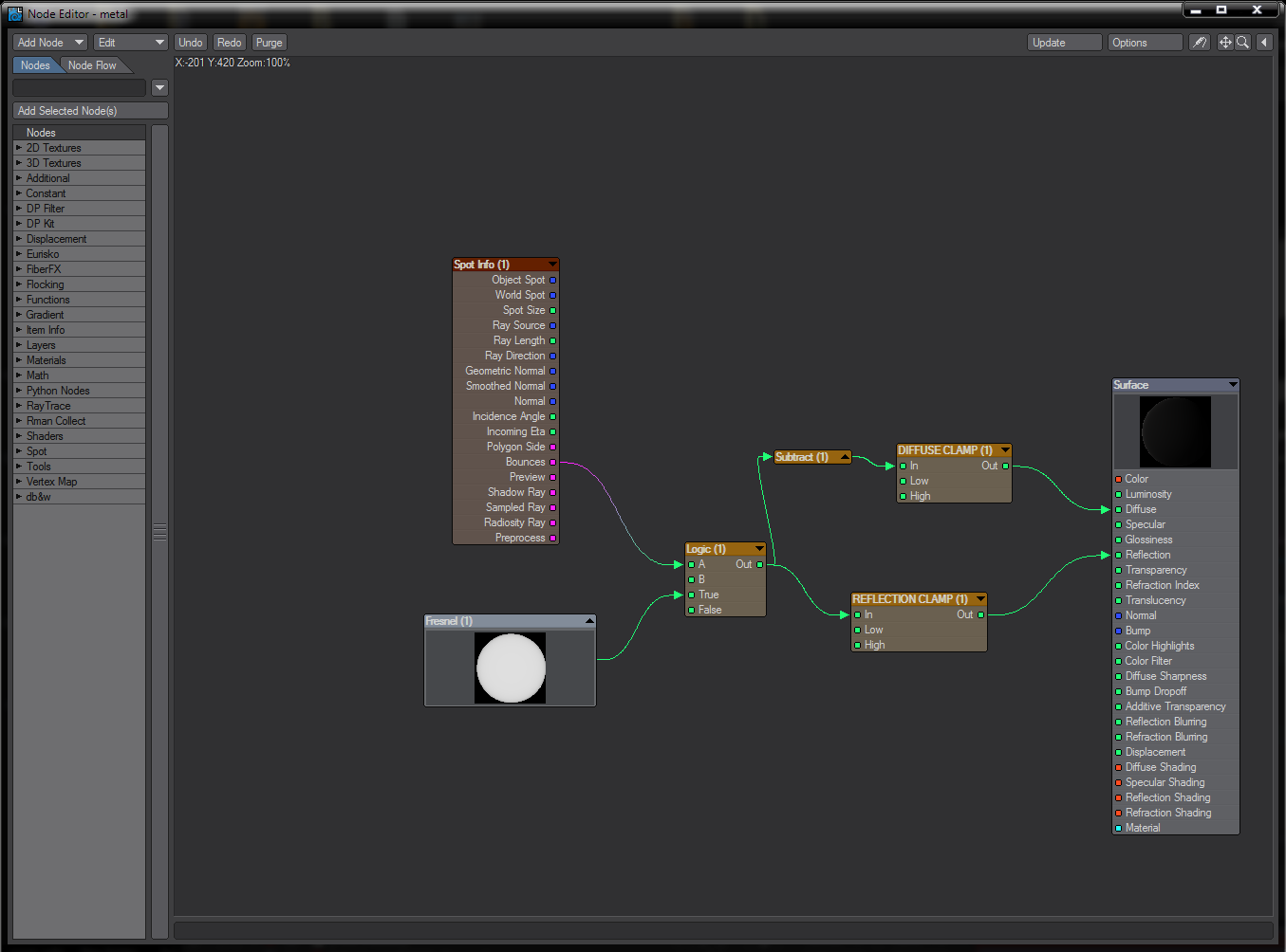

Ok I suspected huge amount of recurse in scene and render just lost with calculation for that. It happen sometimes when you not limit recurse. I would like to see image. Also I can help you with limits for recurse: put this in all Nodes (It is all ready in Eclipse package)
So in Logic you have limitation for recurse - in this case for reflection. I use this limiter non stop. It increase speed rapidly in scenes with many reflection surfaces. So I do not allow render engine calculate reflection in reflection over three times because over 2 times you will not see different. For wooden floor for example I use ONLY ONE or maximum TWO!
Generally it can be situation when render engine "stuck" with calculation of reflection - it can be place when many high reflected surfaces are enough close each with not comfortable angle to camera. This is normal situation and I avoid it by this Logic function.
Eclipse_metal.srf
(46.31 KiB) Downloaded 939 times
Add this for high reflected surfaces (metal) and tell me it helped or not.
Also problem can be completely somewhere else :wink:

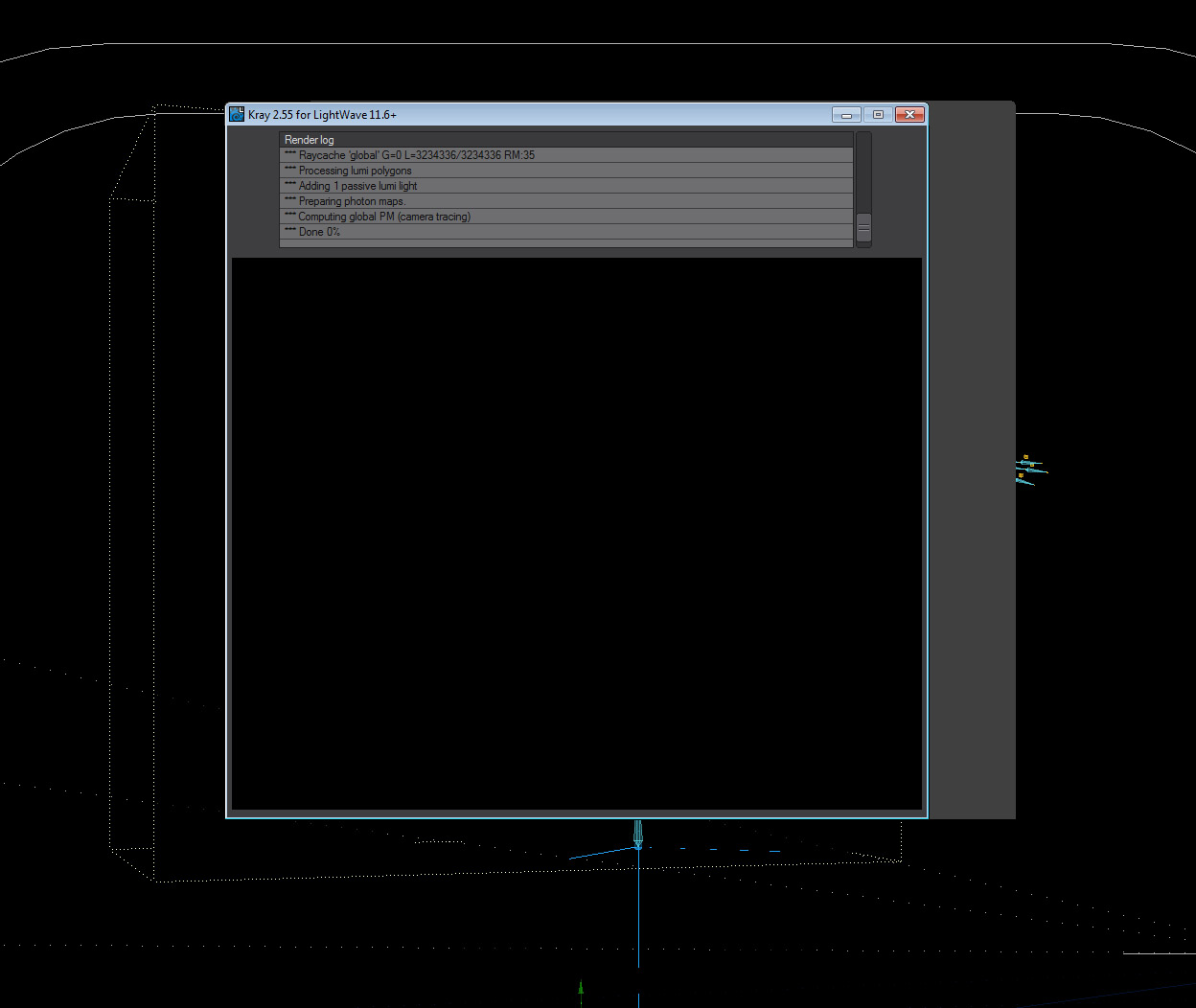

This is the point that takes alot to calculate after the first render.

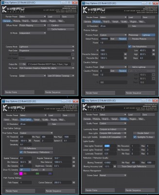

btw in Path Passes Corner Distance 200% is far too big. With that value you generate Path Tracing photons everywhere so time render will be longer. I think maximum should be 50-75%
Thanks for the tip, I am often leaning to overkill. I will try your settings.

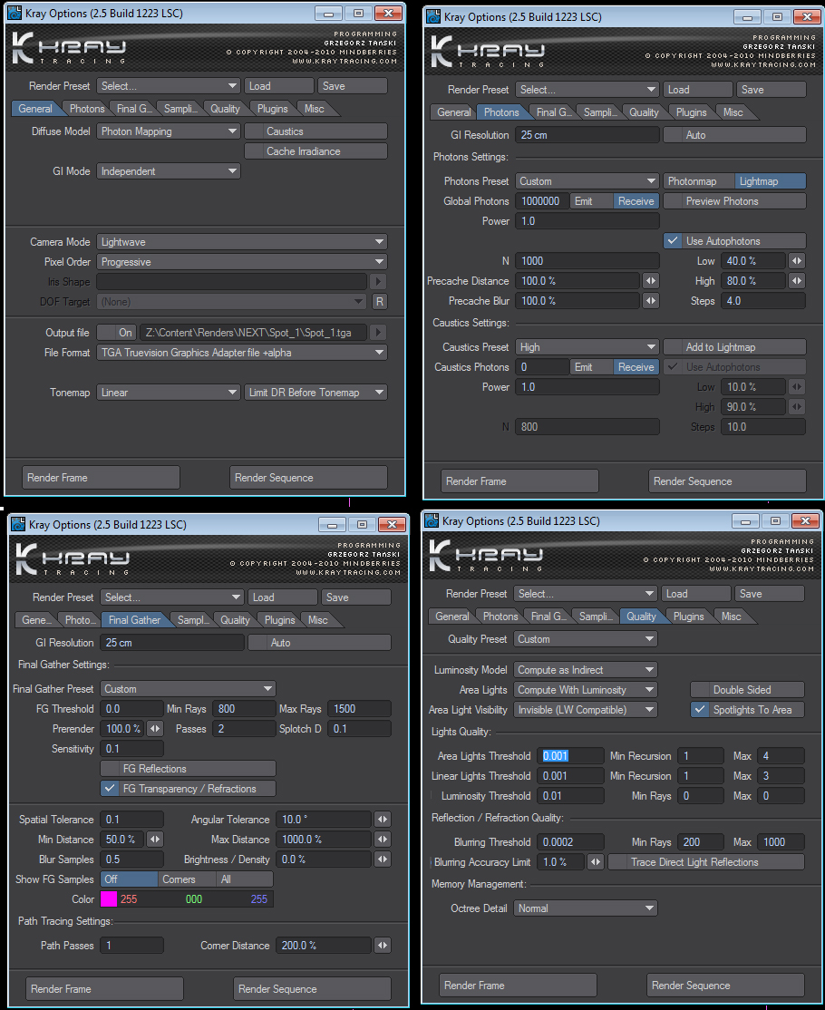

Re: Problem after first render
here you have good setting.
