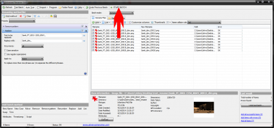

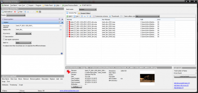

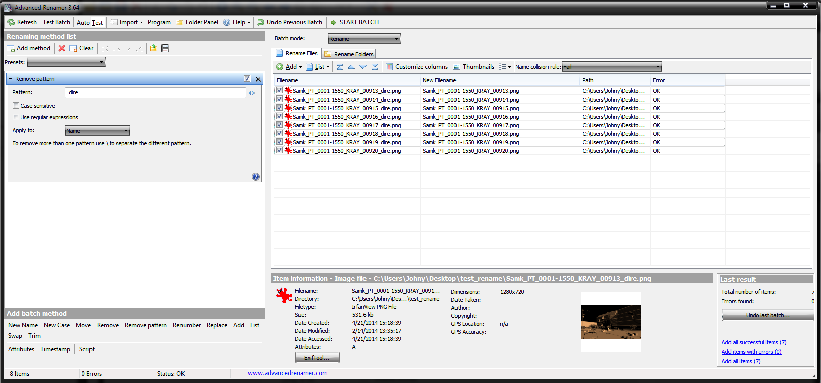

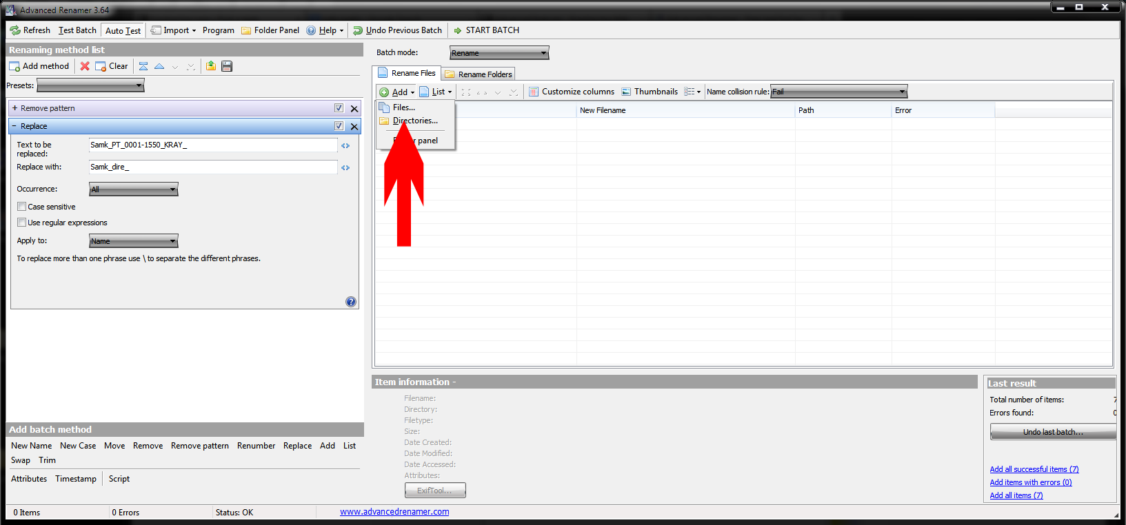

Btw , will tell Grzegorz about adding small extension in K3 which will allow user to change prefix and suffix . Also I am not sure about special command in Kray for that - perhaps something exist - will send to G. question how change extension from command line because this solution under is after render phase (will be much better receive directly correct names)

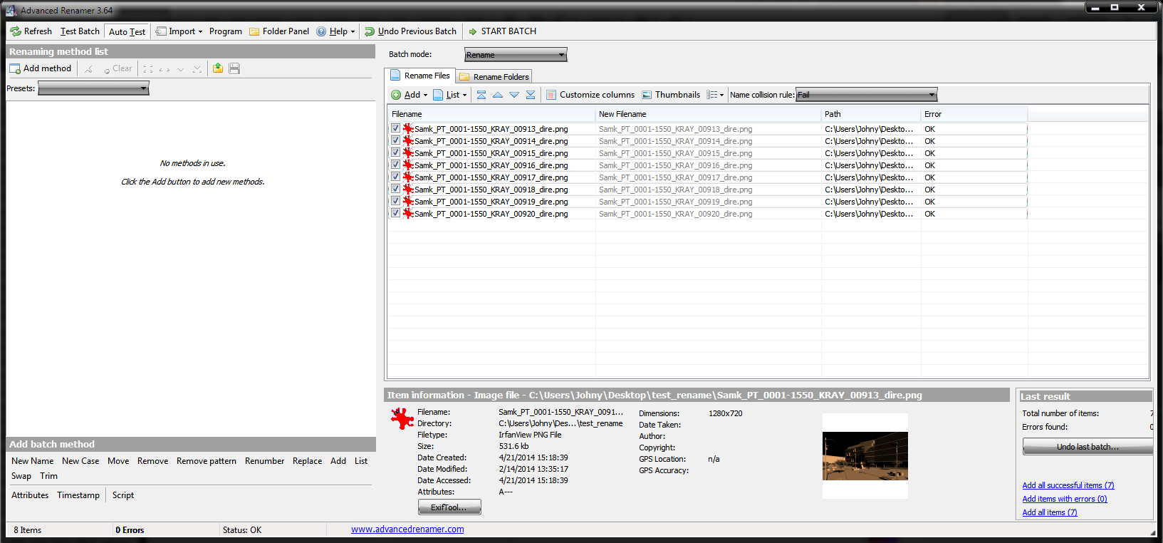

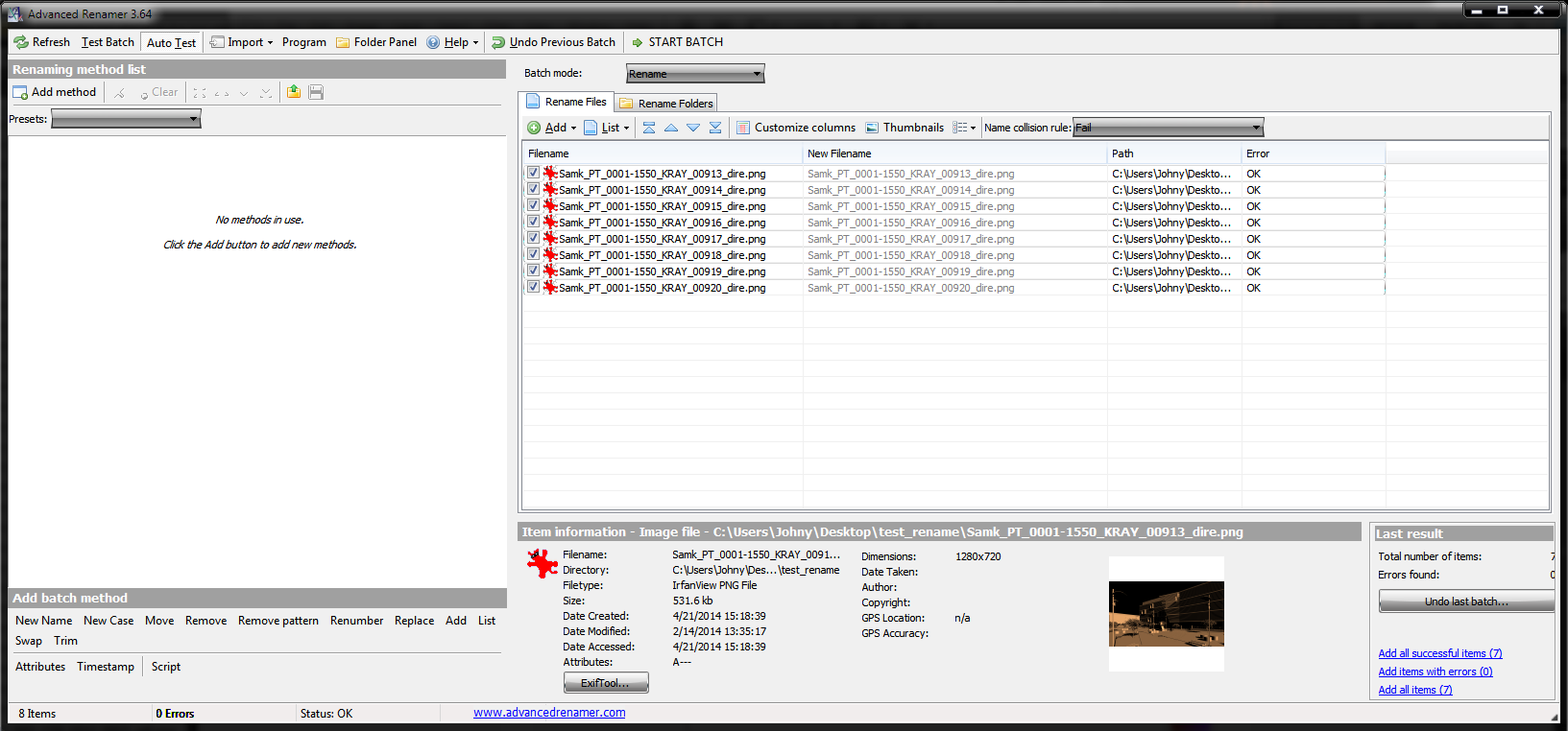

1. Download free software: http://www.advancedrenamer.com/
2. Choose DIRECTORIES to scan folder with file which we want rename
FILENAME and NEW FILENAME is the same because we did not add yet method.
3. Choose two method:

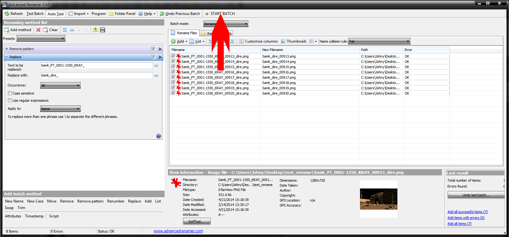

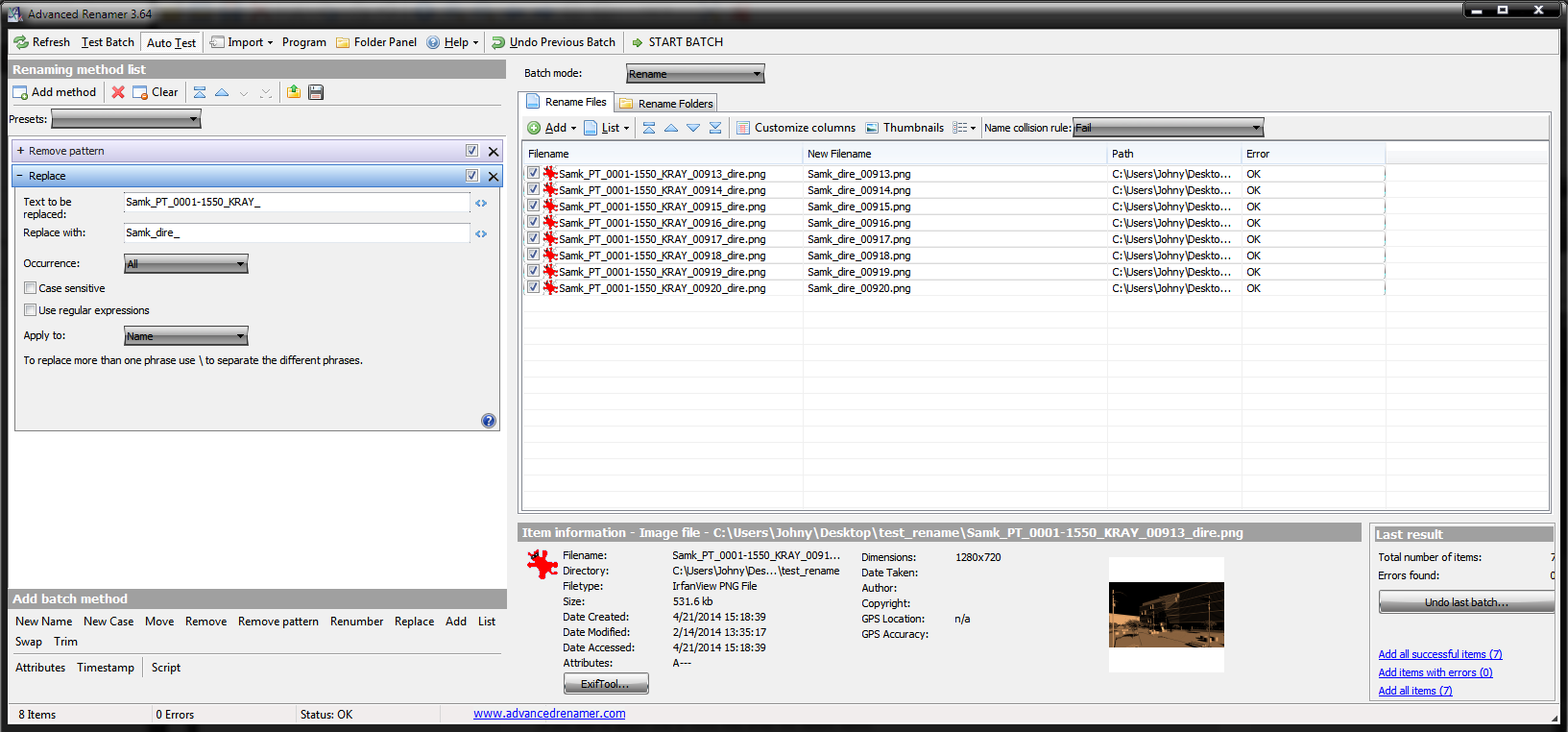

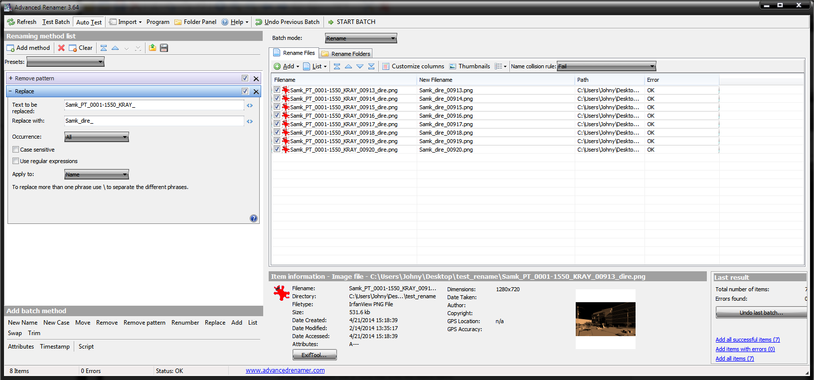

first REMOVE PATTERN
second REPLACE
one for delete extension (in this case we delete _dire )
second for change name (as you want)
The frame number counter is not changing - you can see from NEW FILENAME window.

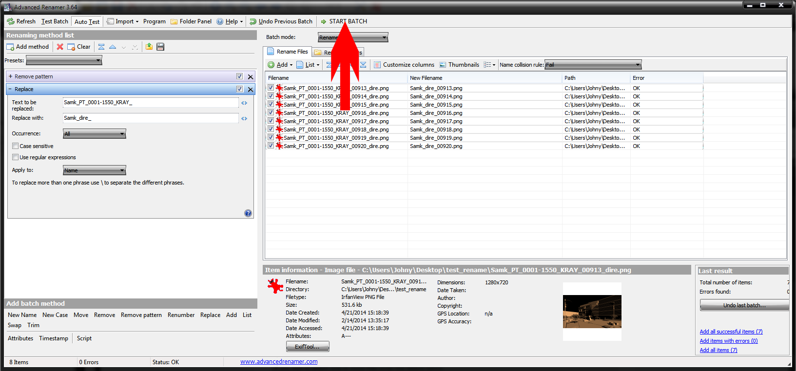

4. Press START BATCH
You will have confirmation how many files and methods was chosen to be sure.
Be sure you have copy of frames before action (just in case :wink: )

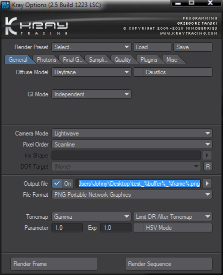

There is built-in solution for your problem
You can use whatever naming you want by using the following variables in your filename:
%frame% Current frame.
%buffer% Buffer name (if rendering buffers other then RGB, see needbuffers).
Default format is %frame%_%buffer%.
In your case all you need to do is to change it to:
name_%buffer%_%frame%.hdr
You can use several other variables in your filename. They are listed there: http://www.kraytracing.com/wiki/Advance ... _info_text
Re: File naming when Buffers are used
Thx Jure!

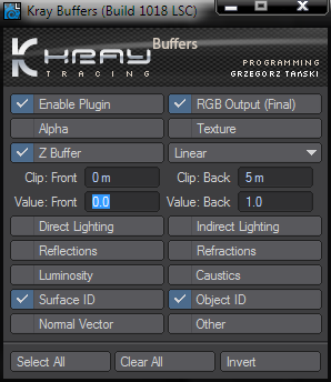

To complete information where, what and how:
In Kray output setting, example:
Code: Select all
will give us:
Code: Select all
But if we select buffers in Kray:
will give us:
Code: Select all
