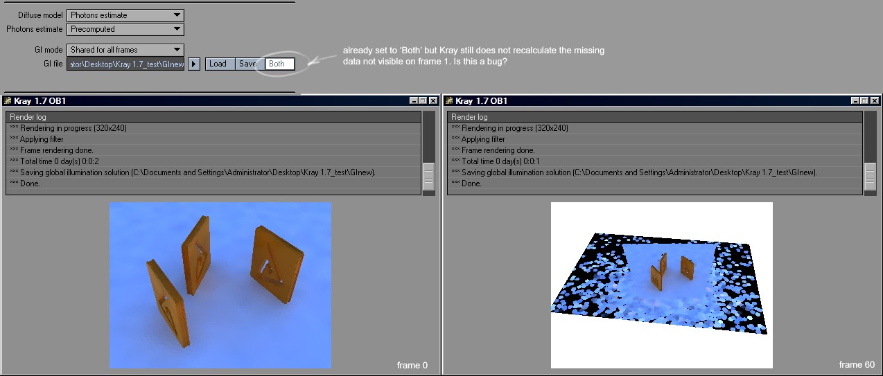

How does shared GI Both mode suppose to work? I've did some simple test, but it seems that even with 'Both', Kray does not calculate the missing GI data not visible in previous frame, is this a bug?
- 'Both' mode doesn't seems to work
- Kray_BothMode.jpg (118.26 KiB) Viewed 5878 times
You use "precomputed" that only will show you the photonmap/celldistribution.
Since kray wount fire anymore photons than those found in first frame nothing can be updated. If you switch to "Photonmapping" instead and activate "Both" Kray will keep on fireing more and more FG rays to fill out the gaps in that porly irradiancemap. Raise the numbers of photons so you have a nice distribution over the whole object and then kray wount need to fire as much FG to fill in the gaps.
In "Photonmapping" and "Both" activated, will Kray be firing more photons or just FG? But how do I have good photon distribution over entire object (even those non in frame) with "Lightmap" mode?Silverlw wrote: If you switch to "Photonmapping" instead and activate "Both" Kray will keep on fireing more and more FG rays to fill out the gaps in that porly irradiancemap. Raise the numbers of photons so you have a nice distribution over the whole object and then kray wount need to fire as much FG to fill in the gaps.
ok so you use lightmaps. Set up ypur animation in lw's rendermenue so it all frameparameters are correct . for example framestep1 startframe 1 endframe 500. Clear you cached file from hd totally! take it away. Now press render sequence. If all goes well you should see lw stepping from frame 1 to 500 before it starts to render all. This is since kray will then fire all photons needed for the whole animation before actuall rendering starts. After that initial procedure kray will render with the already saved photons and update it's FG accordingly.
This technique is only needed for kray when you use lmaps since lmaps are traced via the camera (what it see's). Therefore there wount be any photons at all if you would switch camera view. With photonmapping it works different since photons are traced from the lightsources and shoot everywhere from the beginning.

Great! Thanks a lot for the explaination, it works as you said.
