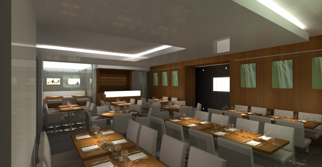

I made a test with an old file I do a long time ago. I just wanted to see if I can render tubes lights that are on the ceiling.
Anybody have a great tip ?

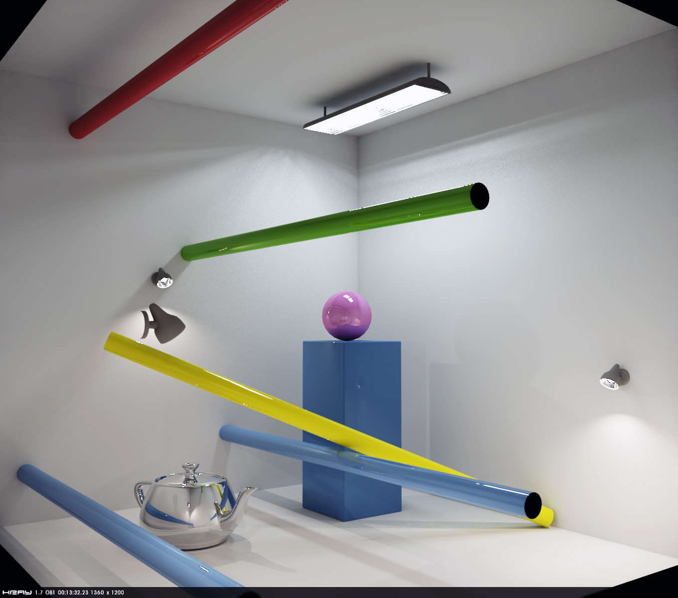

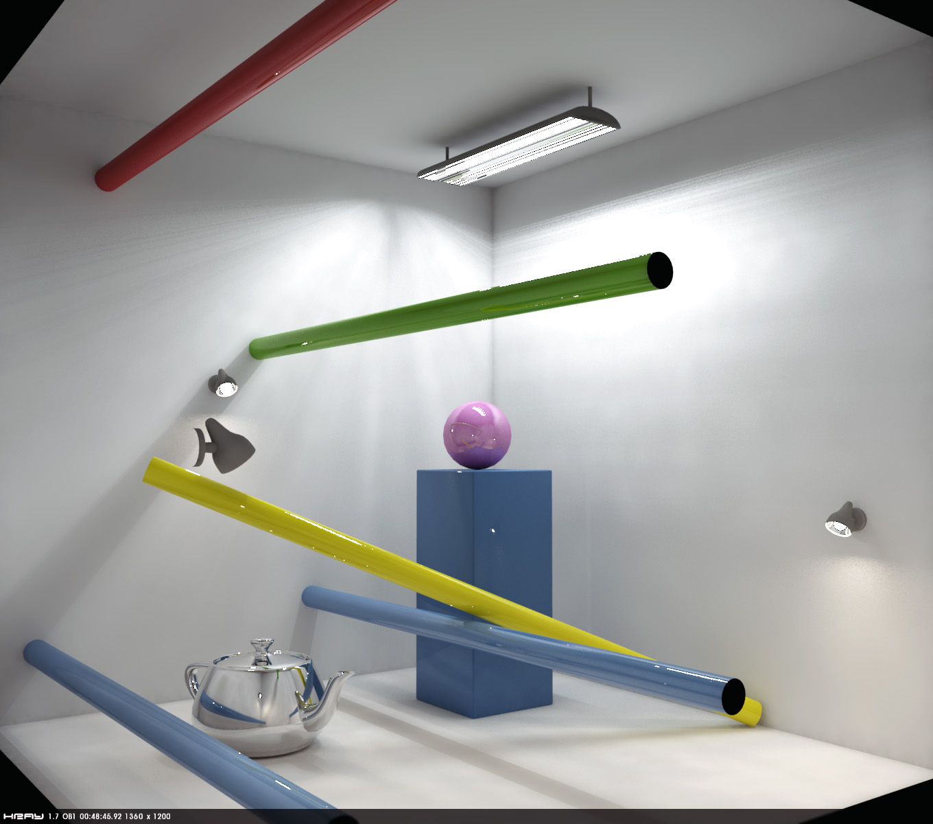

Im bound to agree with jure after some tests. This example is photonmapping + caysics and "auto" mode. Auto mean everything stronger than 100% luminosity will be rendered in direct mode ,the rest in indirect mode. Custom lights is possible with just polygons but if we use only polygons like i did in this example we start to enter into Maxwell domain rendertimes ;)
and i also did one with arealights only.
