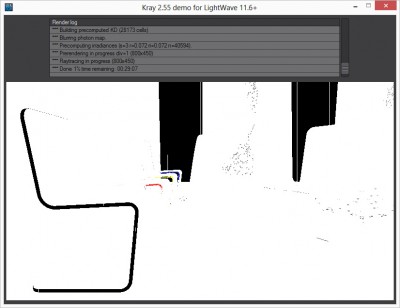

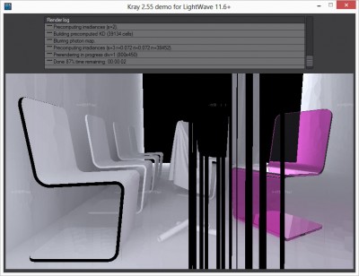

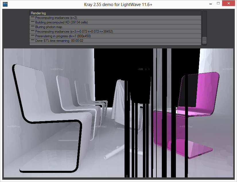

I guys, when I was experimenting with Kray demo the other day, I was having some problems that I couldn't figure out. Then I finally found the solution, here's what happens:

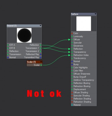

If you use DP fresnel node and connect transmission 1 or 2 to diffuse or transparency (that's the invert of reflection) the kray render goes crazy.

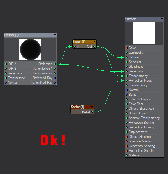

In attach you can see the rendering and the node setup. I simply solved using the invert node, but since lw engine doesn't have this problem it tooks long for me to solve this 'bug'.
Look also at the render time, same settings is like stuck, with the fixed node does render in seconds.
Maybe a bug: DP fresnel transmission (and solution)

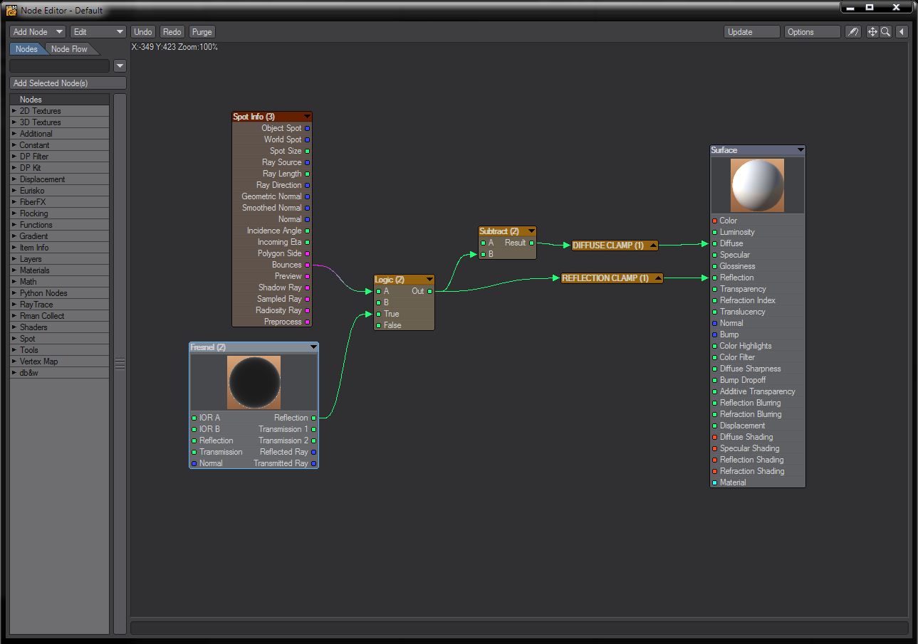

Do not waste time, here is solution for you:
- auto diffuse
- auto inverse
- special reflection limit
- Fresnel
- clamps to keep values in range 0-100% and protect artefacts
What you have to do is change colour and reflection value (Fresnel) according to your needs.
This "starter" for all surfaces. It should be in all surfaces.
Slowly I prepare my self to start special topic only for Nodes...but always I have to do something in home. But it get closer
Edit: Diffuse level is in Subtract and has value 100% (1.0) but this is reduced when Fresnel has value over 1.0 (no reflection).
This Subtract level has auto levelling and it should NOT be touch!
So if reflection in Fresnel is 1.0 (no reflection) surface has 100% diffuse.
If color is gray (128,128,128) and reflection 0% still Diffuse is 100% but Kray automatically calculate photons bounced from this surface (by luma information) and reduce diffuse to 50% from this color.
If color is black (0,0,0) and 0% reflection from Fresnel - diffuse from Node is 100% but Kray reduce power of photons to ZERO (photons doesn`t reflect from this color)
But you do not need it - important is Kray control diffuse when color is changed.
It is similar to Albedo system from Maxwell (of course not exactly - is just simulation - so need much less calculation but effect is almost the same in render: Looks good!)
