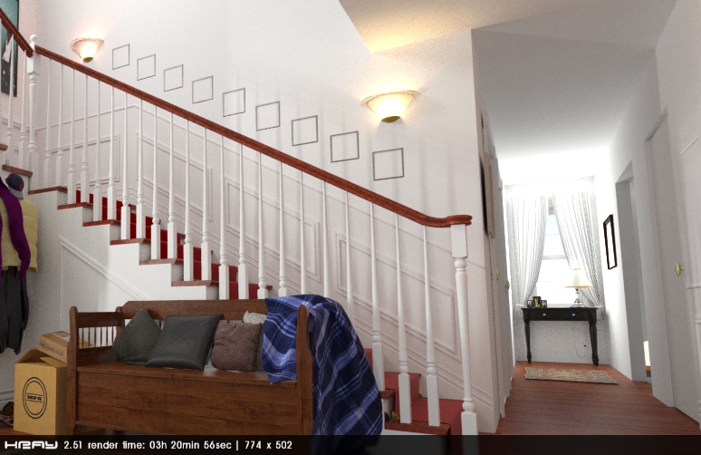

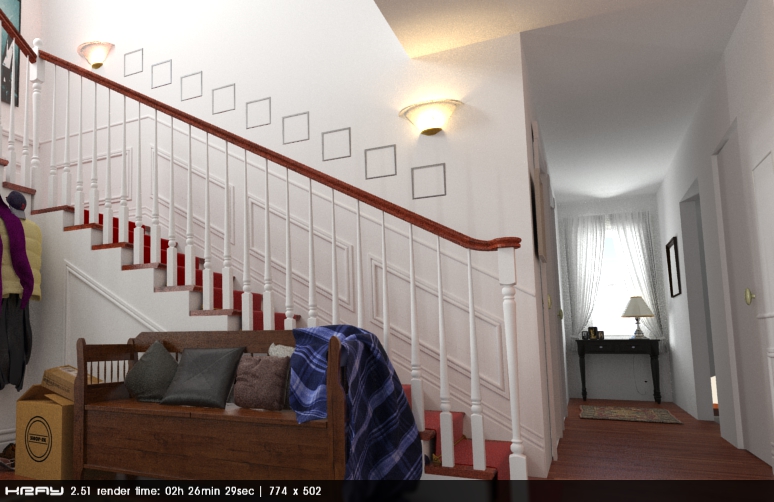

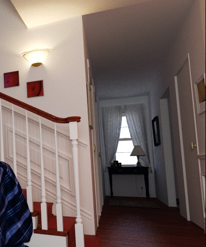

Hello all,
I'm currently trying to switch from FG renders to QMC. With the help of Janusz and some other Kray users, I manage to get some good result for studio renders.
But for Interiors, I can't get clean renders : images are always noisy even with what supposed to be high setups.
Now I really want to reach a new step in quality, and go from not bad to very good.
here is the full FG version and a part of the QMC one :

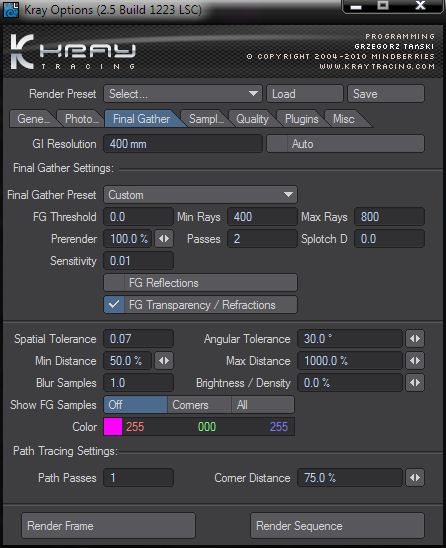

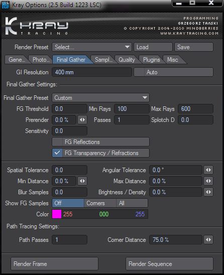

The noise should be almost clean with FG 100/800 (of course it`s small still but using Denoiser II in After Effect or standard denoiser in Photoshop you will clean up it)
Your noise comes from low reflection blur set-up.
Now You have to choices:
1. Increase quality of blur (for example min/max 500/2000) - bad choice
2. keeping blur quality around min/max 200/500
To keep low quality of blur and still get good effect you need keep light in small power especially Luminescence. Never put luminescence over 200-300%. Also same situation with Physky or another source of light from outside. Keep all sources of physical lights (Area, IES) also low - it will prevent noise also.

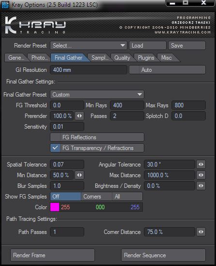

Setup for QMC - there is nothing to setup actually, only two thinks: FG min/max and Path Passes (important!)
Setup for Final Gathering.
Re: interior render, from FG to QMC
Thank you so much, Janusz.
If I keep a low level of light, well...It's getting dark of course. I've seen in a previous post that you mentioned that we have to add lights, which is a bit disturbing for me : do I have to dub existing lights, add ceiling lights, or what I call "camera" light in other words a light panel from behind ?
And for the windows : areas or lumi (I know it's been debated a hundred times here !) ?

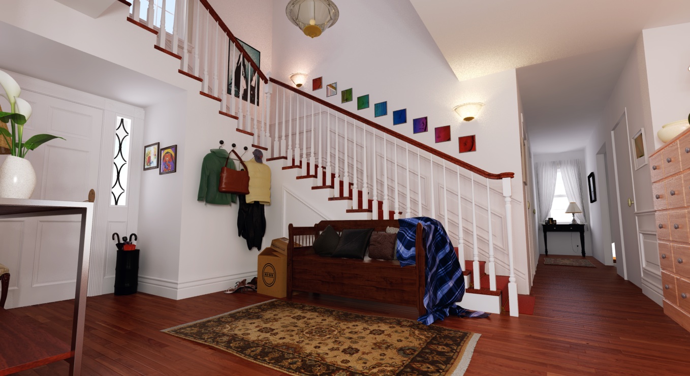

Hi,
This is where I am. I've applied most of the settings suggested by Janusz, except for Tonemapping, 1.6 , 5.0 gave me washed render.
Now I get a rather clean QMC render with 50% areas in windows, 5% areas on ceiling. I think I should reduce all that.
With Area light I had to set the falloff and choose inv2 with 5m, I don't know if it's good.
With QMC I get very good contact shadows, and avery natural overall lighting.
But I have to keep on pushing to get an excellent render, advices are welcome.

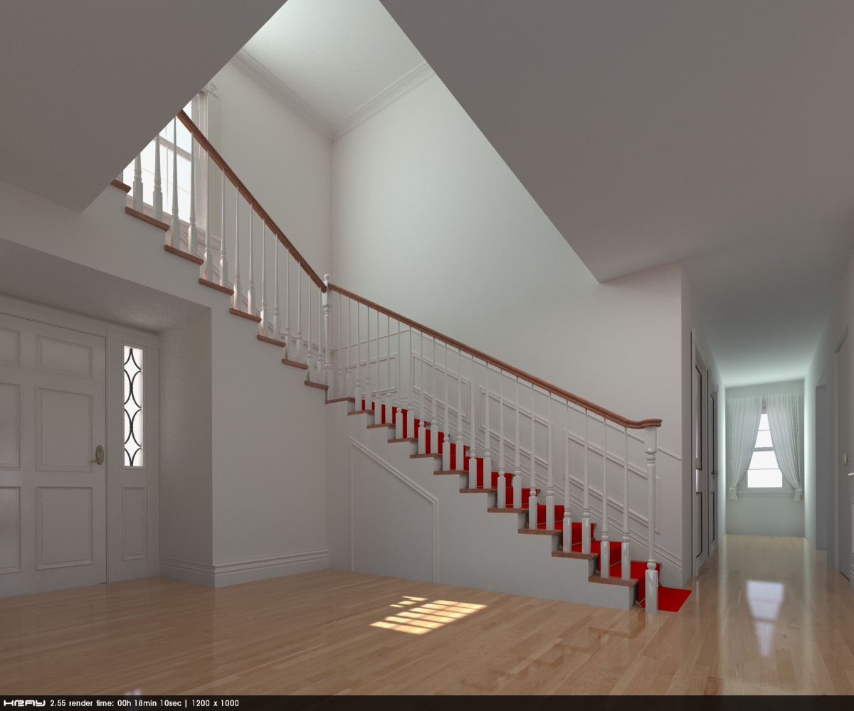

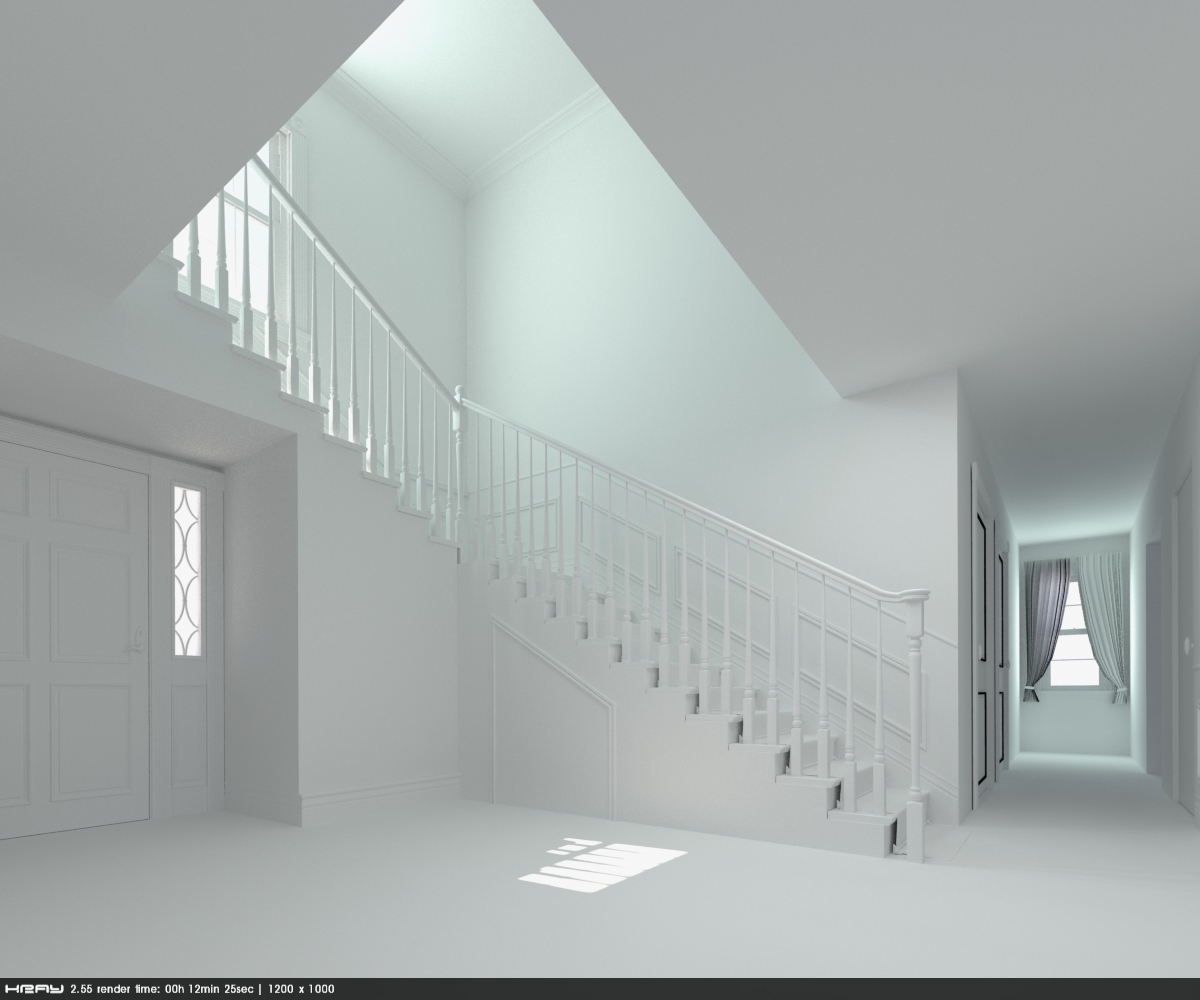

Here my fast test. Interior is pretty much difficult to render: there are very small windows and very few. For that scene must be small trick: Area Lights in windows must be bigger then windows holes.
Test in QMC mode.
						Test in QMC mode.

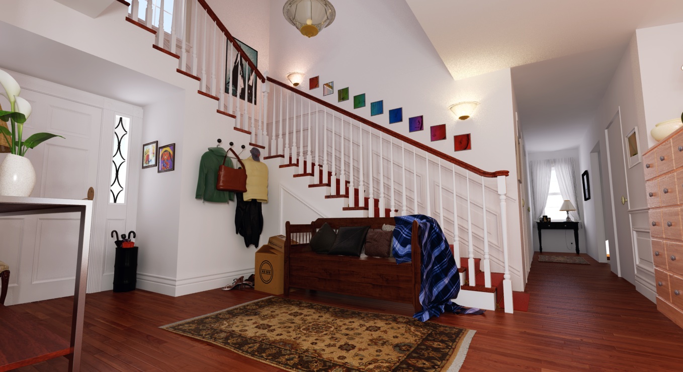

Here update
- Instead Area Lights I used LEM lights
- if you want ultra quality you must setup FG min/max over 2000/0...but time will be horrible ...is just QMC (not interpolated GI). Of course much faster then Path Tracing.
- for preview images you can setup FG 100/0 with no AA (example in file) This is enough to see scene and light
- when QMC is selected, FG tab has only one thing working there: FG min/max. rest options are disabled (you can change values but they do not work)
- more FG - better quality - longer time render. Example: FG 100/0 big noise and fast render, FG 500/0 acceptable noise slow render, FG 1000/0 very small noise - long render...etc.
- minimum AA Grid 3, but better Grid 4 or even 5. This helps reduce noise.
- because QMC is not interpolated method the Global Illumination always is perfect (very close to Path Tracing) but: GI samples in QMC method are calculated from Photon Map and if Photon Map is bad also GI calculated by QMC engine can be bad (light leaks). doesn`t exist Splotches effect in QMC method! Splotches errors comes from not enough samples in Final Gathering so in QMC always we have maximum GI samples (infinite) which are determinate by level of noise. This Light leak effect comes from bad wire, too strong LEM or Physical light, not supported Node. These bad things determinate quality level of photon map and even QMC (calculation comes after shooting photons) can not help.
In the end: QMC is something between Final gathering and Path Tracing.
QMC is around 2-4 times slower then Final gathering with almost the same quality.
QMC is around 5-10 faster then Path tracing
Final gathering is around 10-20 times faster then Path Tracing
Selected method strongly depends from hardware
...but is one hope: K3 has NEW and very accurate Photon Map engine and comparing to old one will it be revolutionary.
This is very important because having very accurate Photon Map solution we can render in Final Gathering with quality of QMC or even Path Tracing ...of course without noise.
